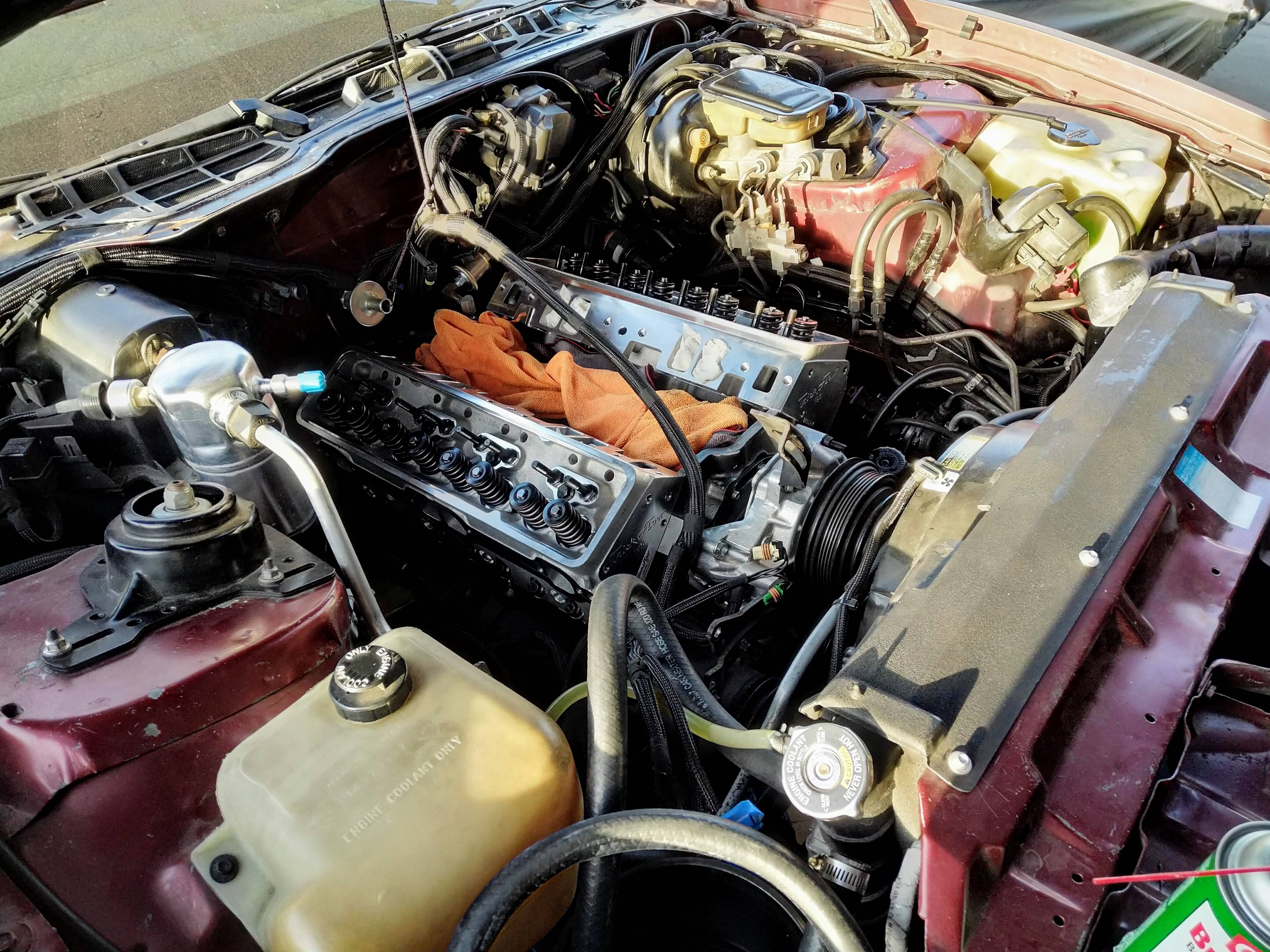

Got the new heads slapped in. Valvetrain went in after the pic when it got dark, so maybe it'll be running tomorrow.

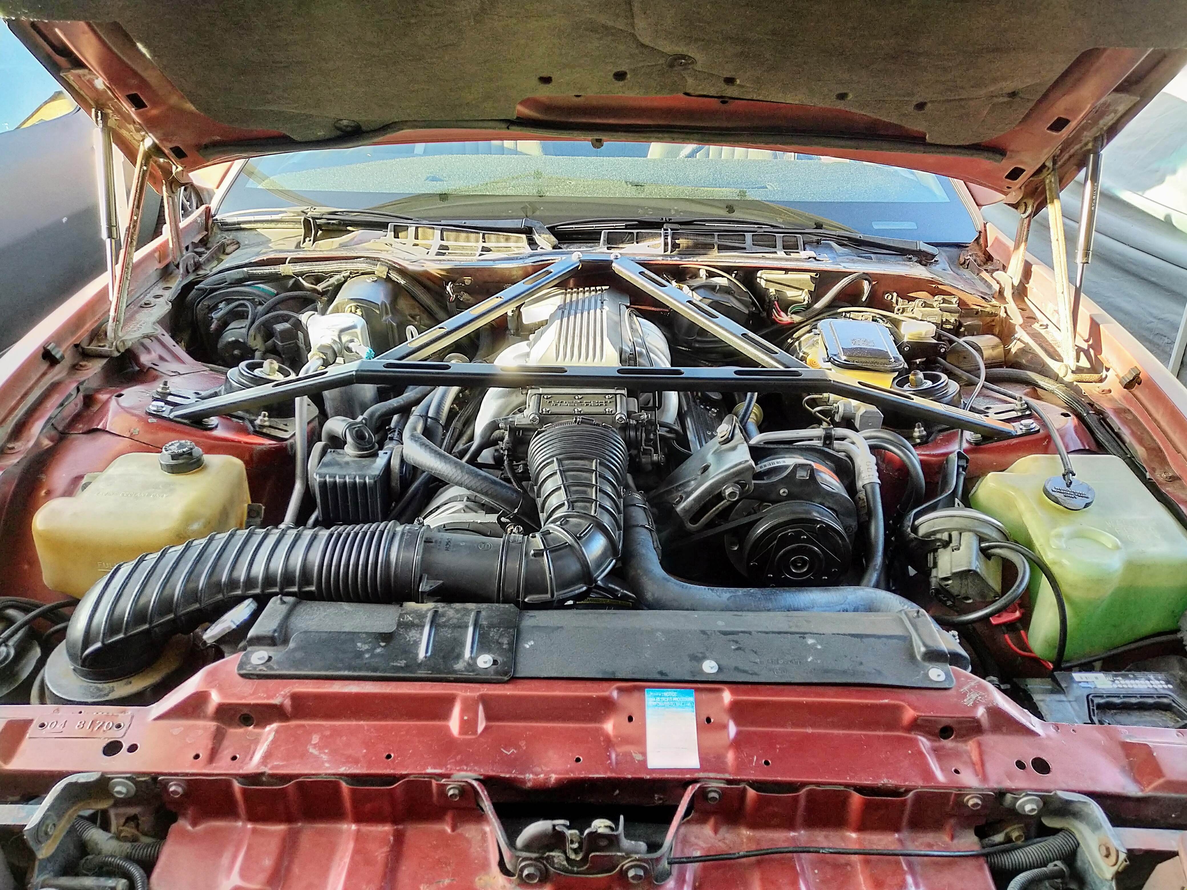

Back together! Right off the bat it idles more smooth and consistent than it ever did when I built it in April with the old EQ hybrid heads. Seems like the valve job was botched on both heads. I looked at them more closely and saw that all the exhaust valves were leaking to some degree and severely wore most, if not all, of the guides. Didn't bother looking at the intakes. The new Trick Flow 195s looked fantastic out of the box. Lesson learned, scrutinize the valve job even on brand new assembled heads.
Gotta loosen up the y-pipe tomorrow and fix a leak at the driver side collector and then I can drive it, too beat to do it today. Then the re-tuning begins... if it doesn't crap out again. One of these days I'll suck it up and go EBL Flash II or P4 or something.

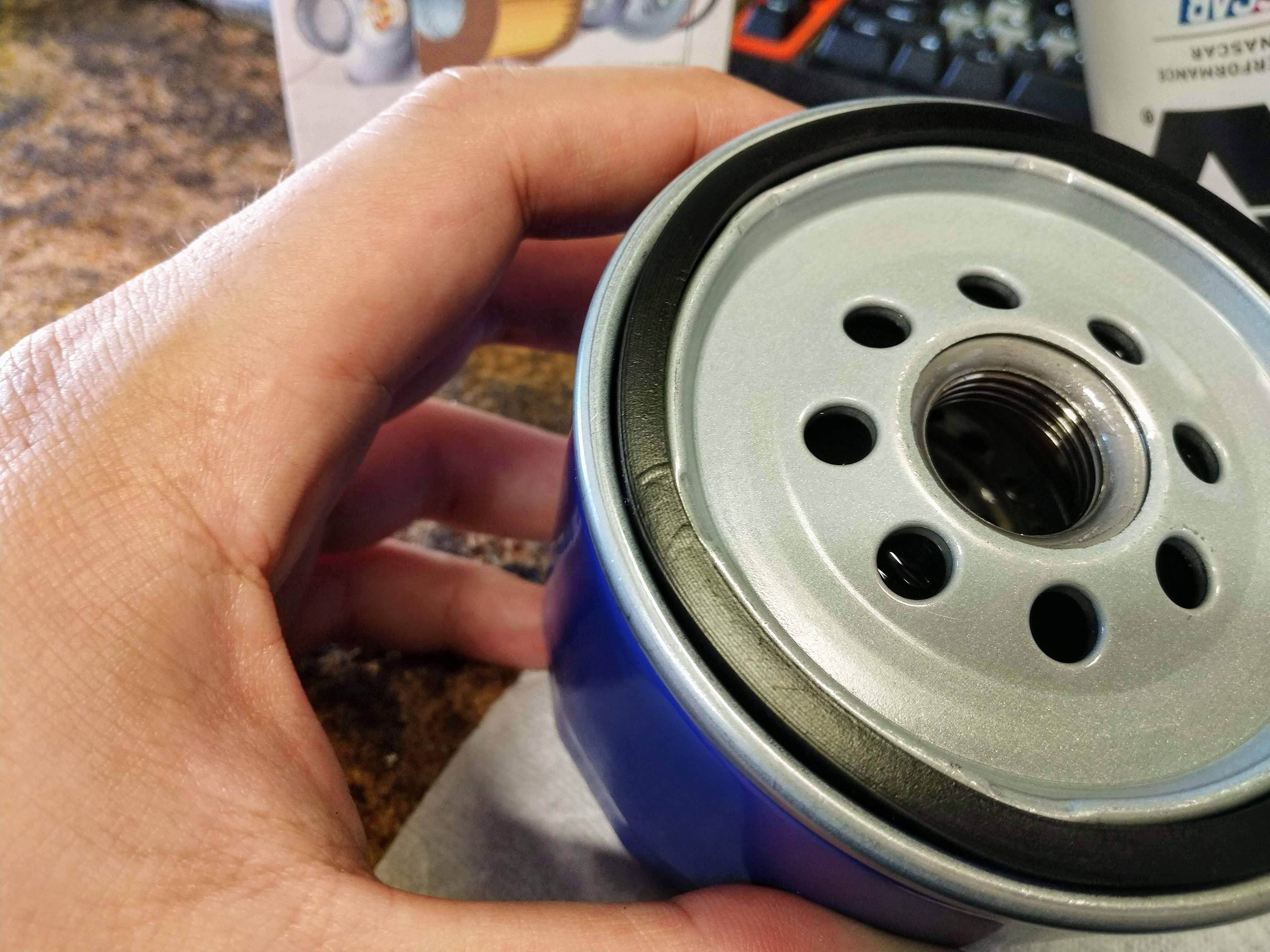

Swapped the oil filter out again because it still leaked. Trying a Fram HP this time and so far it's bone dry. We'll see after a few more days.
I compared a few of the filters: the used K&N that didn't leak, the leaking STP, the old leaking standard Fram, a new Fram HP, and a new Wix. The K&N and Fram HP both had thicker and taller gaskets and I noticed they both said to tighten 1-1/4 turn compared to 3/4 turn on all the other standard filters.
Next time I have the filter off, I may take a Dremel to the oil filter pad and feather the gouge out and I'm betting any filter will seal fine afterwards. Another lesson learned, inspect the oil filter pad on a new/used engine before you stab it in the car. You can see the imprint on the old oil filter that leaked:
Compared to the imprint on the K&N that didn't leak:
Couple more comparison pics if anyone is interested: https://imgur.com/a/6G0ZKjK

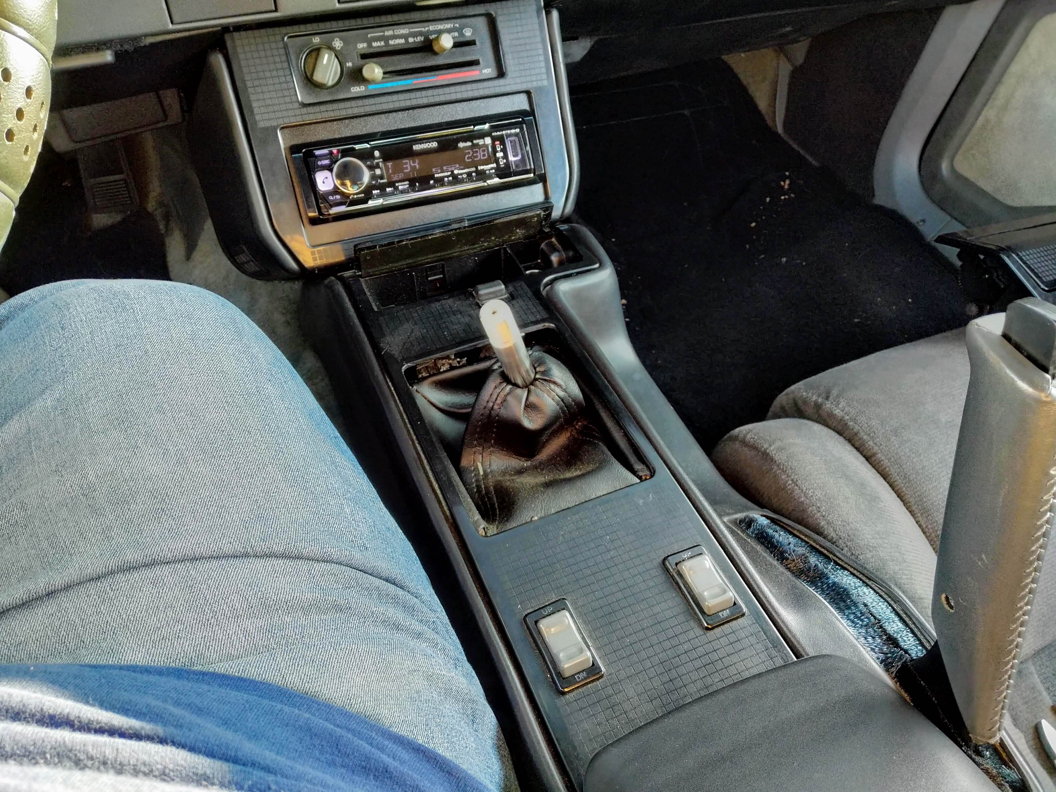

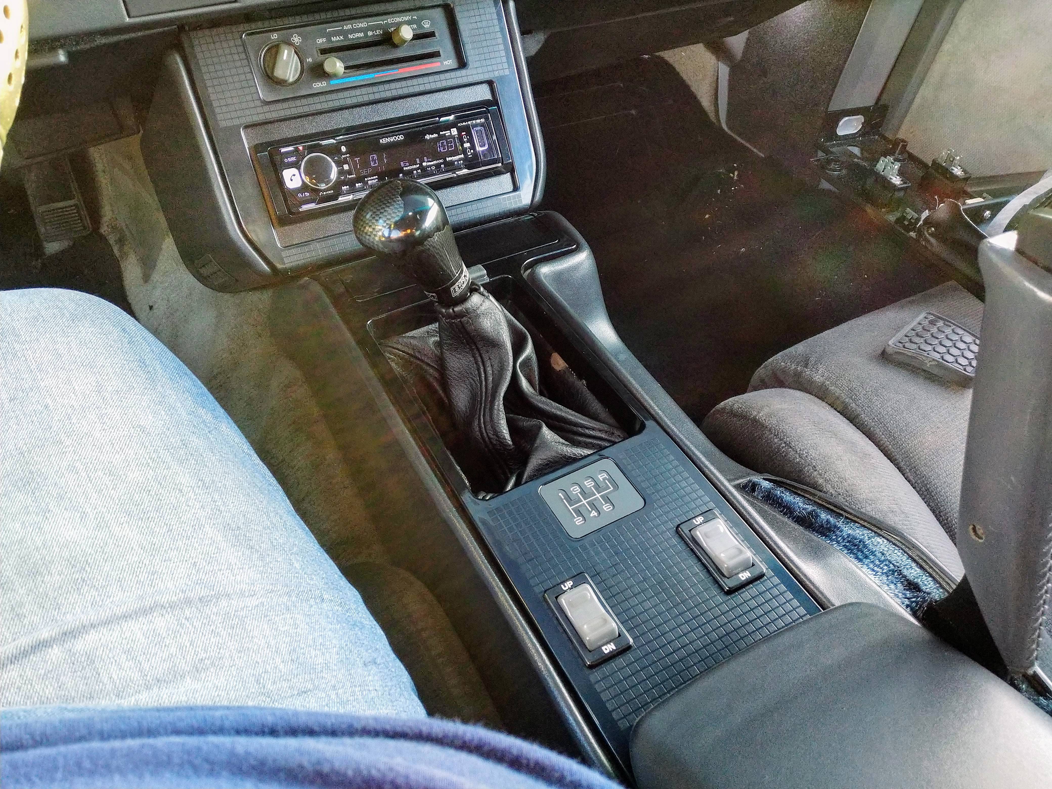

  #474
rburrow87's Avatar
Joined: Feb 2016
Posts: 154
Likes: 16
From: San Diego, CA
Car: 1975 Pontiac Firebird Formula 400
Engine: SBC 350 w/Pro-Flo 4
Transmission: M29 T56
Axle/Gears: Stock 10 bolt w/3.42 and new Auburn
Re: what did you do to your thirdgen today?
Received my Hawks reproduction shifter plate, new window switches, and 6 speed shift indicator. My old shifter plate was a modified automatic plate but I just couldn't get the glue for the boot frame to stay stuck, so I gave up on it. The new window switches are nice, it doesn't take so much force to get the windows to roll up and down anymore. Not crazy about this shift **** though.
Before
After

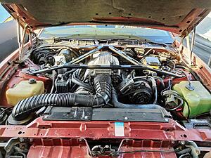

I received my Detroit Speed 3-point strut tower brace yesterday and completed the holy trinity of chassis bracing for these cars today (subframe connectors, wonder bar, and strut tower brace). It's a really tight fit on a Firebird, but it's also entirely possible mine is mangled and it's not a typical fit. Ended up having to notch the bar a bit to clear the TPI and notch one brace on the driver side of the hood. Starting to want a fiberglass hood now...
I don't think the engine is touching the bar, but I still have to drive it more and listen to be sure. Can't get it to sit any lower and I'm already using rubber engine/trans mounts. It's possible that the Spohn T56 crossmember drops the trans a bit more than it should which may cause the intake to be a little high. But the bar is awfully close to what I would think is the pivot point so it's hard to say if raising the trans will actually move the intake away from the brace.
So far it seems like the front end feels a bit stiffer. Little bumps feel like they go through the suspension instead of it primarily being the body flexing and absorbing it. Cruising on the freeway feels more confident as well. The little bit of steering slop is starting to become more apparent now, may need to tackle the steering linkage next. But I do really want some Koni yellows.
My cut looks a bit crooked, and it might be, but it's mainly the engine leaning. I changed the mounts earlier this year because the old new ones had a massive amount of lean due to them being mangled for no apparent reason.
Don't judge me
Couple more pics: https://imgur.com/a/aJTHLAD
Old Sep 25, 2018 | 09:03 PM
  #490
DynoDave43's Avatar
Posts: 4,845
Likes: 928
From: MICHIGAN
Axle/Gears: 10 Bolt 2.73 Open
So...the dents in the hood bracing...you did those to clear the brace, or the brace has done that from hitting there, or???
Old Sep 25, 2018 | 09:37 PM
  #491
rburrow87's Avatar
Joined: Feb 2016
Posts: 154
Likes: 16
From: San Diego, CA
The pic was from before I cleaned up the cuts from notching. I had to open the left side of the notch (when looking at the pic) to get it flatter because that edge was digging into the brace a bit even though the hood closed fine. I may have bent that firewall end of the notch when I was test fitting and pushing on the hood to try to figure out if it was touching or if there was clearance. I'm actually thinking about removing a little more of the section of the hood brace that runs towards the firewall because it runs fairly parallel to the strut tower brace.
Otherwise, this hood was pretty jacked up by the previous owner(s) if you're referring to other areas. I wouldn't have done it that way if the rest of the hood was nice. I don't know what they did to this poor car; sometimes I wonder if I should've got another shell. But it was $1000, complete, and nice enough for a worry free driver and for modifying without feeling bad about ruining something nice.
If my car was as nice as your car, I'd have just returned the brace and found something that fit a Trans Am better. Seems like most companies did the R&D with a Camaro which has more space between the hood and engine from what I gather. Not sure why it ended up so close to the engine though. There was maybe enough room to slip a sheet of paper in there before I notched the strut tower brace.
