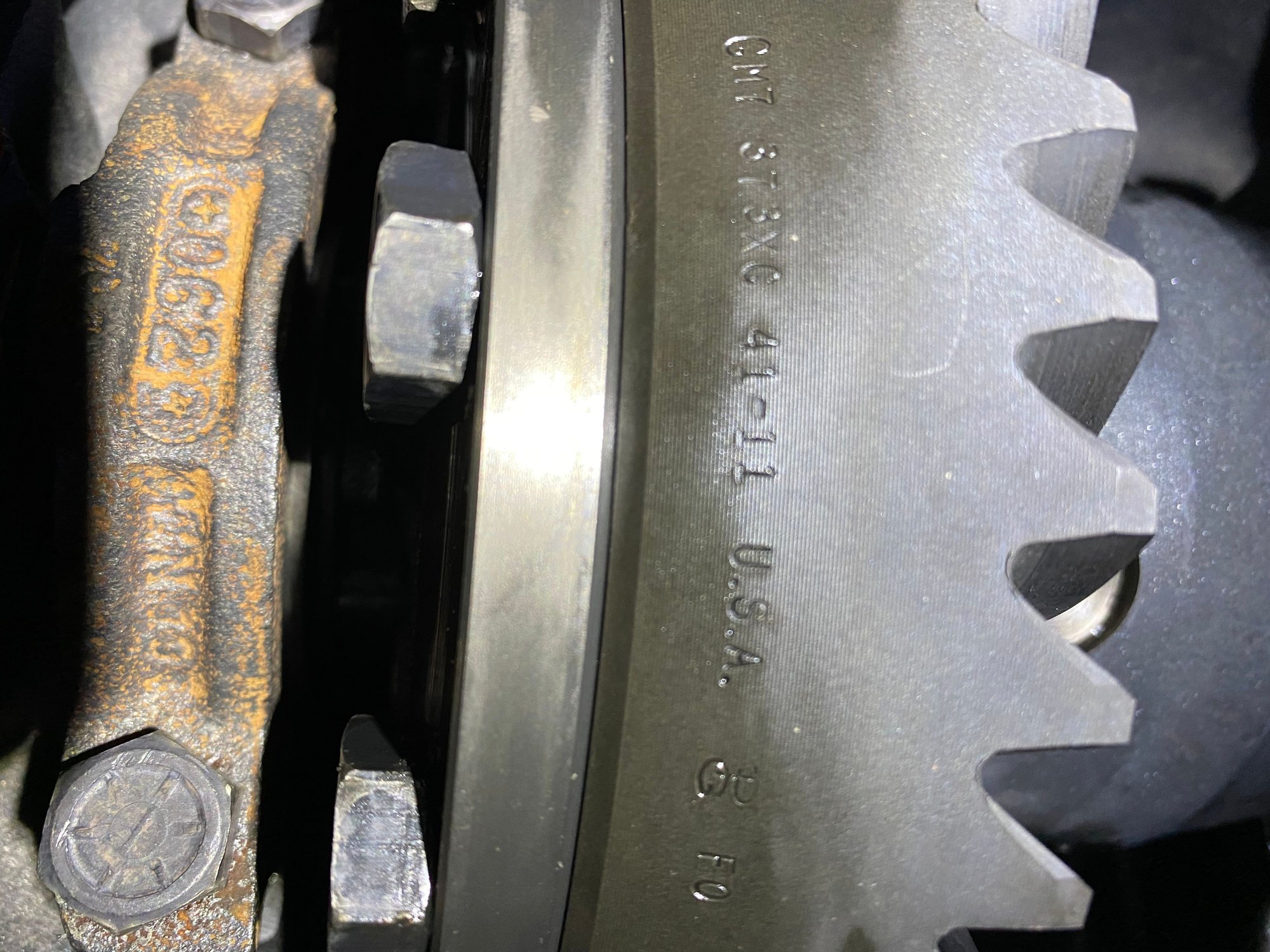

Originally Posted by Swapper

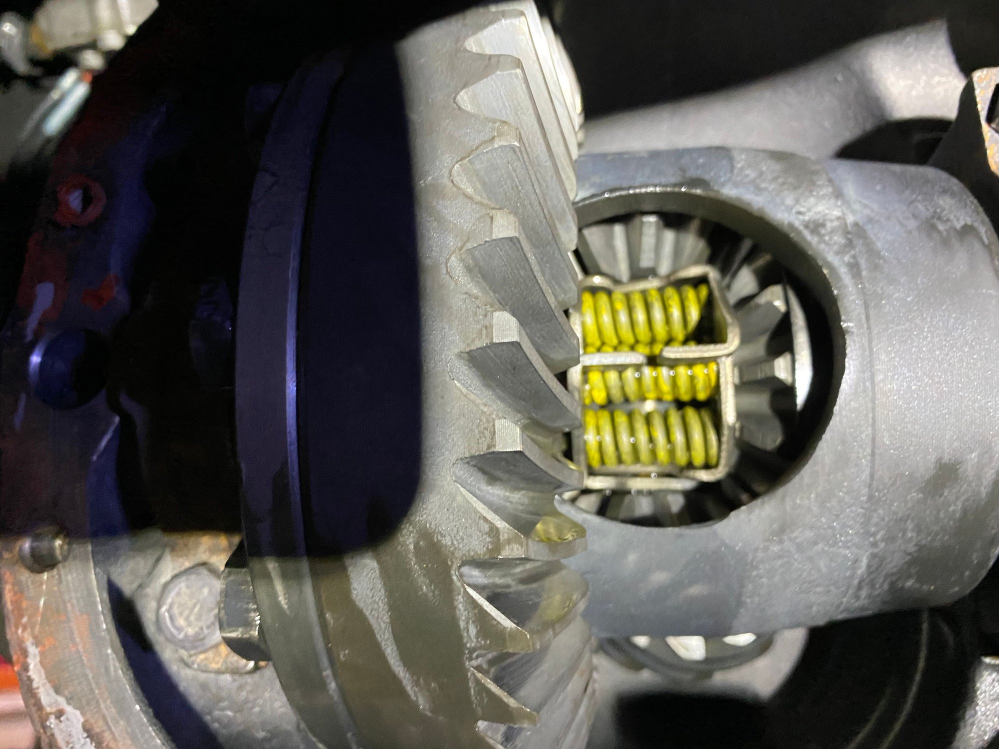

threw my 9" under the car to see what im dealing with. eye ball lined it up with the stock diff. straight in line of the driveshaft. looks like i might be close on the drivers side and short on passenger side. now do i try and cut and fab this up myself or sell this setup and try adn save for one that bolts in (i cant save money if my life depended on it) so itll probably never happen. im not building a drag car just want a little stronger diff than a 10 bolt. although i have never blown one up yet, but then again i have never put the power through one i should be making
Hey man, if you want to do it and have the means to do so, then heck yeah, go for it. I'll tell ya tho, it's a lot of work. Especially if this is your 1st time. Critical measurements need to be taken. Jigs for alignment for springs, lca, and most importantly, to make sure the axle is straight and true. I built a 8.8 this winter/spring. Have a lot of time in it. Do a search and check it out. Get a feel for it.

Re: what did you do to your thirdgen today?
i think ive read through your post and several others. been getting a bunch of measurement pics, ideas, etc... actually thought about goin to a 8.8 instead. i actually originally was lookin for a 8.8 then i found this diff at a decent price so i decided to try it. i do like trying to do things myself. ive never swapped rear ends. my s10 that was almost the same build im goin in my camaro had the 7.5 10 bolt and that was making 465rwhp 390rwtq. dumped clutch multiple times never had a issue. actually bought a shortened 8.8 for the truck which i wish i would have kept.

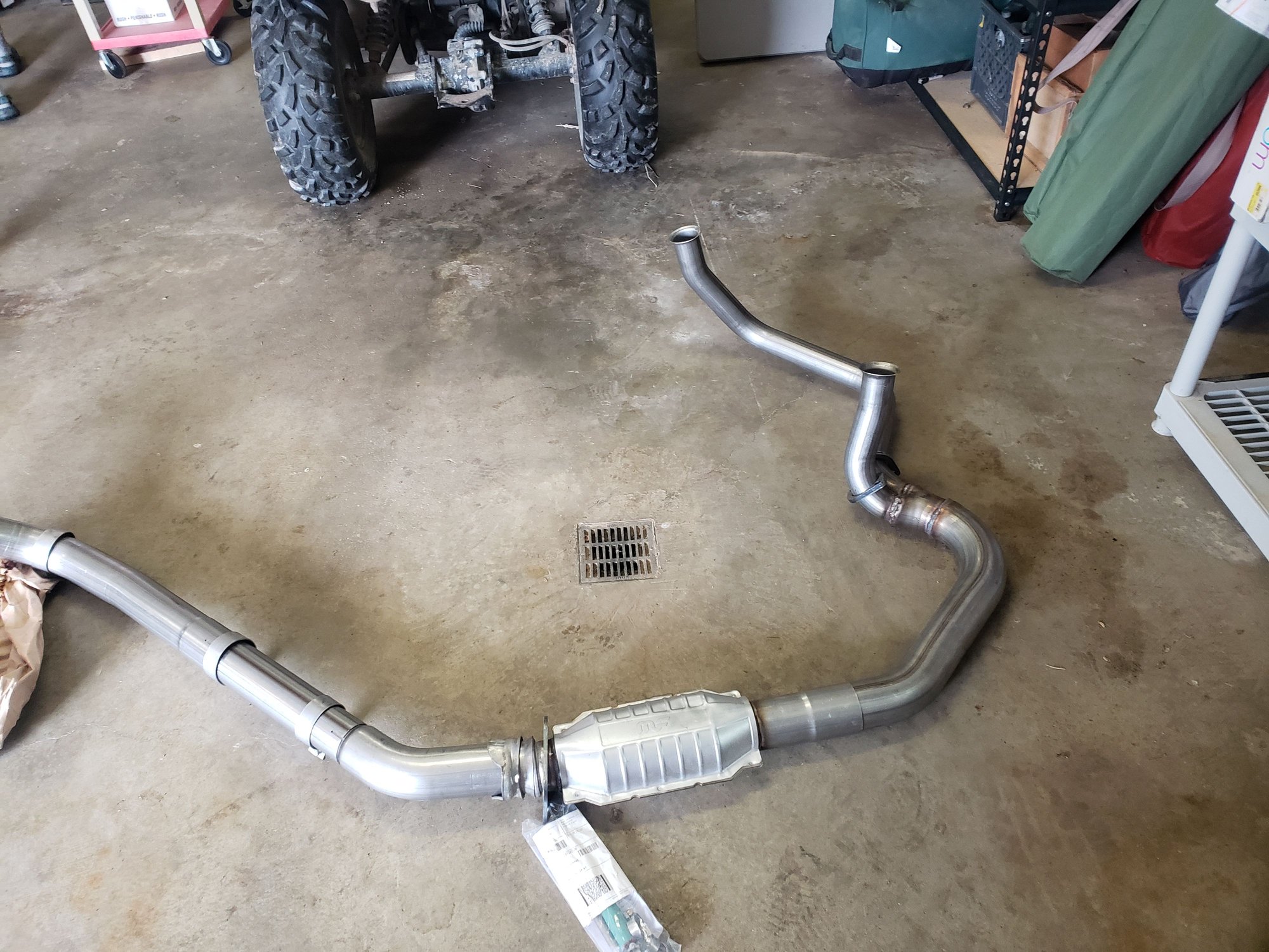

hooker 2460 ceramic coated headers and y-pipe installed.(still have to tighten it all but everything is in ,all bolts etc.)
you don't want to know how many f-bombs and flying tools were bouncing off the garage walls.man,i need a drink...wish i still drank

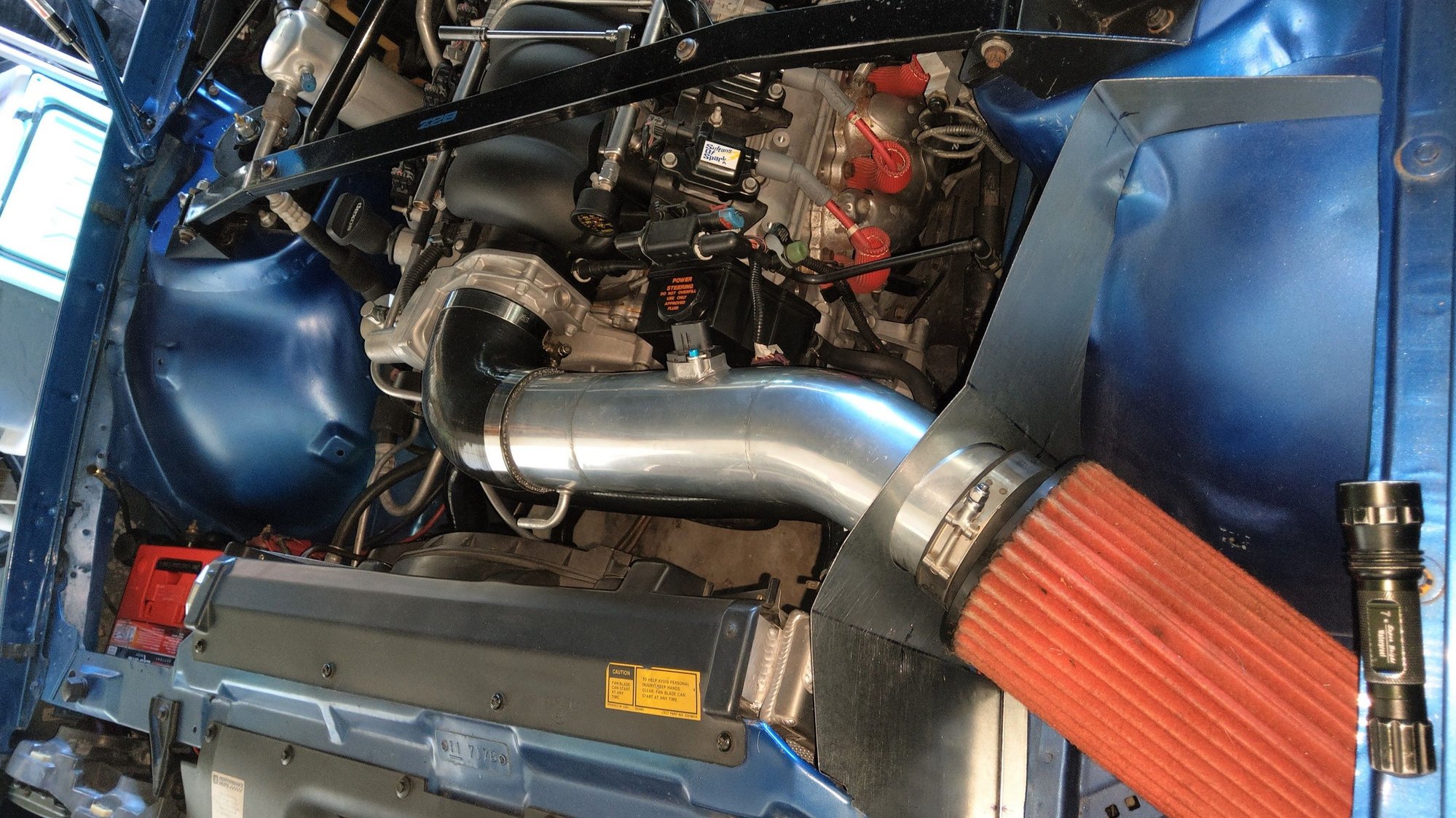

Made a new CAI that seals a little better, now to paint it.

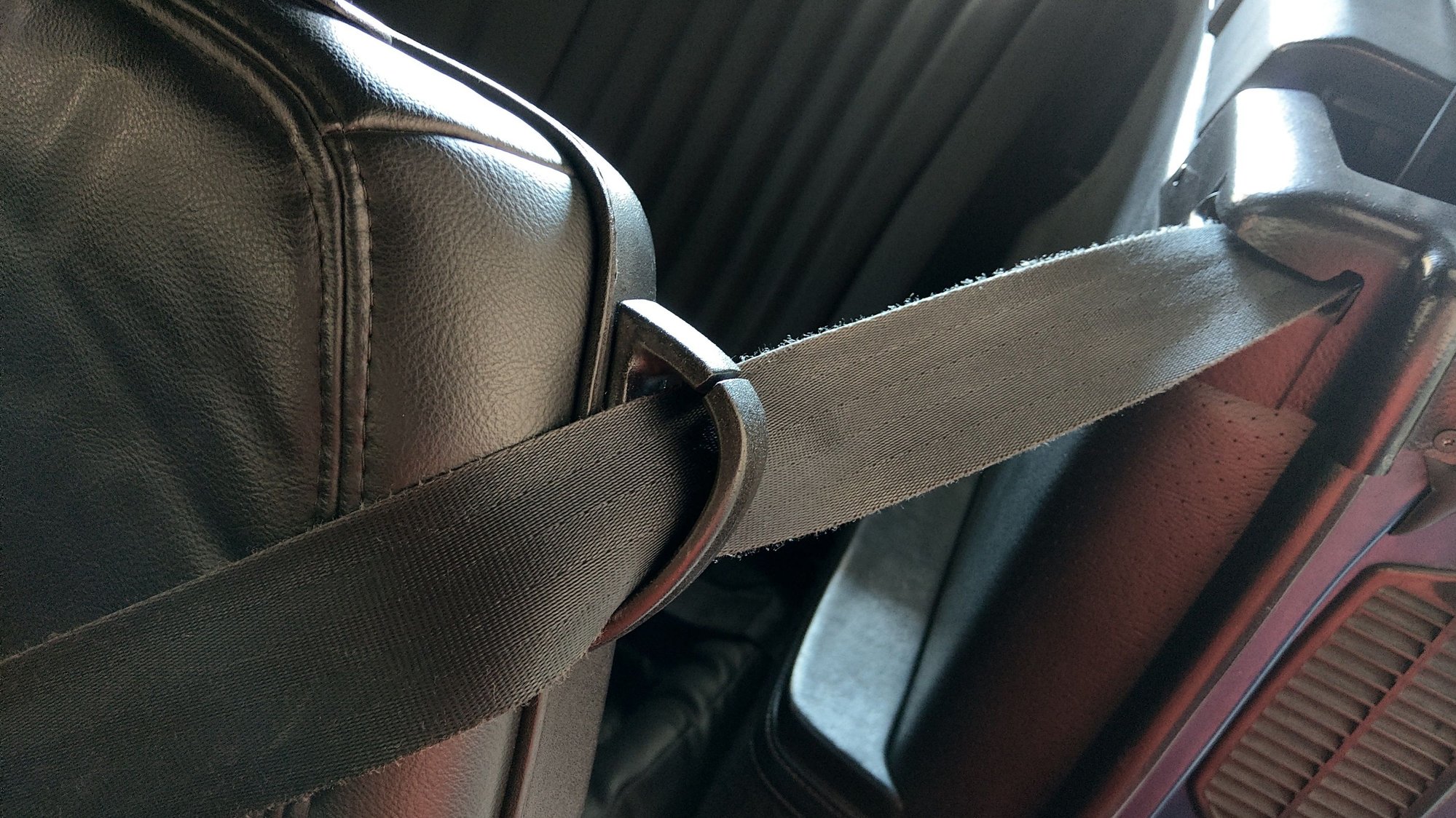

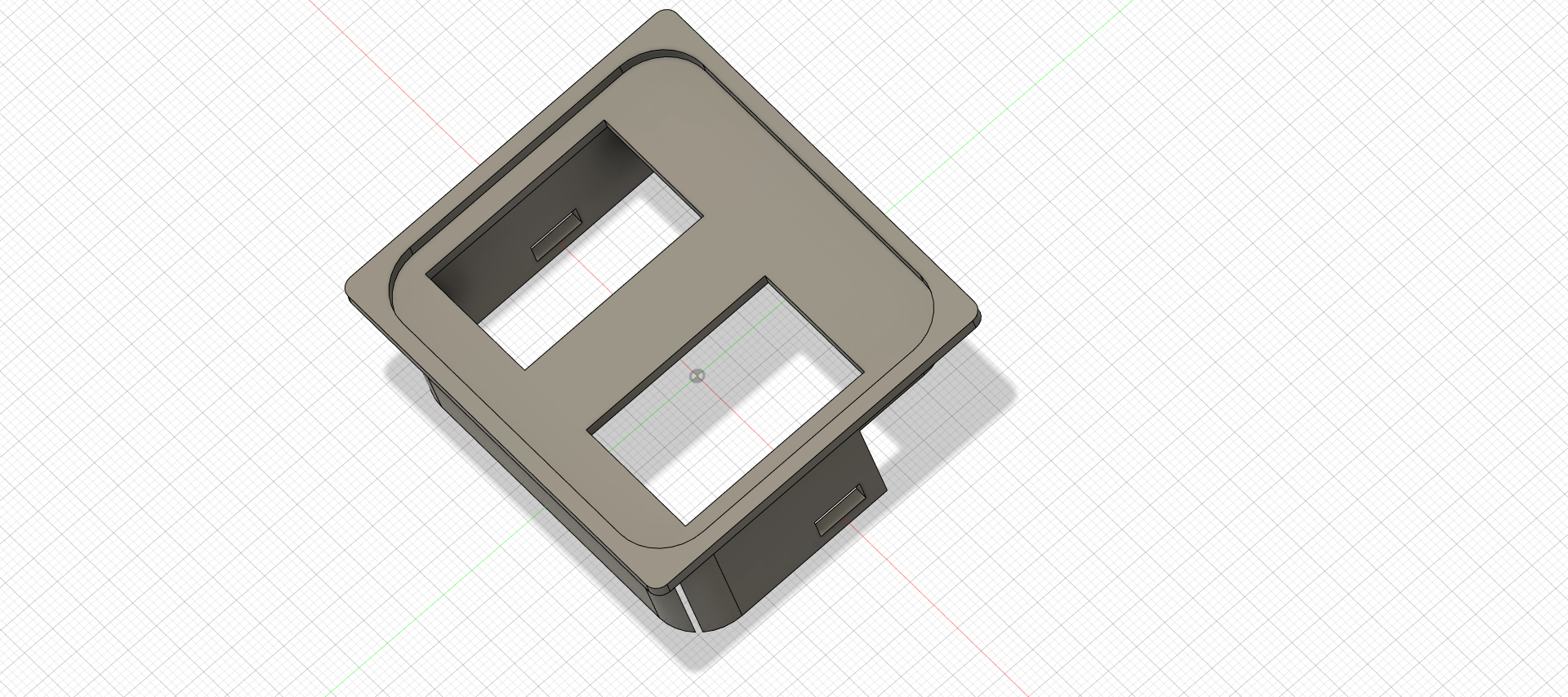

Did this little mod, i got tired of the seat belt loops on the headrest.Just not working in the vert. These are from a VW something, but they were seat back release "*****. Quite a bit was cut away too.

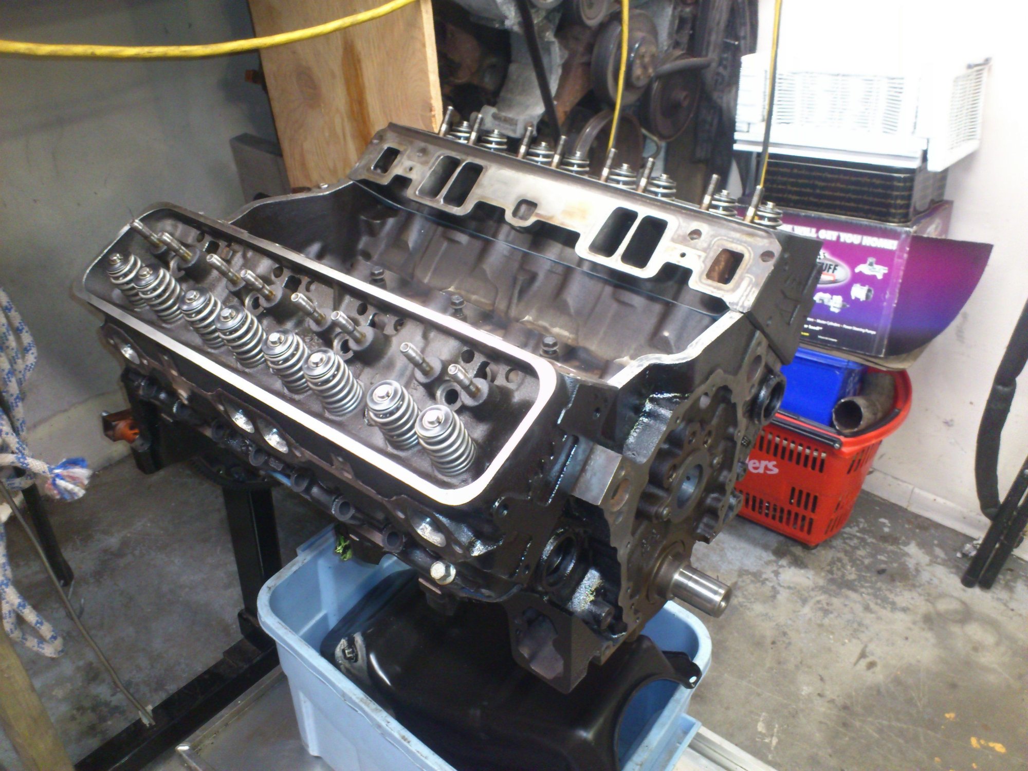

project hellion/shithawk is coming along,the L31 is getting close.im using the crate sp350/357 recipe for the build.
vortec heads are assembled after lapping the valves,a little exhaust port work,new retainers,LS springs,valve seals.
ive got a nice #12677151 SP350 cam ready to install,so i bought a NOS comp cams timing chain sight unseen,now i find
out roller cams have a smaller bolt circle so i need another one(grrrrr)
i have billet valve covers,breathers,timing chain cover,water pump but they need a polish,what do you guys use to bring back hazy aluminum?

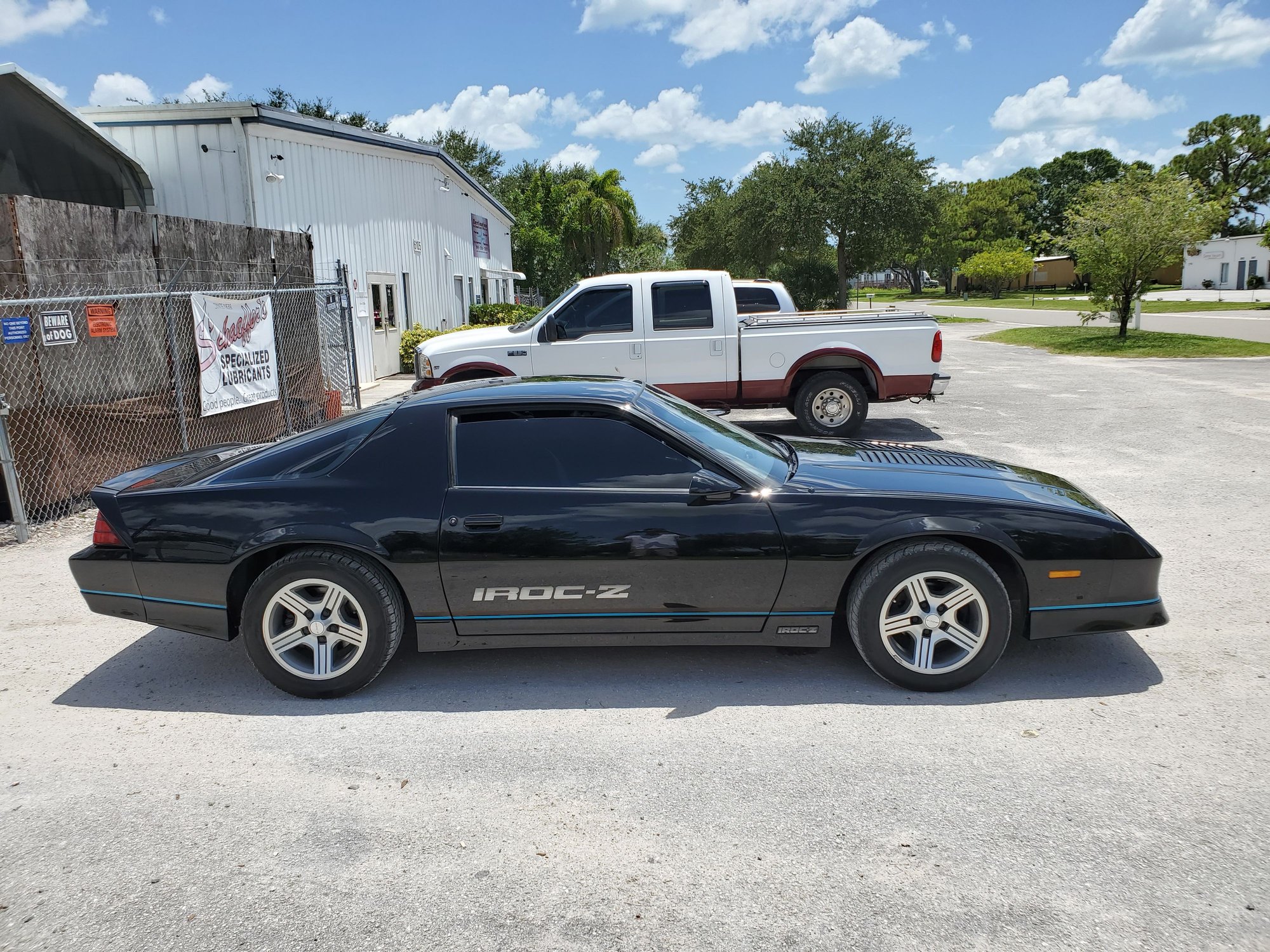

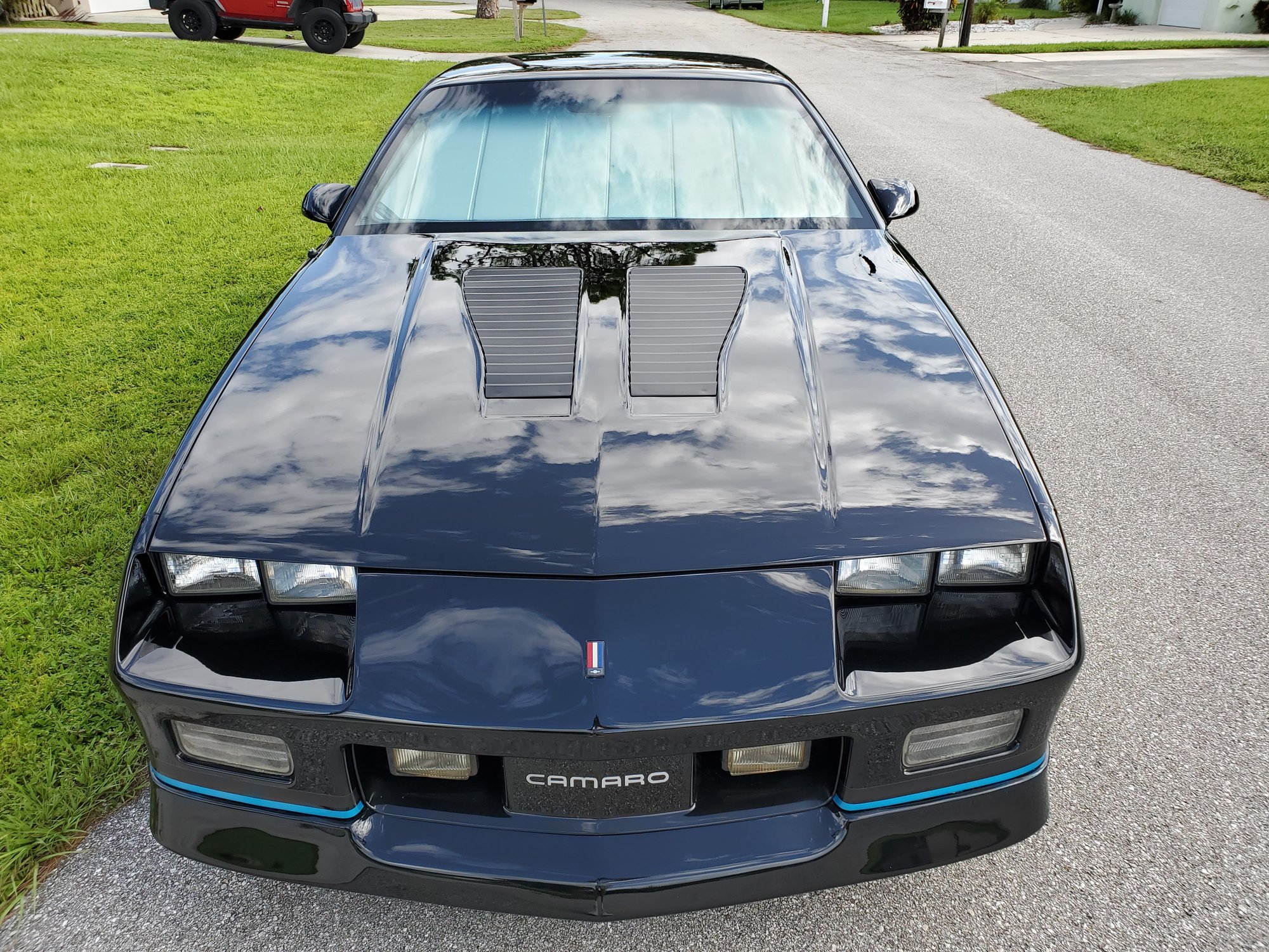

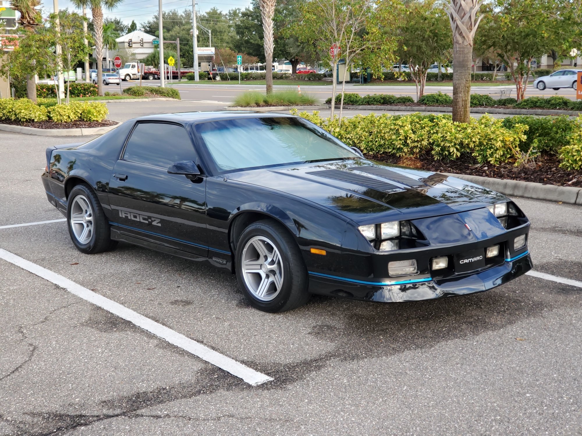

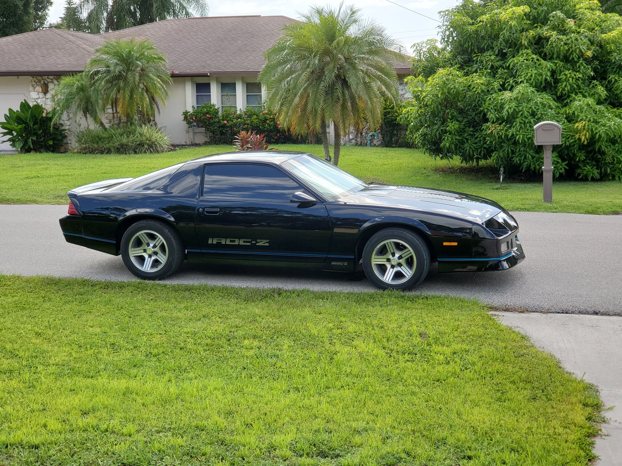

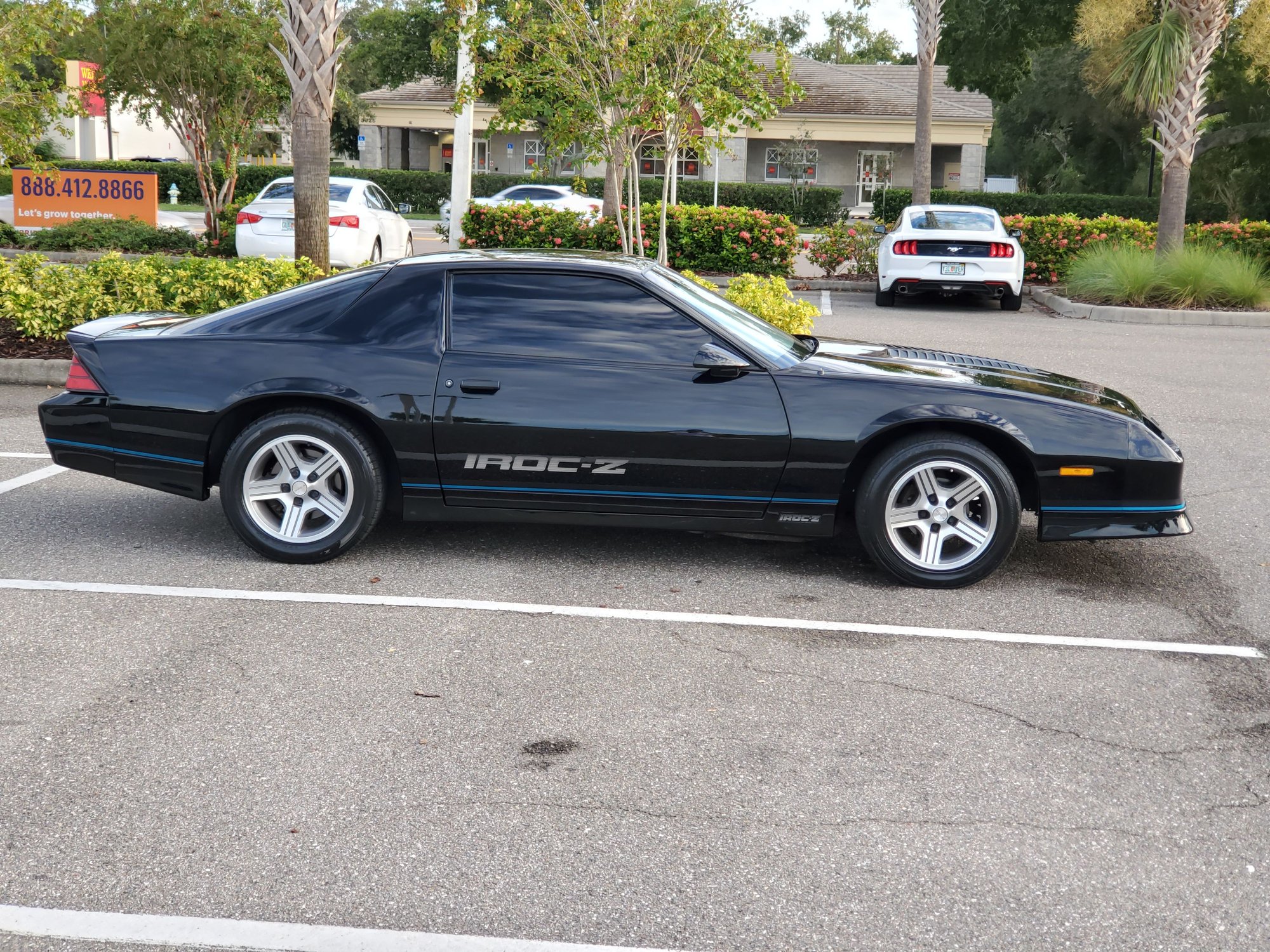

A week ago today, I got my '89 Iroc back from the painter. Here are some preliminary shots before my final detail.
Old Aug 8, 2020 | 09:07 AM
  #1319
2 birds 1 Z's Avatar
Joined: Aug 2017
Posts: 193
Likes: 16
Car: 2002 Firehawk & ws6 1989 Iroc Z
Engine: All 3 have 350s
Transmission: Birds manual Iroc auto
Axle/Gears: TAs 342 & Iroc who knows?
To say I am pleased with his work would be an understatement. The paint looks better than factory brand new, Absolutely no orange peel or flaws of any kind is visible. And since I paid big bucks to have it restored to it's former glory, yes, it does sit under 2 covers.
Looks great! What, if anything did you remove for the paint job?

The car was stripped down to primer & all maladies were repaired. Various dings from the original owner, cracks where the c pillar meet the roof were welded & smoothed. Front & rear fascias were removed. Windshield was replaced. Side moldings were left off for a cleaner look. The painter sent me pictures along the way, but his phone would not upload the pics to my computer.

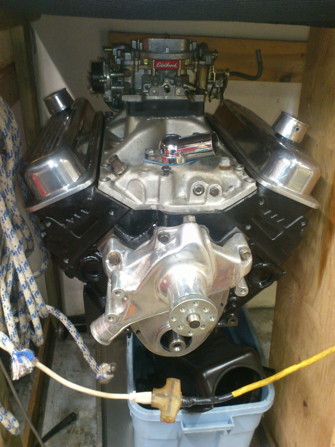

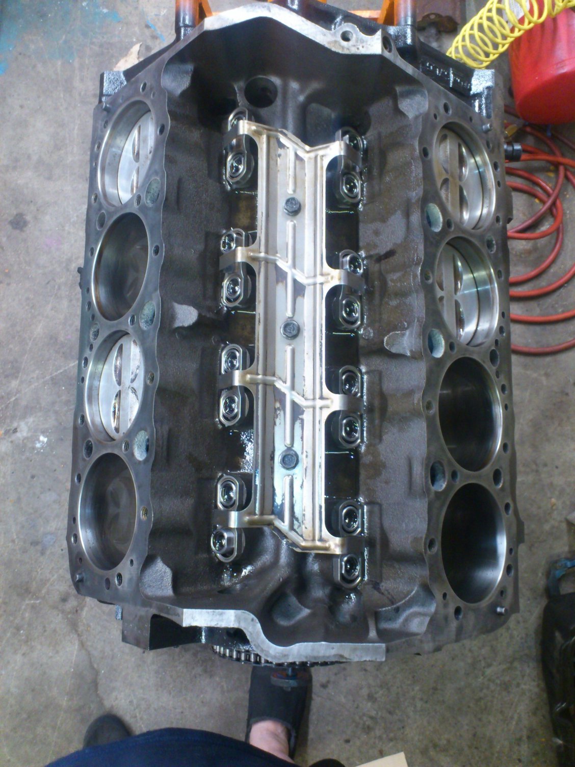

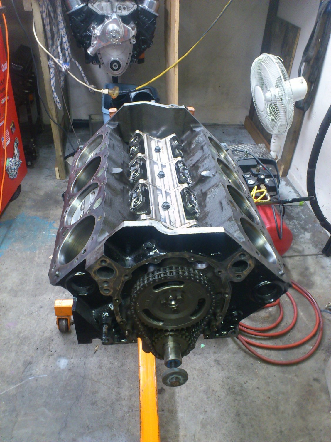

worked on project motivation:
i have the L98 long block cleaned,painted,new seals,gaskets,bearings,flat top pistons 4 relief. standard bore still cross hatched and sweet.
installed GMPP sp350/357 >> 7151 roller cam,rebuilt,cleaned,reinstalled roller lifters,dog bones,spider,new double row cloyes timing chain.
i went with this one because it was rebuilt less than 5000 km ago and doesn't need machining.it also has flat tops 0.025" down and a mech fuel pump boss.
1)ready to to install windage tray from L31 vortec,stock oil pan cleaned and painted,new felpro blue one piece oil pan gasket and new oil pump.
2)ready to install my L31 vortec heads,valves lapped,light cleanup behind valves and exhaust ports,
new felpro valve seals,new gm LS6 valve springs,new comp cams retainers.felpro blue head gaskets.
3)ready to install my edlebrock performer RPM,moroso 1" phelonic spacer,new felpro blue gaskets
4)ready to install my holley ultra 650 double pumper (mechanical secondaries for stick car)
5)ready to install GM hei refreshed,new adjustable vacuum adv,accell coil,msd cap,blue max wires
6)ready to install billet valve covers,billet breathers and felpro blue valve cover gaskets
