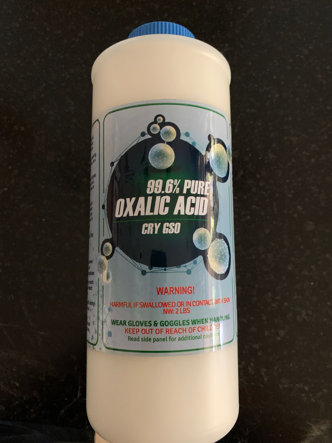

My coolant is brown after my rebuild which means I've got rust in there. Got a lot of good info on my other thread about this. Now I need to do the treatment and flush.
I have been told to absolutely drain from the block drains and the knock sensor.
For the flush here is what I plan to do. I would love opinions as I just want to get rid of the rust issue. FWIW, I always use AC Delco green coolant from the dealer.
PROCEDURE
  1. Get the car up in the air a bit.
  2. Remove Thermostat and upper hose
  3. Drain System
    1. Disconnect lower radiator hose
    2. Open drain on radiator
    3. Remove both block drains on block and the knock sensor
  4. Garden Hose Water Flush
    1. Flush into the thermostat housing on the intake manifold until the block drain plugs come out clear
    2. Flush into the upper radiator hose inlet and through the radiator until clear
    3. Let system drain
  5. Acid treatment
    1. Install all drain plugs, hoses, but not the thermostat
    2. Fill with Oxalic Acid and tap water mixture (1 lb powdered Oxalic Acid to 3 gallons water)
    3. Run engine up to normal temperature and shut off
    4. Let sit for an hour restart for five minutes/rev it a bit and shut off again, repeat every hour for four hours
  6. Drain/flush neutralize acid treatments
    1. Repeat Steps 2, 3, and 4.
    2. Repeat Step 5 but instead of Oxalic Acid, use Baking Soda, and only perform for five minutes
  7. Drain and Flush
  8. Close up and refill with distilled water and new coolant

Well I did it yesterday. Went slow and baby-sat it throughout the day. First block drain flush removed a lot of rusty, dark flakes. Both drains were blocked but after poking it all came out. Used 2 lbs of oxalic acid for a 3 gallon cooling system. Removed thermostat, bypassed heater core/TB. Kept temperature at running temp for about 4 hours. Ran the engine every 20-30 mins to circulate. Drained- a humid, stinky mixture coming out (captured most of it but still messy- wife is going to kill me unless I get the rust-colored stains off the concrete before she sees them). Garden hose flush through all inlet/outlet-ways - thermostat, radiator inlet, radiator cap side, block drains, water pump inlet, radiator drain. Filled with water, ran for 5 minutes. Decided not to use neutralizer. Drained, flushed again, fully drained filled with new green coolant. Flushed heater core/TB loop. I think I have become a pro at the cooling system on these cars.
I could see the rust coating the water jacket on the cylinder walls through the driver's side drain opening. Afterwords it looks like new iron in there.
I have not tested the car yet on the road.
