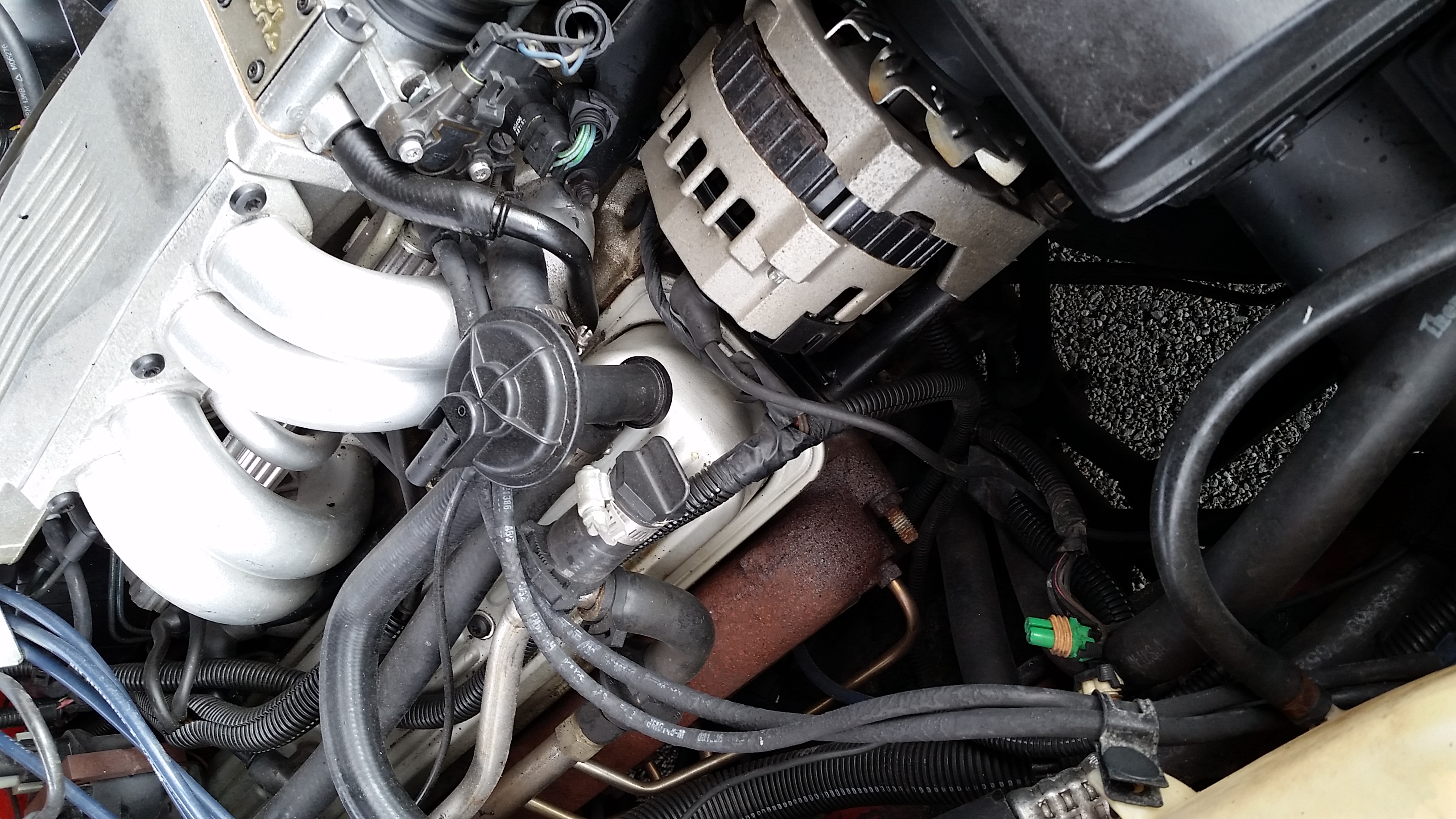

Oddly enough there's not even a delete pulley where I assume the air pump should be, so I'm not even entirely sure where the pump would sit normaly and how the belt would be routed. The two plugs for the valve are currently just "hanging" around near the bottom.

You're missing more than the pump. The brackets are gone too.
Might want to post in the classifieds on this site since so many people seem to want to hack that off of their cars. More than likely, any pump you'd get that way, would be questionable at best; but they're not too $$$ at the Zone or RockAuto or wherever. But that would be a good way to get all the brackets and whatnot. Ideally it would come with all the hoses and lines, including the one that goes to the catalytic converter.
The check valve that should go where that hose and ... something ... and all that are, you can also get at the store.
Belt routing is on the sticker on your radiator clamp.
