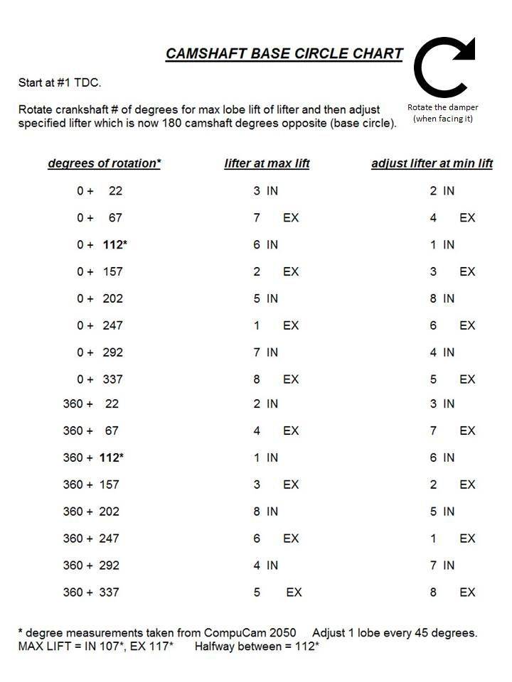

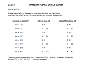

I made this chart.
It works for any SBC 18436572 camshaft - mild or wild.
All you are doing is putting a lobe at max lift, and adjusting the rocker for the lobe 180 degrees opposite at minimum lift.
Attached Thumbnails rocker arm pushrod lash-base-circle-chart-1.png   rocker arm pushrod lash-base-circle-chart-2.png

Thanks! Great chart. Anyone sell a damper sticker that has the degrees marked?

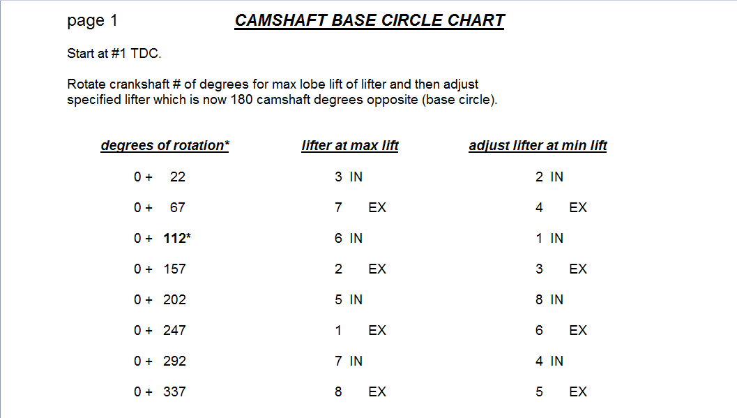

I made a few docs to help me and thought I would share. One is the combined table plus a crank rotation add-on from NE84TA's post and the other is a 6-3/4" damper face template for indexing.
PLEASE DOUBLE CHECK so that I can make sure these are correct. I can fix them if needed.
Thanks!

Yes Tootie, your degree wheel is perfect. Just tape it to your balancer.
And sofa gave another explanation for what I was trying to show. Thanks.
