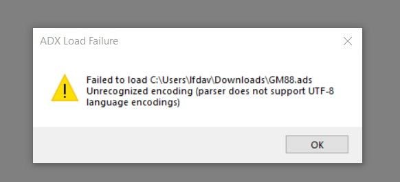

Old Aug 3, 2023 | 01:32 PM
LarryD's Avatar
Joined: Nov 2005
Posts: 668
Likes: 24
Car: 92 RS
Engine: 3.1 V6
Re: ALDL Cable and Software Recommendation?
Thanks for the additional info. I was missing the part about using the Aquisition Toolbar. I was assuming you opened the file with File Open since Tunerpro RT is new to me. Anyway, I saved the file as an *.ADS and then went to the Aquisitioni Toolbar to load it as an *.ADS file. All I get is the following error message:
So, I tried to Import the *.ADS file. I didn't get an error message but nothing seems to happen at all in Tunerpro RT.
Old Aug 3, 2023 | 03:00 PM
Tuned Performance's Avatar
Community Influencer
iTrader: (95)
Posts: 16,916
Likes: 1,016
From: Mile High Country !!!
Car: 1967 Camaro, 91 z28
Engine: Lb9
Transmission: M20
Saved the file as an ads ? It was ads to begin with. You lost me
Old Aug 3, 2023 | 05:42 PM
LarryD's Avatar
Joined: Nov 2005
Posts: 668
Likes: 24
Car: 92 RS
Engine: 3.1 V6
When I open the link (http://tunerpro.net/download/datastreams/GM/88.ads) the file opens as a text file. The only way to save it is to right click and select "save as". When I do that, it automatically assigns the filename as "88.ads.txt" to the file to save it.
Old Aug 3, 2023 | 07:07 PM
iTrader: (95)
Posts: 16,916
Likes: 1,016
Engine: Lb9
Transmission: M20
If you’re taking a text and converting that probably corrupts the file.
See instructions on downloading.Downloading
Download definitions by right-clicking and selecting "Save as..." You may need to correct the file extension for V5 definitions (.xdf for bin definitions and .adx for datastream definitions).
http://www.tunerpro.net/downloadBinDefs.htm#GM
Old Aug 4, 2023 | 07:58 AM
LarryD's Avatar
Joined: Nov 2005
Posts: 668
Likes: 24
Car: 92 RS
Engine: 3.1 V6
I have already done exactly as you said and the instructions say: Downloading
I have tried all versions of "Save as..." (.adx, .ads, .txt) and tried both Load and Import in Tunerpro RT for each extension. It still doesn't work and I get that same error message. So, thanks for all your help but I give up on this program. I may try something else like WinALDL or similar later as I would like to be able to see the datastreams in the future. In the meantime, I went back to "old school" troubleshooting and, after a full day yesterday, I was eventually able to fix my car. I have to get on to other work fixing my AC next as well as work on my 67 SS/RS restoration.
Thanks again. I appreciate the time you have spent trying to help. Maybe it is a Windows compatibility issue.
Old Aug 4, 2023 | 08:13 AM
iTrader: (95)
Posts: 16,916
Likes: 1,016
Engine: Lb9
Transmission: M20
Here's the adx for future use
File Type: zip
