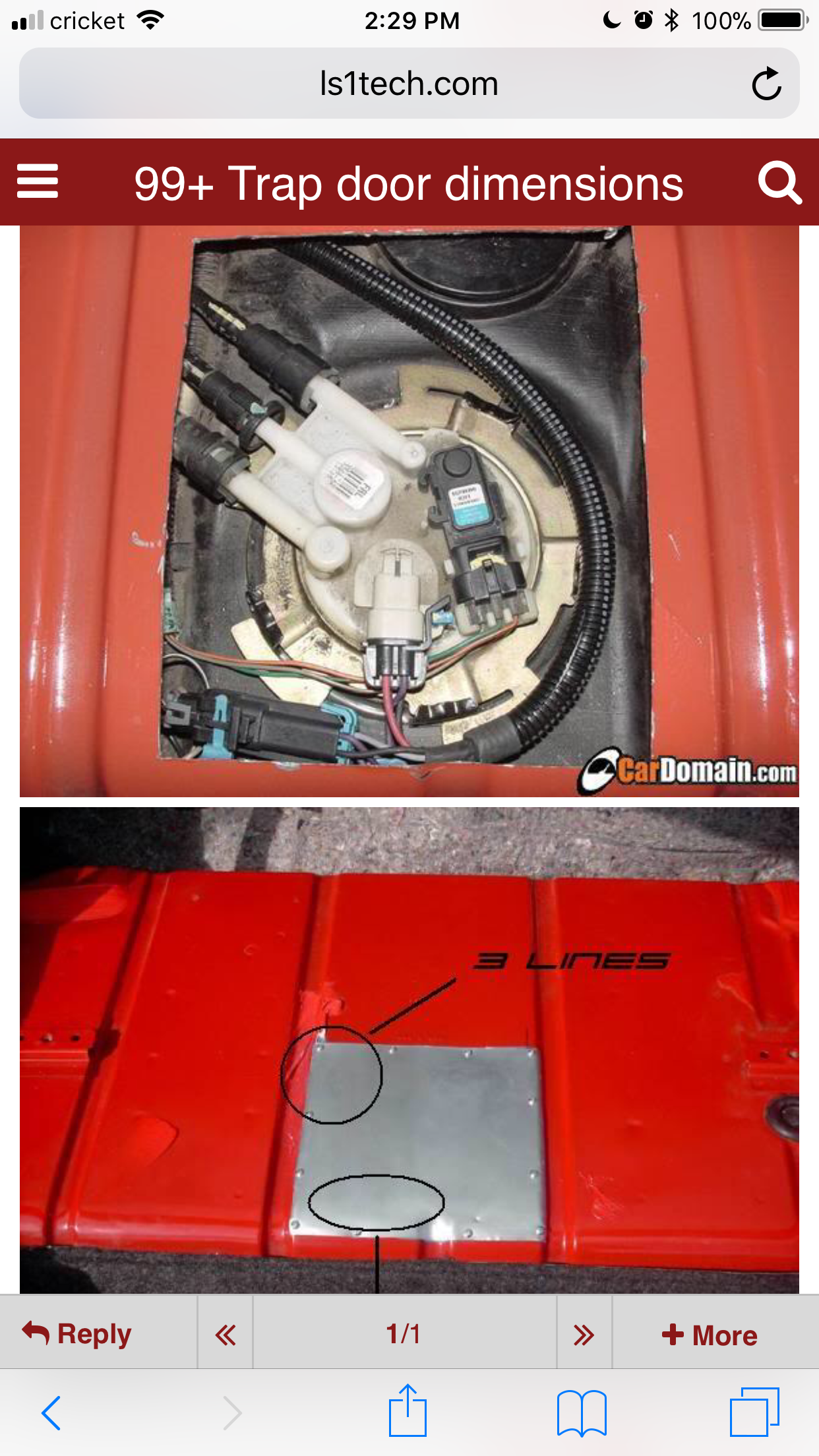

This isn’t my car, but I cut my 00 by this
Attached Thumbnails 4th Gen Gas Tank Fuel Pump Hole Access-87326e67-e16f-4f12-91d2

Thanks, I appreciate the information.
