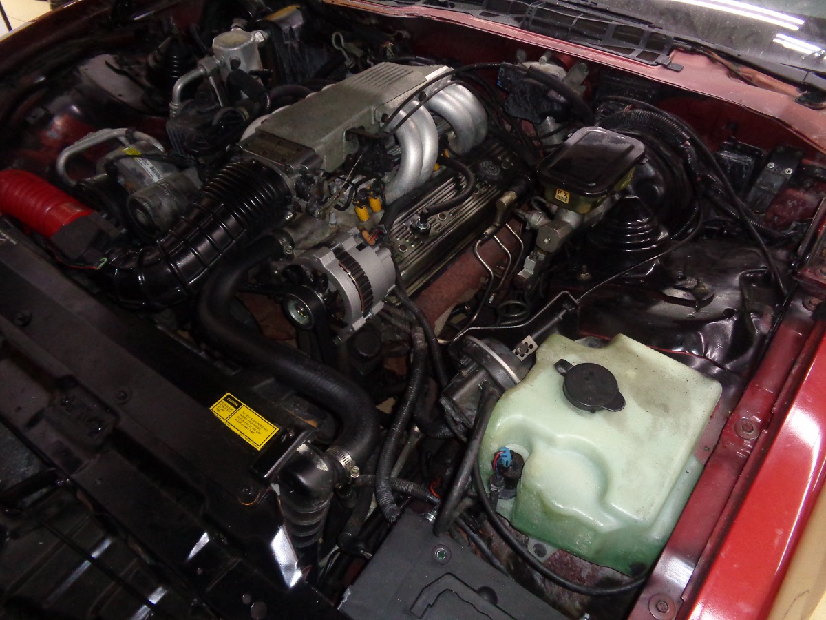

Sounds like a vac leak but post up a picture of the engine compartment if you can.
Quote:
Here are a couple pics. Please excuse the disaster of an engine bay this thing has, the previous owner(s) were real hacks. I'll be correcting the air induction and restoring the engine bay to a presentable looking condition but would like to get the car to run properly first. Any suggestions on an aftermarket cleaner box would be great, otherwise I planned to source an original box system from a local pick-a-part yard unless someone here wants to part with either for a good deal. Originally Posted by TTOP350
Sounds like a vac leak but post up a picture of the engine compartment if you can. If you see anything out of place in there, let me know as I'm not real familiar with this car. If you need close ups of anything I can also provide that as well.
Looks like someone also replaced the Alternator and EGR recently. I replaced the serpentine belt.
Thanks, Jim

what are you using for coolant recovery tank? I see the hose going down the front by radiator.Originally Posted by 1989GTAFunCar
Here are a couple pics. Please excuse the disaster of an engine bay this thing has, the previous owner(s) were real hacks. I'll be correcting the air induction and restoring the engine bay to a presentable looking condition but would like to get the car to run properly first. Any suggestions on an aftermarket cleaner box would be great, otherwise I planned to source an original box system from a local pick-a-part yard unless someone here wants to part with either for a good deal.If you see anything out of place in there, let me know as I'm not real familiar with this car. If you need close ups of anything I can also provide that as well.
Thanks, Jim

No recovery tank, car came to me on a trade like this. I need to source on of those as well so if anyone has any of the original parts I'm missing for a reasonable price, please let me know as I plan to visit a local pick-a-part when the weather dries up a bit and wouldn't mind not having to make the trip.Originally Posted by Lakerman62
