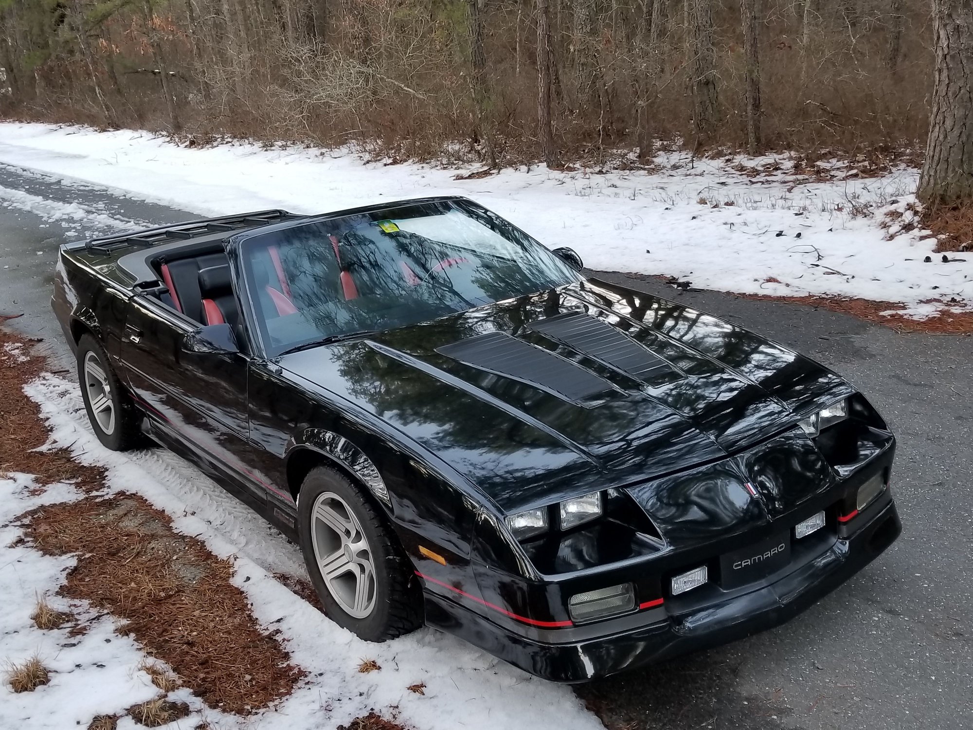

Nice looking camaro. Worth a $10,000 driveline I'd say. You can't buy these cars new anymore and most that still running are very ruff.

And yeah, I don't want to put $10k total in the entire car, let alone in the drivetrain alone
Bought it for $5k last fall, I would like to keep the total investment under $10k while cleaning it up and refreshing the driveline a bit. Not going to be an LS swap here in the near future......
