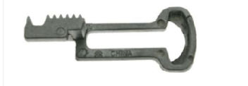

Ok well I pulled the steering wheel off and lowered the steering column, when I turn the the cylinder lock back and forth I can see two metal pieces on the other side of the steering column move , the two metal rods that go down the steering column don't move at all when I turn the key but when I pull one of them back manually my accessories and fuel pump come on

Ok i think i found my problem the rounded end of this piece is completly broken off ,any idea how to replace it ?im kinda new to working on cars
