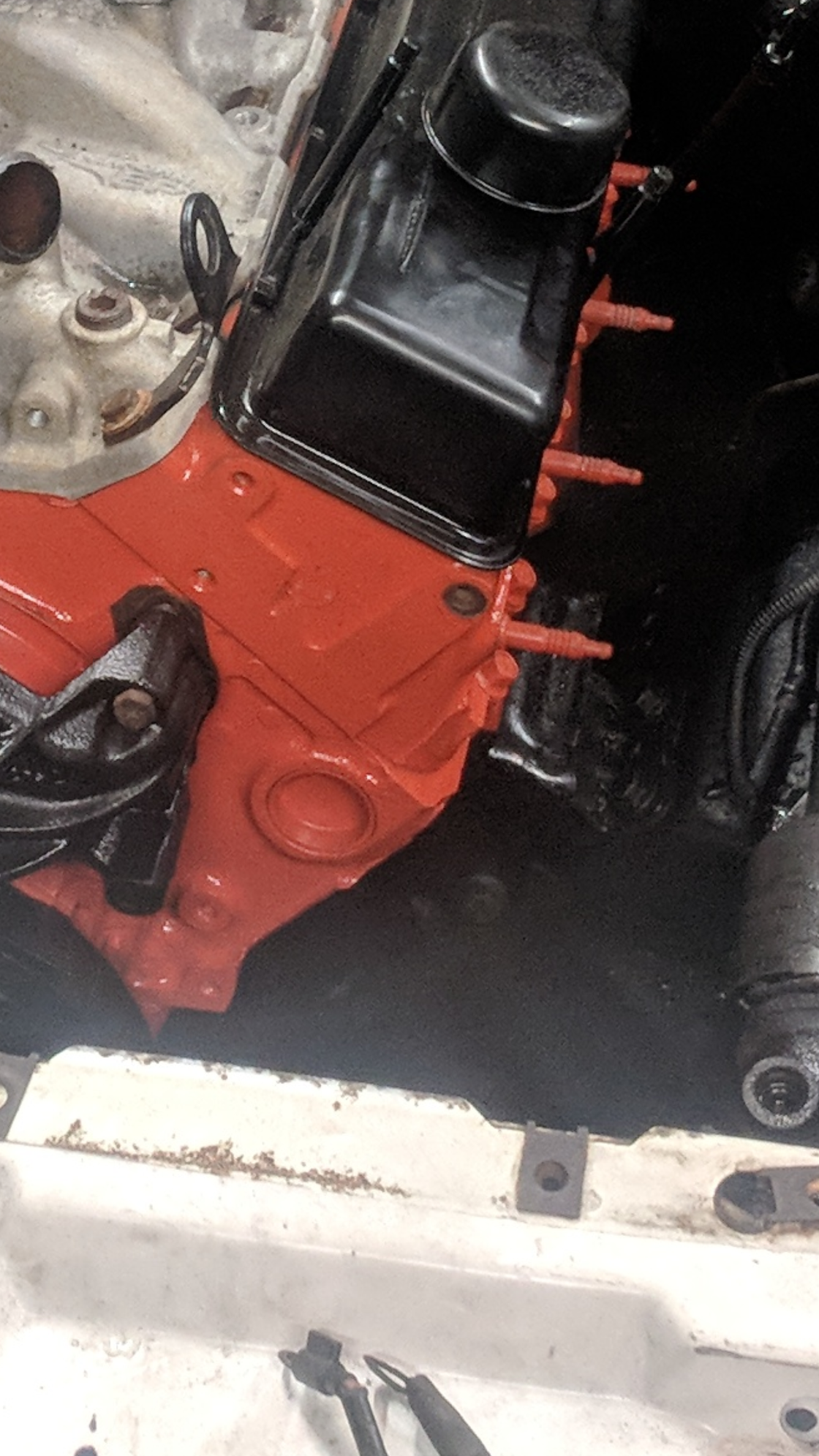

Old Jul 2, 2018 | 12:23 PM
Homer0310's Avatar
Joined: May 2018
Posts: 16
Re: Lifting Engine To Swap Oil Pan
Old Jul 2, 2018 | 12:24 PM
Homer0310's Avatar
Joined: May 2018
Posts: 16
That's where I hook chains
Old Jul 3, 2018 | 08:53 AM
rottweiler68's Avatar
Joined: Jun 2017
Posts: 143
From: Illinois
Car: '89 Iroc
Engine: 383 TPI
Transmission: Built 700R4
Axle/Gears: 9 Bolt - 3.45
Seems to be hole exact opposite side of that location on the back as well to use with it. All those accessory holes are 3/8'' I believe correct? Also grade 10 bolts should be used? Thanks again!
