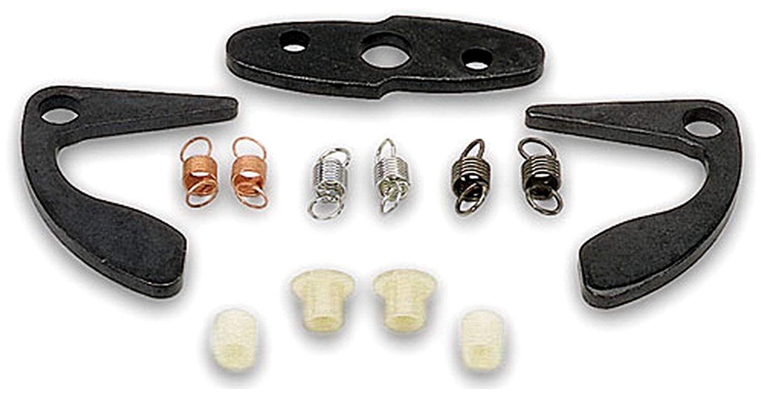

Slap a bunch of lubriplate (white grease) on the weights to reduce friction and wear.
Don't forget, the weights and springs are tuning aids. They can easily be swapped and mismatched to get a desired timing curve. You can have one big and small weight or one light and heavy spring like in the picture.
Weights determine how much advance is in the curve. Springs determine how quickly the advance goes through the rpm curve.
