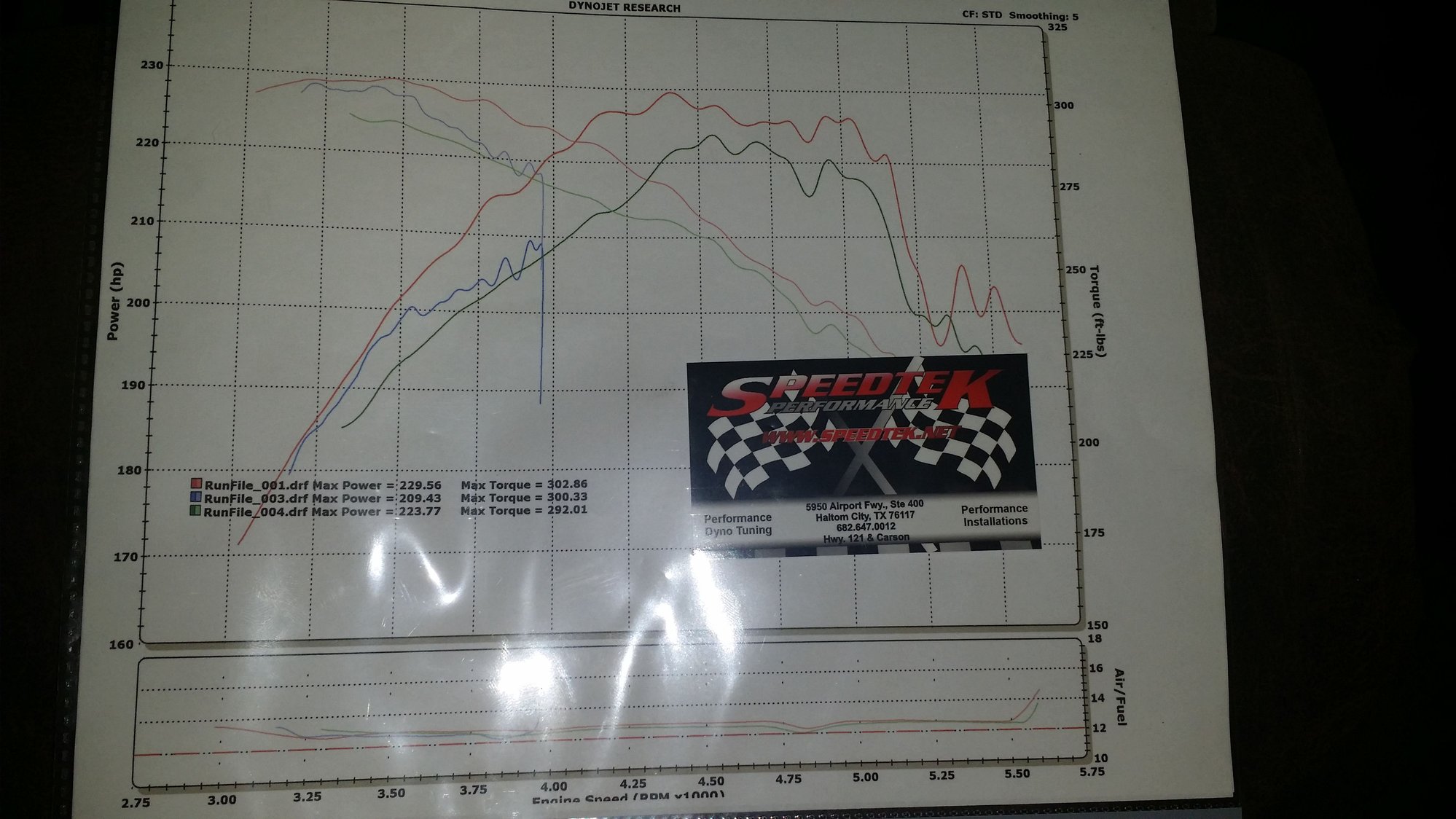

I have the sheets and time slips to validate mine over the years too. At 6,200 rpm the LT4 Hotcam/Dart 180 engine was less than 20 HP down from the peak at 5,100 rpm. The 350 TPI I had in my G-van went 14.1 @ 101 mph in the 1/4 mile in a 5,300 lbs brick with a stock stalled 700r4 and 3.08 gears. That is ALOT more than 220 RWHP. I made about 300 RWHP and about 370 RWTQ with stock runners, ported upper plenum, ported edelbrock vortec base, stock 46mm throttle body, ported 906 heads, factory LT4 cam and 1.6:1 rocker with Thorley Tri-Y headers for a G-van and dual 2.5" exhaust with a X-pipe.
The 383 in my signature did 360 RWHP and 380 RWTQ and went 13.8 @ 102 with a slipping transmission.
Also just FYI, it really does not matter what the power curve looks like if the car responds better to shifting at higher rpm. ETs & MPH at the track do not lie. I was merely stating a FACT that the 1987 Firebird that I setup and has run down the track with a 10:1 350, LT4 Hotcam, Dart 180s, stock TPI, shorty headers, dual 2.5" exhaust, backed to a 2,800 rpm stalled TH400 and 2.73 gears runs the best times shifting at 6,200 rpm. Car runs 7.80s @ 88-90 mph quite consistantly in the 1/8 on a 1.7-1.8s 60' time leaving at idle on drag radials. The car has a 2,800 rpm converter in it, but the owner is afraid to leave harder than idle with the weak 7.5" rear still under the car.
Also worth mentioning my low 8.75:1 compression 1-ton 350 TBI with a LT4 cam, 1.6 rockers, stock TPI, tri-y headers and exhaust ran best in that old G-van shifting at 5,200-5,300 rpm. Power peaked about 4,800 rpm with the TBI swirl ports and TPI but power was table top flat from 4,500-5,500 rpm. It also ran a 15.3 @ 92 mph in the 1/4 in a 5,300 lbs G-van. I never lost to a LS based truck engine at that time (2006ish) either. Go figure!

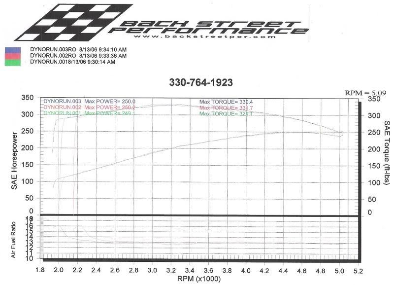

I know I will get flamed for posting these but here are some dyno runs I found on TPIs on the internet that also all seem to support them holding power until well above 4,500 rpm. If you cannot take my word for it, maybe this will explain what I have seen in a graphical form.
Seems the factory exhaust puts a choke hold on the Vettes more than the intake manifold. With 1 3/4" primary headers and a decent exhaust they are seeing gains of 40-50 RWHP @ 5,000 rpm.
1985 Corvette with ported heads, 1.6 rockers and 1 3/4" long tubes
This is a 1989 LB9 IrocZ with the peanut cam and stock exhaust manifolds. Power curve is flat enough that I would experiment shifting in the 5,200-5,300 rpm range at the track.
This is a 1989 Corvette with long tubes and descreened maf along with a few other parts.
This is a L98 cammed G92 305 5spd. This TPI was not even starting to fall off yet at 5,300 rpm.

Those results are basically what i see...
the 85 vette peaks at 4400-4500 like most tpi’s seem to. Its well nosing by 4800-5000. To me thats not pulling to 5+ But i may shift it 4800-5000 to see what happens
305 makes sense as its less cubes
the 89 vette does seem to hang on better to 5000 but by 5200+ i bet it really falls
my tpi stuff has been somewhat similar.

The biggest cam in those is 202/207 @ .050. The cam itself is falling off by those RPM. I bet you could put a single plane intake and a 750 cfm carb on it and the stock cam would fall on its face by 5,200 rpm. The 85 Vette is about the worst case example. It is nothing more than a smog 350 with flat top pistons and a 305 HO cam. The 76cc heads on it flow worse than most 305 heads.
Even the Hotcam with its 218/228 @ .050 duration using 1.6:1 roller rockers only peaks at ~5,600 rpm with a single plane intake.

The Hotcam/180cc Dart head car I recently tuned peaked about 5,000 rpm and was table top flat in HP from 4,700-6,000 rpm. It was within 10 HP of peak from 4,700-6,000 rpm with the stock TPI intake, base was port matched and the upper intake had the EGR dams ground out. EGR was also deleted. LT4 Hotcam that was degreed in at 5* total advance (drop in is 3* advance).
