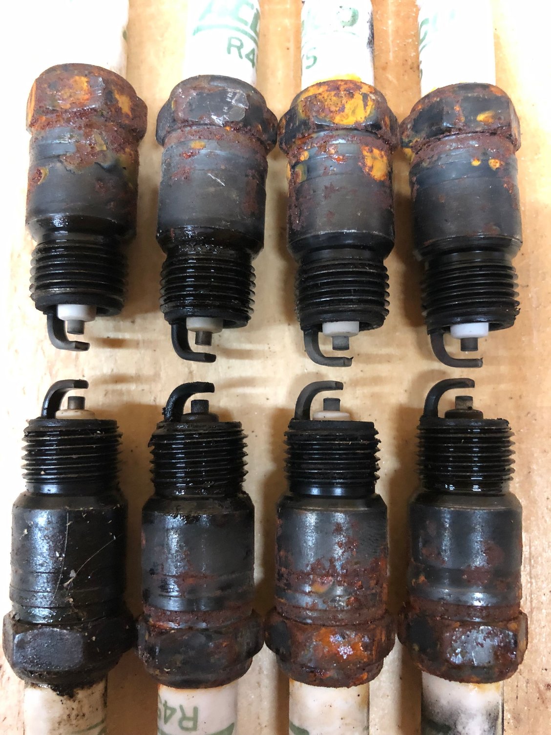

I’m going to jump into motor shortly to verify whether I have oil being sucked into # 2&4 and if that explains the plug color I’m getting. If all looks good on that point, then I am thinking of having injectors tested and cleaned. Anyone else done this and if so, who did u send it to?

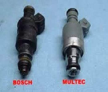

If they are Rochester Multec injectors just throw them in the trash. They are garbage and can't be fixed.

Well its winter so the ZR isn’t going anywhere. Again, its not certain I would need to do this. It depends on whether the coloration of my spark plugs is due to oil seepage into the cylinder or because a couple of injectors are not functioning to spec.
But I certainly appreciate ur offer. I should know by next week and then I can give u a heads up.
Many LT-5s utilize the Accels as replacements for the Bosch and I have not heard of anyone having issues like some other injectors. However, this is a set that has been installed for the last 10+ years. I guess we’ll see.
I may ohm these out ahead of time.

I have a similar problem with my 91 z28. Fouling #6 and #2 in low miles. Maybe valve seal but running very rich. Will be interested in the results of your cleaning or replacement of the injectors

Looks like you got acoupla stuck open ones. Probably trash on the pintle.
You can always try soaking em in lacquer thinner; no guarantees, but, it's cheeeeeeeep, and works more often than not. If it doesn't, or whatever, try Southbay (I've used them and was happy with their work) or FIC or any other reputable injector company.

With the findings that I am documenting in another thread on plug color and BLMs, it looks
like the culprit is not the injectors.
