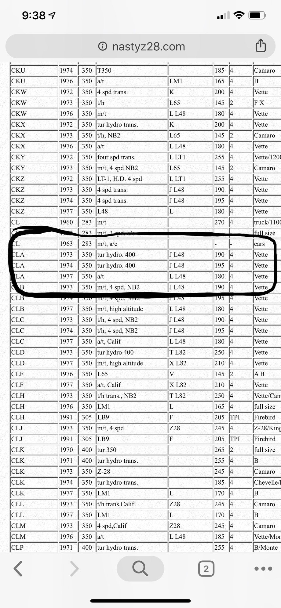

Re: Need help decoding the 350 in my trans am
CLA
1973 350 190 HP 4BBL TH400
1974 350 195 HP 4BBL TH400
1977 350 180 HP 4BBl A/T
The bottom 8 digits are last last part of the VIN that the engine came out of. It's a pre 1981 VIN number.
1 - Chevrolet
7 - Date code and based on the above numbers, that would put it as a 1977
S - Engine plant Saginaw Service
42092 - Production sequence number. Starts at 10001 so that would be the 32091 vehicle made that year.
At least that's what the engine was back in 1977. Considering the stamped numbers are still on the block, you'll know the engine hasn't had a proper rebuild where the deck gets milled to make it flat again.
There is no way to tell if it's a 4 bolt or not without pulling the pan. Truck engines are generally 4 bolt. Not sure about vette engines. The Vette classification really means nothing. It's a generic 010 block with a very small 180 HP rating based on what heads, cam and pistons were installed in 1977. Low HP smog engine from the factory.

I took a quick look at the RPO's but haven't had time to look through them all. I know the power seat was optioned, but from what I understand the cluster is supposed to be a 120, not a 140. The diff is an open 2.73, but I haven't checked anything else. I'll look for the build sheet when I get around to replacing the carpet. That's a great idea with the RPO video. I was planning on doing something similar with the Camaro, but by running a CarFax. I'm not sure if I swapped the center console out of the Camaro or not. I really wanna take a look at the Sport Coupe RPO's!
