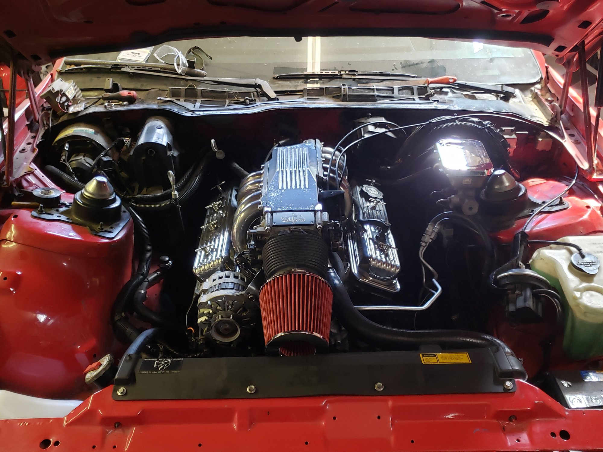

Hi guys. I just finished building g my engine bay. Been working on the plugs and wiring of the car. For some reason I keep blowing the fuse beside the battery. I've traced everything and find no exposed wires. Any ideas?

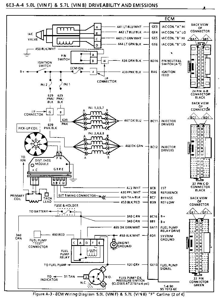

here is a schematic of the pump/ecm wiring. The ecm cavity’s are specific to 90-92.

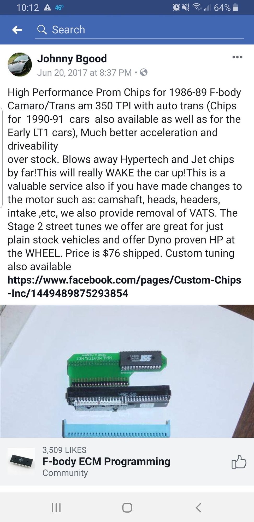

Its run without maf for years no issue until I took it apart for the cleaning and powdercoat
Old Apr 2, 2019 | 09:44 PM
Dusty Dc's Avatar
Joined: Oct 2018
Posts: 53
Re: Fuse beside battery.
The chip also deletes the maf and burn off from the ecm.

As you can see the wire powers the maf power, ops, ecm and fuel pump relay.
It could be a pinched wire grounding . If it started when you plugged in the pump relay check the wiring at the relay and try it with the pump disconnected at the rear body connector by the tank to see if it’s the pump itself.

look by the relays for a grounded orange wire.

Who made this chip? As far as I know that's not possible and have it run any kind of decent. They may have deleted the codes but it should still have the MAF sensor.. I would bet my lunch that it's running like crap in limp mode for all these years. You can't delete the MAF from a 7165 ECM with a "chip"

Its run fantastically for years with no issue. No limp mode. No issues. This is the same setup my father ran in his down the track for years.

The wire isn’t going to be purposely grounded. A short to ground is caused by a hot wire connected directly to ground or a component shorted out. Sounds like with the wiring being tampered with there is a loose wire maybe at the maf power that’s shorted to ground.

I'm still trying to wrap my head around "I just finished building my engine bay" followed shortly by a picture of the genesis of a rust hole in the same engine bay that is theoretically "finished".
What do you mean "Ignition coil"? I got an emissions delete chip! Don't need that **** cluttering up the place. John Force doesn't need no ignition coil, and neither do I!

Where do you see a rust hole? Are you blind?

That whole corner is looking fairly scabby. But perhaps it needs a good cleaning. I do see surface rust on more than one fastener for sure. That "chip" you bought is clearly a scam if you have no MAF connected and the SES light isn't on. That's basically criminal, or at least criminally stupid.

No rust just leaves. Paints chipping a little from where the PO did a paint over and didnt prep proper but the rest of the car is immaculate. No rust. No dings or dents. Whole reason I bought the domestic.

Oh man, you have one of those "John Wayne custom chips". At least, that's what his name was before he got removed from the most popular thirdgen facebook pages for scamming people.
