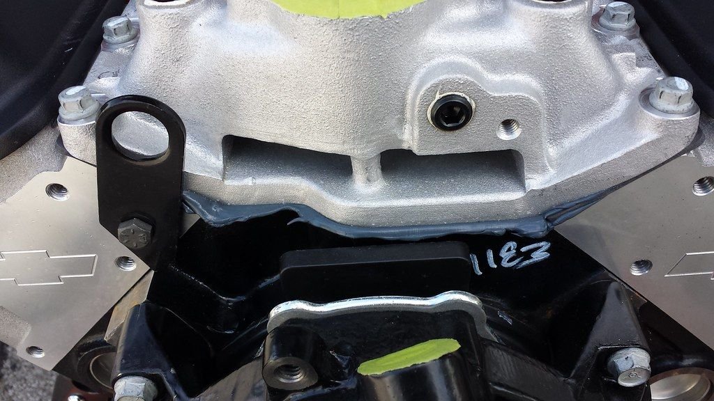

Originally Posted by LiquidBlue
I read a lot of guys have problems with the rubber gaskets and ditch them in favor of RTV.
Like GM? Cleaned up a take off ZZ4 intake a couple years ago. It was sealed with gray RTV.
Old Apr 16, 2019 | 01:44 PM
DynoDave43's Avatar
Posts: 4,826
Likes: 913
From: MICHIGAN
Axle/Gears: 10 Bolt 2.73 Open
Re: China Wall rubber gaskets - anyone ever had success with them?
Taken at a large car show here in Michigan in 2017, at a GM dealers tent selling GM Performance parts and crate engines. I just wanted to document for myself, for when I go through my SBC, that this is the way GM Powertrain is sealing these intakes, complete with a little of the grey stuff about one third of the way up the head on either side of the intake gasket. They have to warranty the thing, so if it's good enough for the General, it's good enough for me.

From: Salina, KS
I can tell you from personal experience, that crap does NOT come off easily. It took some work to get that intake clean. A fresh razor blade barely touched it. Knowing GMPP just a little, I'd bet that stuff comes out of a Permatex Ultra Gray marked tube, or a tube that looks suspiciously like the Permatex tube, but with a GM logo printed on the side.
