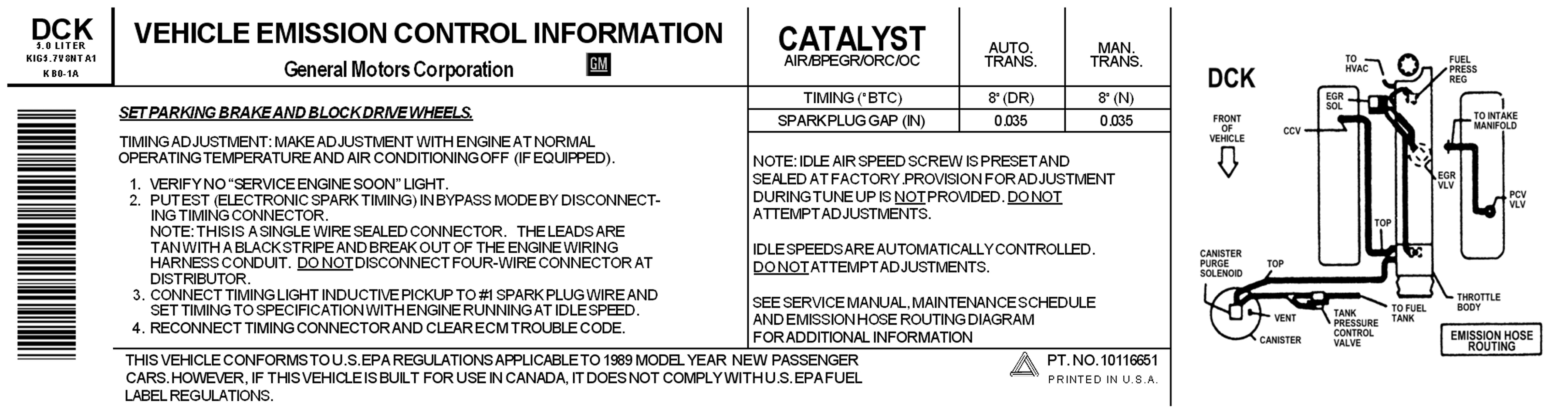

I found several decals images on google, w/ conflicting ignition timing specs. (8* VS 6* BTDC). Anyone OWN an 89 LB9 305 TPI, who could advise specs, on the decal? Maybe post a photo? The "If Built for Canada" is something I have never encountered, and as a former Service Manager, I have read thousands of Emission Decals.
My FSM and Haynes Manual, refer to decal, don't list timing specs. Thanks.

Not a convertible, but this is a 89 305 TPI Auto.

That's GREAT! Printed all of them, will ask my smog guy if he has timing specs and affix the appropriate label(s).
