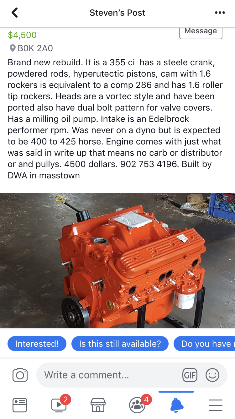

Built close by me by a very reputable Shop. What do you guys think of the components and price? This is in Canadian $$
I
cant stand the Orange and it’s not going to match my Blue IROC. So how much of a mission to strip all the paint and redo it Black.

No way. They can't spell and those don't appear to be Vortec heads. Maybe aftermarket IDK. They don't have the sawtooth pattern.
Also the price is ridiculous. Comparison with a Blueprint roller cam 383 w/aluminium heads:
https://blueprintengines.com/product...ock-bp38313ct1
And here's about the same thing in that listing for WAY less:
https://blueprintengines.com/product...lock-bp3503ct1

absolutely not
1)vortec "style" heads? wtf is that supposed to be?
2)cam is equivalent to something else means its a low end chinese soft cam so no
3)the very generous estimate is about 150 horsepower over what it would actually make
(a gmpp crate 5.7 vortec with a 0.47 lift cam makes 357 horsepower,this is not any better and may in fact make less than that)

what you need to buy is a vortec long block(crate engine) or complete vortec crate engine.
this thing has too many questionable parts and complete unknowns so i would say nay....

Thanks for the responses guys. And my plan is/was to buy the 357HP Engine in the spring.
Just seen it listed and was curious as to the quality of the build for the price.
and being in Canada, my prices are a lot more then anything listed in the USA.
The 350/357 Engine will cost me $5089.

check with summit,jegs,machine shops or performance shops near you or look at crate engines directly from gm.
the engine im building is basically the same as the gm crate engine :
sp350/357 (vortec (1996-1998 truck engine L31 5.7 with the gmpp 7151 roller cam,dynoed at 357 horsepower,410 ft lbs of torque)

$4500 for what is basically a stock rebuild?
No.............just.................no.

As far as the heads, they're probably EngineQuest 350 heads. Vortec Style kinda gives it away.
https://www.aamidwest.com/engineques...chevrolet-350/
https://www.castheads.com/cylinder-h...eq-imca-heads/
