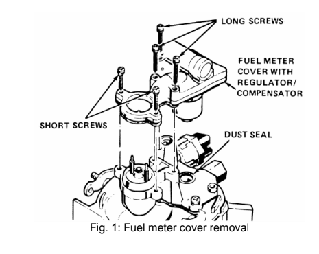

I talked to a SBC expert co-worker and he suggested replacing the fuel pressure regulator. That could explain my fuel flow but not having injection if the fuel is not pressurizing enough for the injectors to push it out. As far as I know the FPR has never been replaced. I suppose it could also be the Cam/Crank sensors but I would think the engine would still at least run without those just not very efficiently. I wouldnt think it is the ICM since I do have spark but I suppose I could have weak or misstimed spark. Again I am 100% certain that the fuel pump IS running I am just not sure if the pressure is building. At this point the plan is to pressure check the inlet into the throttle body to see if the fuel pump is building pressure and if it is not I am going to replace or rebuild the FPR. Luckily for me it is really easy to get to on TBI engines.
Underneath circled in red, that vaccum line was disconnected, not sure if it was part of the problem but I reconnected it to be sure, no change after reconnecting it.
FPR location for those interested, its the bronzeish part right behind the injectors:

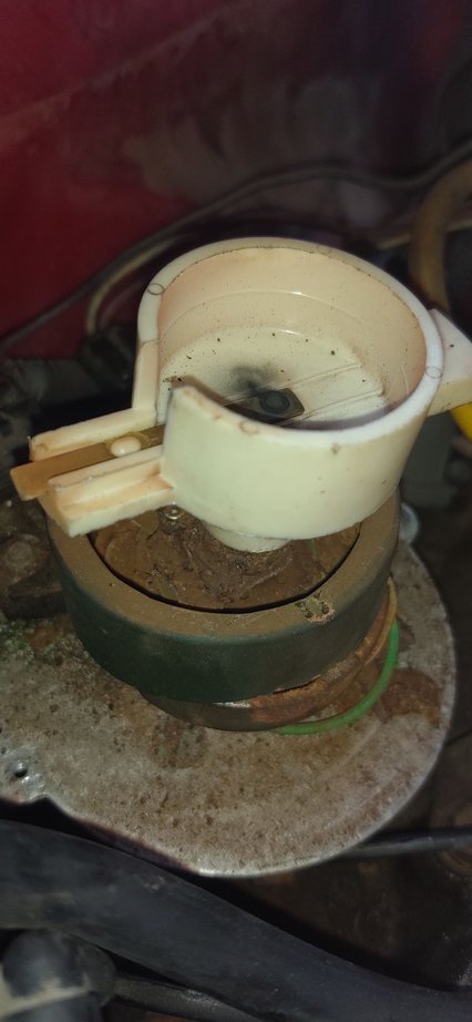

Well I found out what my issue was... I think the magnet at the top of the pickup pole disintegrated. A bunch of magnetic chunks fell out when I pulled the distributor cap off and the pickup coil is destroyed and the cover that is supposed to be over the pickup coil rotor is also all messed up. Can I just replace the pickup pole? how does that come out? Or should I just replace the whole distributor at this point? I will have to do timing and if I replace the distributor wont I?
Old Sep 20, 2019 | 04:33 PM
Tanker_01's Avatar
Joined: Aug 2019
Posts: 31
From: Southern Indiana
Car: 1988 Camaro Sport Coupe
Engine: 305 cid
Re: Engine shut off while driving, will not start now
Ok I did some research and it looks like at this point I might as well just get a new distributor. Is there a difference between a distributor that says its 'electronic' and one that is listed as 'pick up coil'? Will either work in my car? Are they both the same?
Old Sep 21, 2019 | 04:31 AM
J.C. Denton's Avatar
Joined: May 2008
Posts: 417
Likes: 82
From: Viersen, Germany
Car: 85 Iron Duke, 88 GTA and 92 TA
Oh my... yes, you need a new distributor. That thing look terrible. I recommend the Cardone or the Spectra Premium from Rockauto. They are cheap and both work fine in my cars.
Old Sep 21, 2019 | 09:18 AM
Posts: 28,030
Likes: 2,500
*shaking my head*
Old Sep 21, 2019 | 09:36 AM
Dyno Don's Avatar
Joined: Mar 2000
Posts: 5,713
Likes: 133
From: Orange, CA
Car: '90 Trans Am-12.45@110.71
Engine: 355 w/AFR 195's Elem. 400/430 HP/TQ
Transmission: Tremec T-56
Axle/Gears: 12 Bolt 3.73
If you never went to the dizzy you wouldn't have found the problem.
I too, had one like that and it still ran.
When I remove the dizzy it fell apart too.
Old Sep 21, 2019 | 11:23 AM
maks10's Avatar
Joined: Jul 2009
Posts: 523
Likes: 103
From: Morgantown, WV
Car: 1990 Trans Am
Engine: 5.7 350 HSR afr195 xfi268
Axle/Gears: 3.08 posi
Forgot to mention, I don’t think I’ve ever had a scenario where sofa was incorrect. Thanks for the knowledge and Info!
Old Sep 23, 2019 | 09:40 AM
Tanker_01's Avatar
Joined: Aug 2019
Posts: 31
Engine: 305 cid
Ok so when I replace the whole thing I know I have to put the new one in the same position the old one comes out. What is the best way to make sure it goes in correctly? Should I put the rotor back on and put something straight on it and make a mark somewhere in the engine bay to line up with? Do I absolutely need to turn the engine until #1 is at TDC or do I just need to put it back in the same position?
I have a timing light I can borrow from a buddy and I have a good idea of how to do the timing as it isn't super difficult to do. But when I do the timing should I have the air cleaner installed so my airflow is correct or can I do it without the air cleaner?
Old Sep 23, 2019 | 09:44 AM
Tanker_01's Avatar
Joined: Aug 2019
Posts: 31
Engine: 305 cid
*shaking my head*
You were 100% right my man. If I wasn't new I would have known to listen. Now I know!
Old Sep 23, 2019 | 10:17 AM
thtanner's Avatar
Joined: May 2015
Posts: 1,154
Likes: 89
From: Temecula, CA
Car: 1989 Pontiac Formula 350
Engine: L98
Axle/Gears: BorgWarner 3.27 Posi
Just put it back in the same position. Note the bottom of the dist gear the notch and turn it the same way - its for the oil pump and the dist wont seat without that being right, too.
Once its ballparked fire it up and time it.
Old Sep 23, 2019 | 11:46 AM
Posts: 28,030
Likes: 2,500
Yup, put it in where it sits.
Be aware that the shaft turns about 30 degrees or so, CCW, as you pull it out. Do the whole job with the rotor on, and note where it turns itself to as you pull it.
The good thing about the Interwebz is, you get to profit from everybody else's mistakes and school of hard knocks, without having to make them yourself.
