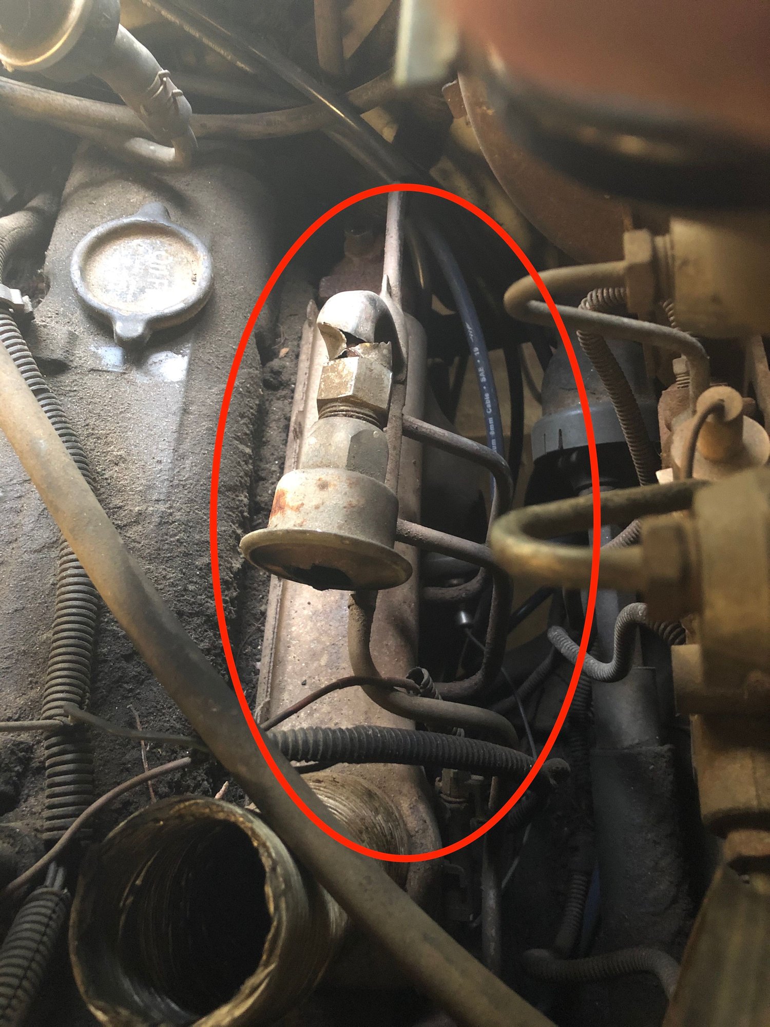

Ok, I did a little disassembly and found something a little disconcerting. Would this happen to be a reason why it could've died?

No it wouldn’t cause stalling. It would cause a exhaust leak
