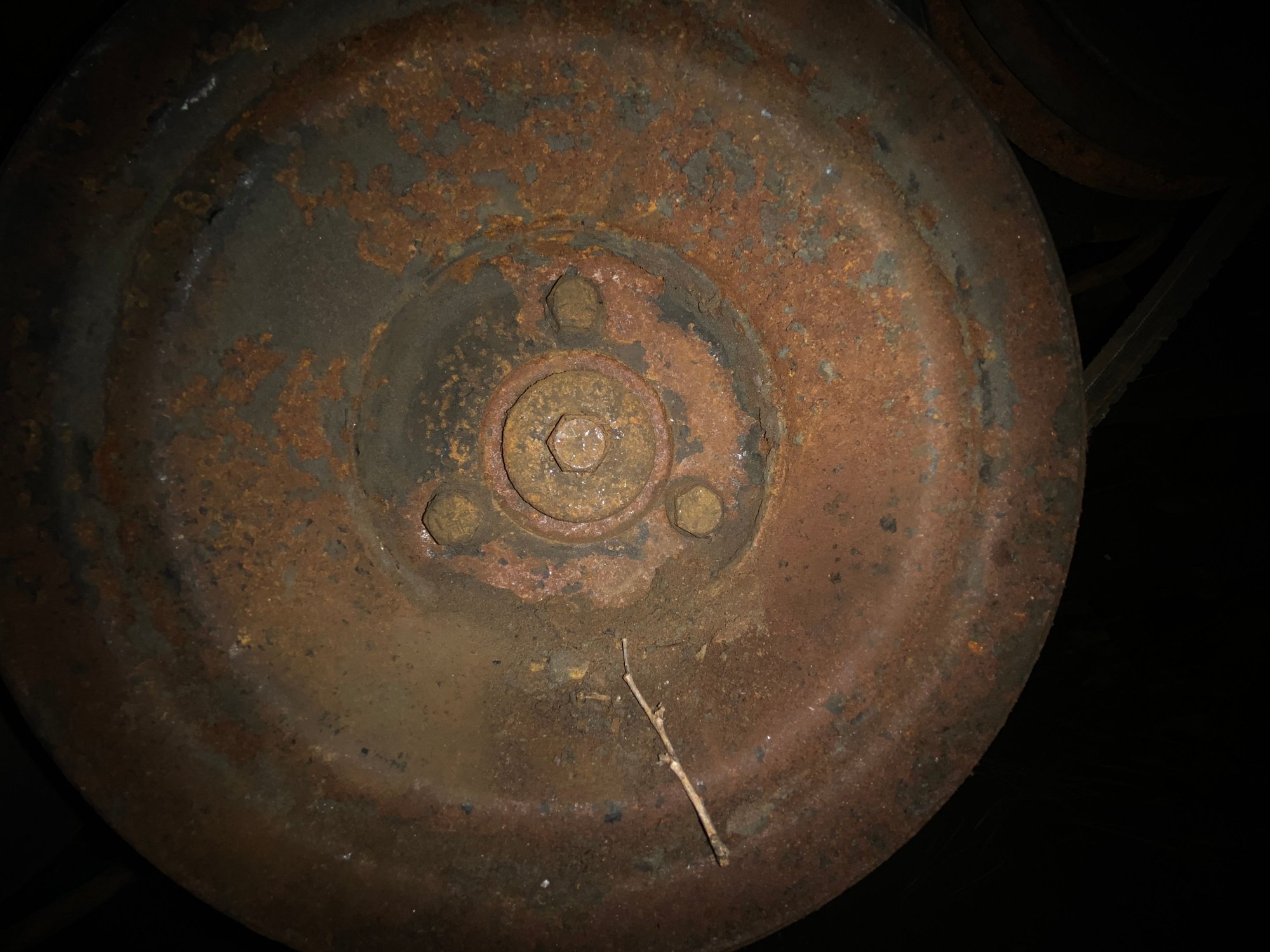

Can anyone advise if I am doing something wrong here?
I am trying to hand crank the 305 CFI in my 83 Z28 so I can find TDC on cylinders #1. When I get the 5/8 inch socket around the camshaft bolt, the engine wont crank - it gets tighter when I rotate it right, and the bolt loosens when I turn left.
What am I doing wrong?
