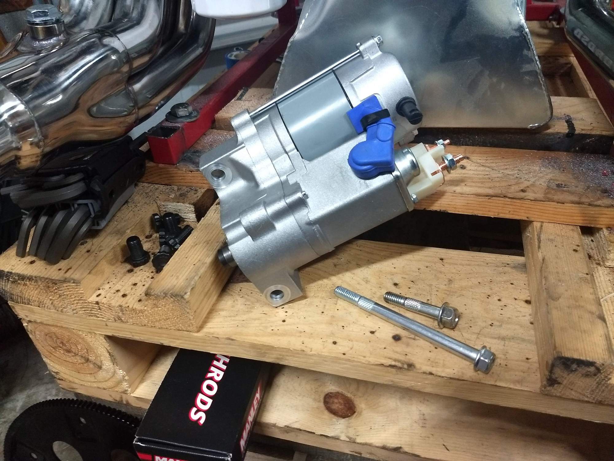

Re: Starter - What's The Difference?
Here is a pic of a starter I chose for my 383 build. It's from a 1996 Corvette, made by Remy. Hope this helps to motivate you in the right direction!
BTW, I'll be making a video soon. Original 3rd Gen starters sound like garbage, direct drive and all that inferior sh*t.
