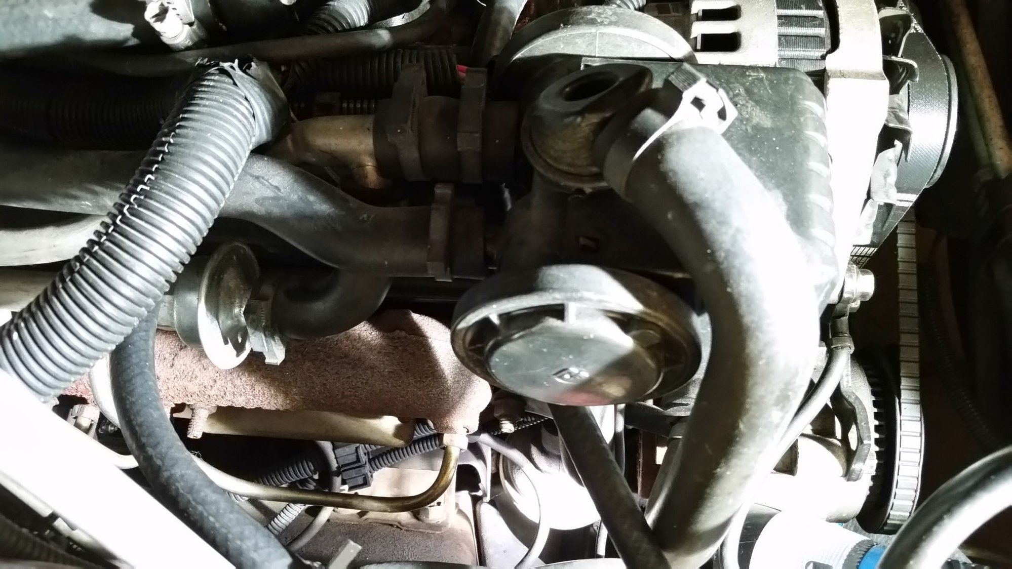

Can anyone tell me how to replace the mechanical fuel pump on my 87 Trans Am 305 engine. It looks like it is not easy to get to very little room to get to the 2 bolts actually they can't even be seen. What needs to be removed to make it easier
.Does the smog pump assy need to be removed

You don't have to take off anything. The 2 fuel lines, and the 2 bolts.
VERRRRRY EEEEEEZY to do from underneath. You can see it, get to it, get tools to it, everything.

The fuel pump has a lever and that lever needs to be placed IN FRONT of the Fuel Pump Rod.
The Fuel Pump Rod touches the camshaft on one end and the Fuel pump on the other.
When installing the Fuel Pump you will need to be sure that the Fuel Pump Rod is pushed up/inside the engine as far as possible.
MANY MANY times the Fuel Pump Rod will NOT stay pushed up/inside the engine and will fall to it's lowest position and will 'block' the Fuel Pump from mounting properly.
If the Fuel Pump Rod will not stay up/inside the engine there are 2 "tricks" that might help;
1: Apply some grease to the Rod and then push it up/into the engine. use only as much grease as you must in order for the Rod to stay up/inside the engine.
2: Remove the smog pump,....... one of the smog pump mounting holes on the block is an access hole directly leading to the Fuel Pump Rod. You can insert a screwdriver into this bolt hole in the bock it push against the Fuel Pump Rod to hold it in place as the Fuel Pump is mounted. ( Lever in front of the rod ). This is a TPI block,... no Rod needed, 'access' bolt-hole circled.
It's easy to get frustrated with that Rod if it doesn't co-operate when your on your back and can't see anything. You don't want to go "crazy" using Grease,....... ONLY as much as needed !! It WILL work if done right,... If grease doesn't work for Ya' then you could always remove the SMOG pump. I prefer to remove the SMOG pump right from the start; a few extra minutes of easy work from the top is better IMO than an hour workin' around stuff - and with my luck -----> That Fuel Pump Rod would fall in the way and block that lever EVERY TIME !!!!
