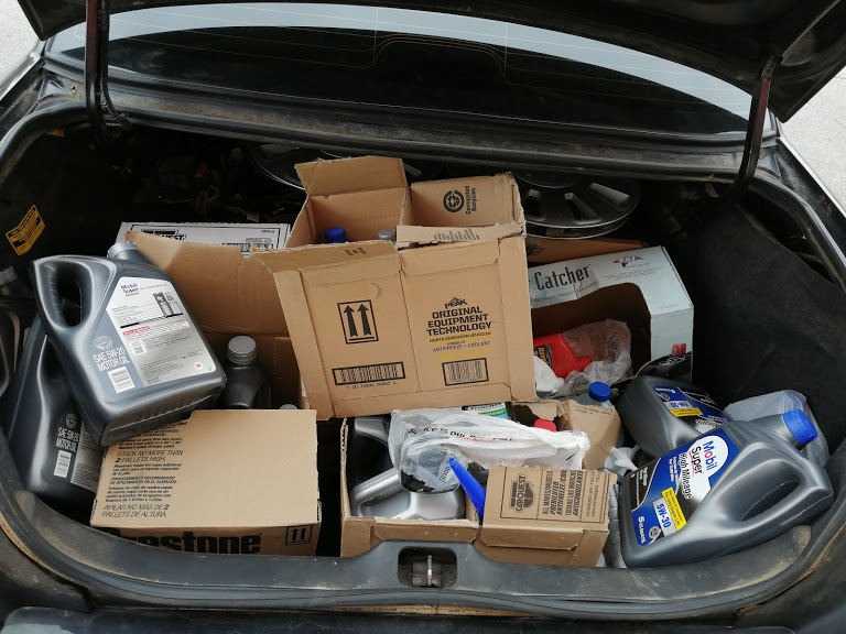

Ya those are gone FAST !!! I hit several auto zones in Dallas metro and all wiped clean of the Mobil 20K Annual protection.
Try advance auto parts they have Mobil super synthetic 10W30 5 qt jug for $3.75
Here's the trunk of my crown vic after hitting several Advance auto parts stores last week
Dave
