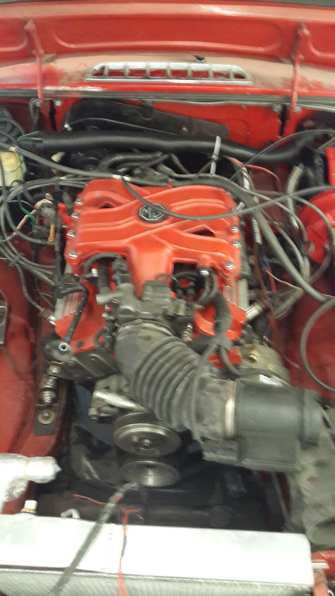

this is the car and I can quite well spelling a whole dif game

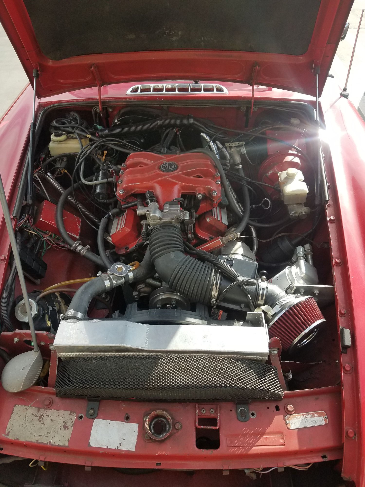

ran the 2.8L for 6 years replaced motor with an bored fiero motor having tons of trouble now. car runs good with the MAF disconnected. it is a transplant from an 86 Firebird

What are you doing for an air cleaner? Managing airflow into the MAF is critical to MAF accuracy. Having it laying open as in the photo could be part of your trouble. Be sure to check your circuits. The MAF sensor needs 12v from the relay, a good ground and signal path to the ECM. In your installation, I don't know that the Camaro MAF wouldn't work okay.

I like the ingenuity of putting the MG logo on the upper manifold , looks good .
And I'll bet that putter hood (Bonnet in the car's native language) prop isn't an approved Morris' Garage accessory ? .... !
