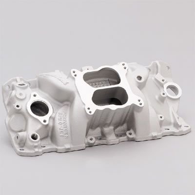

I picked up another Weiand Stealth- an older, "pre-stealth" model numbered 8004, but it's NOT the 8004 Action Plus, to replace my 8016 squarebore Stealth. I decided the 8125 and ZZ4 intake would be too 'small' for the shortblock I'm building this spring. That decision answered the question for me I suppose.

Figured I would circle back here and report on how the jet performance qjet worked out. So far so good. I literally finished installing it an hour and a half ago. I ended up losing my timing because I had to change out intake manifolds and Murphy's Law loves me. Very frustrating to say the least. First drive from backing out of the driveway and putting her back on the street was much more responsive, smooth and torquey. I did not mess with a single adjustment on the carburetor - all I did was bolt it on, try and get the timing set again, and start it up.
Maybe this week I will get a chance to make adjustments, but she's too loud/dim with blackouts to drive with how late it is and my wife is not going to be too happy when she gets home and finds out all I did all day long was get her trailblazer ready to sell, and "fix brakes" on the Z28. That really means change the intake and carb over and run to town a couple times for vacuum caps and fresh 3/8 line. I did check and add some brake fluid
BTW, it all fits under the flat hood with the L69 cleaner!
Old Weiand 8016 Stealth
Jet Performance quadrajet
New to me Weiand 8004 Stealth

The Weiand STEALTH is an awesome intake, but it is square-bore so it does not work with a Quadrajet.
I don't know the details for your new shortblock, but if you plan to use this same carb, then consider the #7104 Edelbrock Performer RPM QUADRAJET.
Nice setup you have there. It's what I will be doing to mine.
Old Feb 17, 2020 | 10:07 PM
Both the old intake and new are Stealth. The new one is when they had one of several identity crises...
