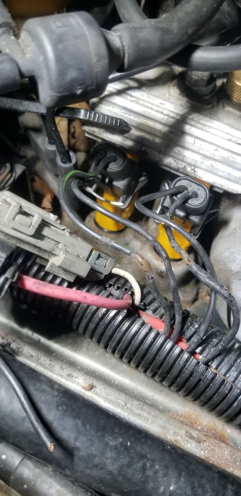

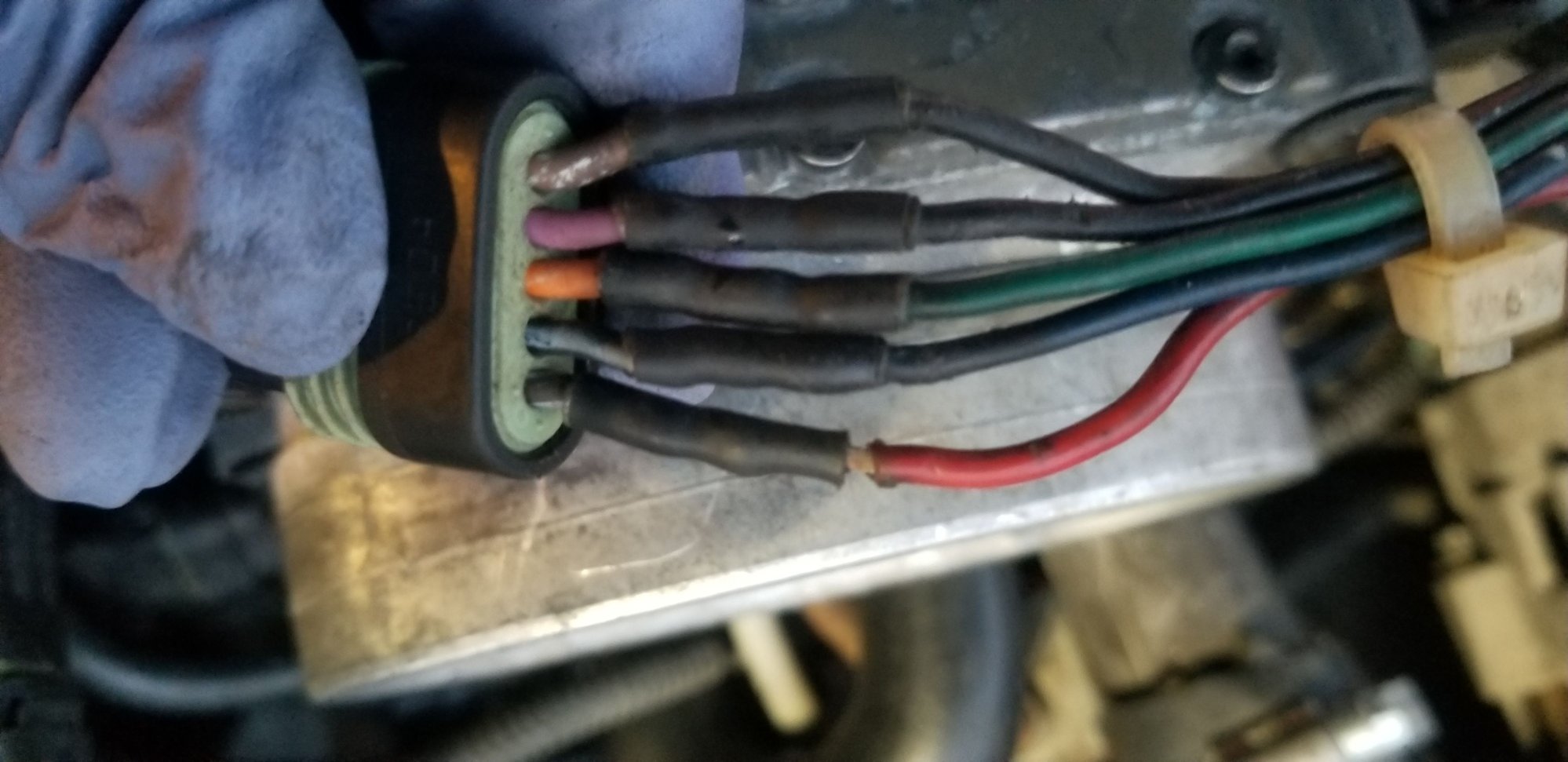

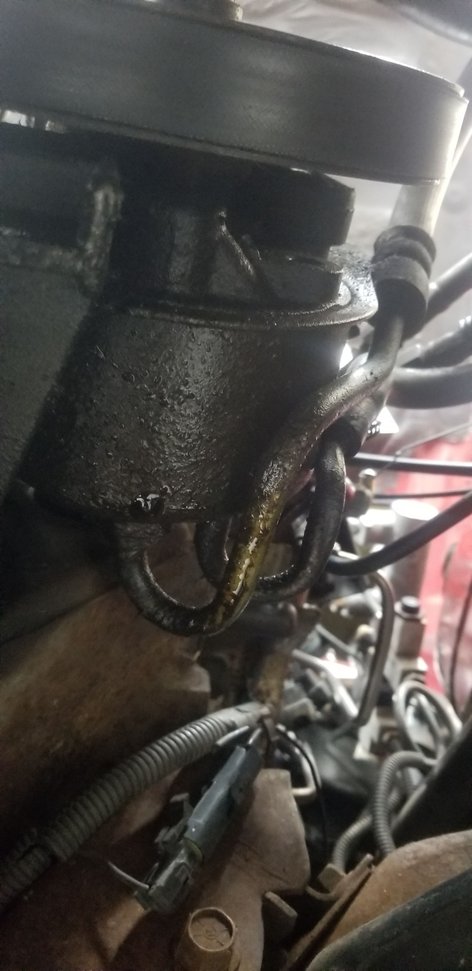

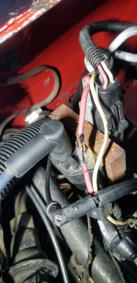

Here are some pictures so you guys can sit back and feel for me...

1. You can buy injector pigtails from any number of places, since people need them for swapping among the various connector styles. I'd suggest starting over with fresh, given how … experienced … those look.
2. That's the main power feed to the coil. Might be a good idea to clean that up.
3. Noooiiiiice… can't tell what wire it is though.
4. If that's the FP relay connector, might have something to do with why it doesn't prime. The wire colors on the connector side of the improvement look like that connector was off of a blower high-speed relay. Not that it matters a whole lot in and of itself, except that they might, or might not, have got the right wires hooked up to the right pin of the relay. The wire colors look more like that's the wiring for the MAF (misshapenly labelled "mass air flow relay", right below the ACTUAL mass air flow relay, on Orange's FSM schematic unfortunately) though. What's it plugged into?
5. The single purple wire should be the O2 sensor... not sure what the others used to be.
6. Not sure what to think there.
Knock sensor problems won't prevent priming. A prime problem is almost certainly something related to the relay; the relay itself, the ECM, the batt feed, etc. Eeeezzzy enough to check; the dk grn wire at the FP relay should go to 12V during the prime cycle and drop back to 0 afterwards, the org wire should have 12V on it at all times, and the tan/wht wire should get 12V during prime also, from the relay contacts.

1. You can buy injector pigtails from any number of places, since people need them for swapping among the various connector styles. I'd suggest starting over with fresh, given how … experienced … those look. Yes going to do that
2. That's the main power feed to the coil. Might be a good idea to clean that up. Yes, doing that
3. Noooiiiiice… can't tell what wire it is though. I THINK they are the grounds that were bypassed at the ECM
4. If that's the FP relay connector, might have something to do with why it doesn't prime. The wire colors on the connector side of the improvement look like that connector was off of a blower high-speed relay. Not that it matters a whole lot in and of itself, except that they might, or might not, have got the right wires hooked up to the right pin of the relay. The wire colors look more like that's the wiring for the MAF (misshapenly labelled "mass air flow relay", right below the ACTUAL mass air flow relay, on Orange's FSM schematic unfortunately) though. What's it plugged into? That is the MAF connector that plugs into the MAF
5. The single purple wire should be the O2 sensor... not sure what the others used to be. Yes, just leaks everywhere!
6. Not sure what to think there. Rear main is leaking badly
Knock sensor problems won't prevent priming. A prime problem is almost certainly something related to the relay; the relay itself, the ECM, the batt feed, etc. Eeeezzzy enough to check; the dk grn wire at the FP relay should go to 12V during the prime cycle and drop back to 0 afterwards, the org wire should have 12V on it at all times, and the tan/wht wire should get 12V during prime also, from the relay contacts. Where is the fuel pump relay located?
I will look into the prime. That is my next thing to fix. I have it running great after a couple seconds. Priming would surely fix that issue.
Thanks again

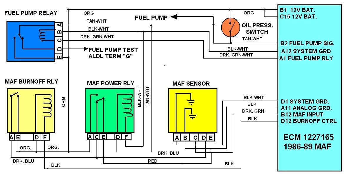

So, came home to crank it..... fan came on immediately . UGH. Guess I have to troubleshoot that more now(test to confirm ecm is signaling it on.. I'm thinking, since it's running much better, of wrapping up my loose ends and sending it back to the owner for now. New Maf and speedo fix are coming as well, but it's so butchered it needs a new harness...or a lot more time in it.
While it was running, this relay was clicking rapidly...almost buzzing. Anything above idle it stops that.
Its at the firewall near the brake booster.
Any help on what this relay is for?

It’s either fp or one of the maf relays. Looking at how fried and corroded it it it took a heavy amp draw. This usually happens to the fp relay.

It's the one for the FP relay.
Only way it could "buzz" or "click" is if the ECM is telling it to. The question then would be, why is it doing that.
Check the voltage at the dk grn / wht stripe wire while it's doing that. It should of course hold pretty steady at all times that it's being commanded; probably within a couple of tenths of a volt of batt voltage. If it seems to drop a whole bunch while it's "buzzing", put your DMM on AC instead of DC, and see if it reads anything. If it does, check the voltage at any convenient pink/black wire, and at the orange wire (the high-current batt feed that gets switched to the pump) in that connector, and see what they're reading at that time, both AC & DC. You may have an alternator prob... ummmm, opportunity for a solution.

Gauge shows 14-15 volts at idle, almost too much IMO. Will look into it more this weekend. I do think I am on the right track as this is the FP relay and we have pump priming issues.
I may repin or extremely clean this connection as well. It looks pretty rough. Still think I am close to finishing some details and sending it.

Don't bother with the gauge. Use real instruments. Measure the voltage at those places and see at a deeper level what's going on.
Cleaning up etc. is always a good idea but it probably won't make any difference.

Well, owner got the car for now. It stopped advancing timing and priming again. I didn't have the time at the moment to dedicate to checking the entire harness. Some tests pointed to the Ignition module, but using a known good one made no change Tan wire and white wire both tested fine per the flow chart in the manual. When it throws the 42 the fan also runs continuously. It has to be something stupid in this wiring harness somewhere. The CTS and MAF did alleviate those codes, so some progress.
FWIW the relay that should be going to the FP is not. Unplugged it and the car continues to run.
Very confusing, so I was all over the place. may try again with it in a couple months, but I kind of hope not. If I do, i will update this thread.
