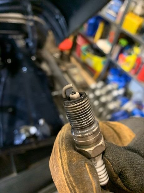

2) plugs were more white than I would expect, I'll post a pic tomorrow, we pulled two and both were somewhat white-ish (so lean?) , they are the iridium kind gapped properly (we checked).

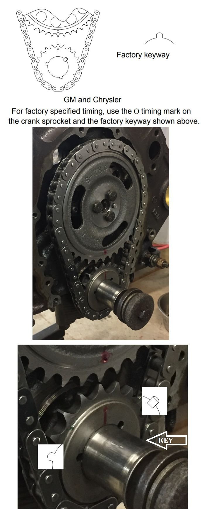

Mmmm. How sure are you you got the timing chain on exactly right?

speaking of the plugs.. here's a picture of one we pulled.
Old Feb 29, 2020 | 06:49 PM
NoEmissions84TA's Avatar
Joined: Feb 2017
Posts: 4,185
Likes: 576
From: Meriden, CT 06451
Re: Newly built motor, complete lack of power and out of ideas
Originally Posted by zracTA
I'll find out on the 1-3, but for
4) his carb has an electric choke but it is still disconnected and not wired up, I didn't think that would matter but could it? once the engine warmed up it idled fine but of course without a choke when cold it wanted to stall (and did)
5) we can try that, but I believe the gap for those specific plugs was the .060
Wire the choke fully open for now. The choke plate will try to stay closed while cold, and without a +12v source, it will not heat up properly. Most likely the plate will be flopping around somewhere between ON and OFF. This is not what you want while troubleshooting problems.
The plugs might have been made with a .060" gap, but unless the ignition system has an added on aftermarket amplifier "box", a stock ignition can have a hard time firing that large gap. GM spec'd that gap in the early days of HEI, and later brought it back down to around .045".
Always use anti-seize on those plug threads.

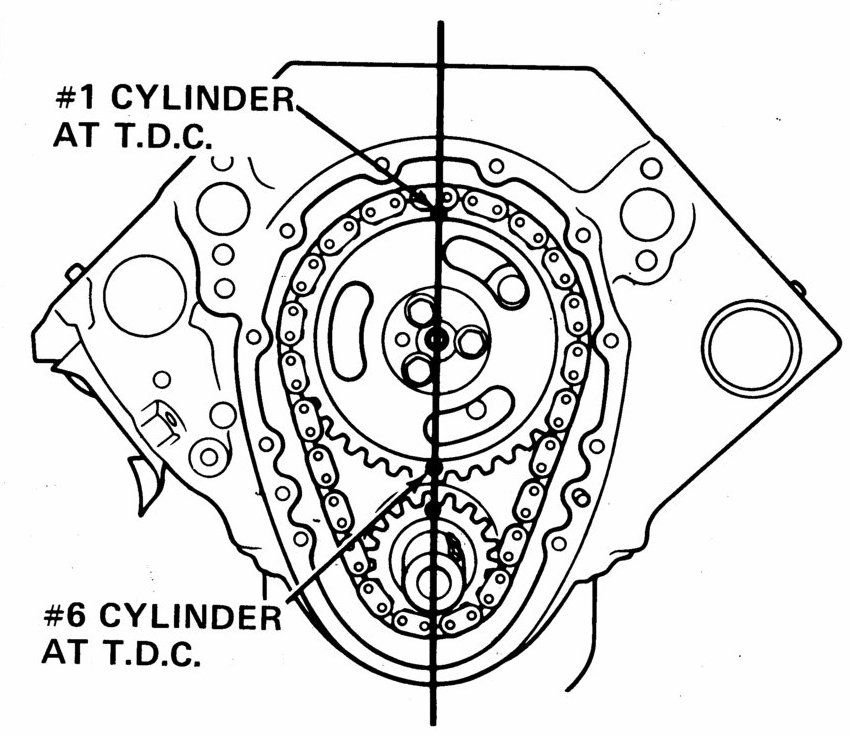

When I lined mine up a month or so ago, I had to be very careful. It was pretty easy to get the cam off one tooth without noticing. I used a straight edge and checked it like three times.

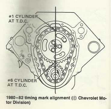

For all that don't already know, for SBC, aligning the timing marks dot-to-dot is actually #6 firing.
Which is also the reason that so many can't understand how they got the distributor 180 degrees off when they first fire the engine and "something is wrong".
If you align with the cam gear dot at the top of the gear (#1 firing) and double check with a straight edge, it is easier to see that you could be 1 tooth off.
If you don't like this method, you could always align the conventional way, then rotate the crank exactly 1 turn. Then do the double check to verify.

Interesting. I did not know about the third mark. That makes it much more clear then. I'll bet a cam off 180, the engine won't even run, but one tooth, its can act weird.

There is not a 3rd mark. It's the same dot, either on the bottom (#6 firing), or at the top (#1 firing) for the cam gear.
The dot on the crank gear is in the same spot for both conditions.
Ah. Too bad. That would be excellent instead of finding a third point on the block. One thing I was worried about was that my straight line between the two marks would not be perfectly vertical to the block axis and off one cam tooth and I wouldn't notice easily.
Yup. With the 2 dots so close together when they are pointing at each other, it's easy to be off 1 tooth, even though it looks correct.
By checking alignment at #1 firing, your straight edge needs to be going right through the center of the crankshaft and camshaft (and the 2 dots).

those plug straps look good to me... if it idles that well I think you have a different issue:

I am the friend zracTA is helping. Thank you for welcoming me in and for your time/input to date. Also, thanks for your patience while he and I pull together the data you're requesting and for your future patience while we investigate and test amidst our crazy daily schedules. I am confident in my abilities, but making mistakes is certainly within the realm of my abilities as well! If something wasn't wrong, this thing would be breathing fire.
Next courses of action: Compression test on a minimum of 3 cylinders, balancer "0" mark verification (#1 piston stop method), int/exh valve action verification on #1 & #6, dizzy rotor positioning at #1 TDC
I've tried a few times to post a pic of the timing set installed. Will keep trying.
I think this worked ...
Old Mar 4, 2020 | 01:00 AM
Joined: Feb 2017
Posts: 4,185
Likes: 576
Hi 13lifecrisis,
OK, I will buy that. The timing gears look to be aligned correctly.

I think you might be off half a tooth. In the pics, the gear teeth tips are together, but the index marks are not on the tooth-tips. I tried to envision moving the cam gear one tooth clockwise and, from the pic, I can see the index marks lining up better than in the pic.
Old Mar 4, 2020 | 01:40 PM
13lifecrisis's Avatar
Joined: Mar 2020
Posts: 6
I think because the dots are stamped into "raised" material on the gears and my picture is taken at an angle, the dots don't appear to line up with teeth. However, I've confirmed on the Cloyes site that the dots on my 9-1157 set do line up with teeth. If compression testing and valve positioning at TDC reviews tell me I have an issue with timing, I'll tear this thing down.
