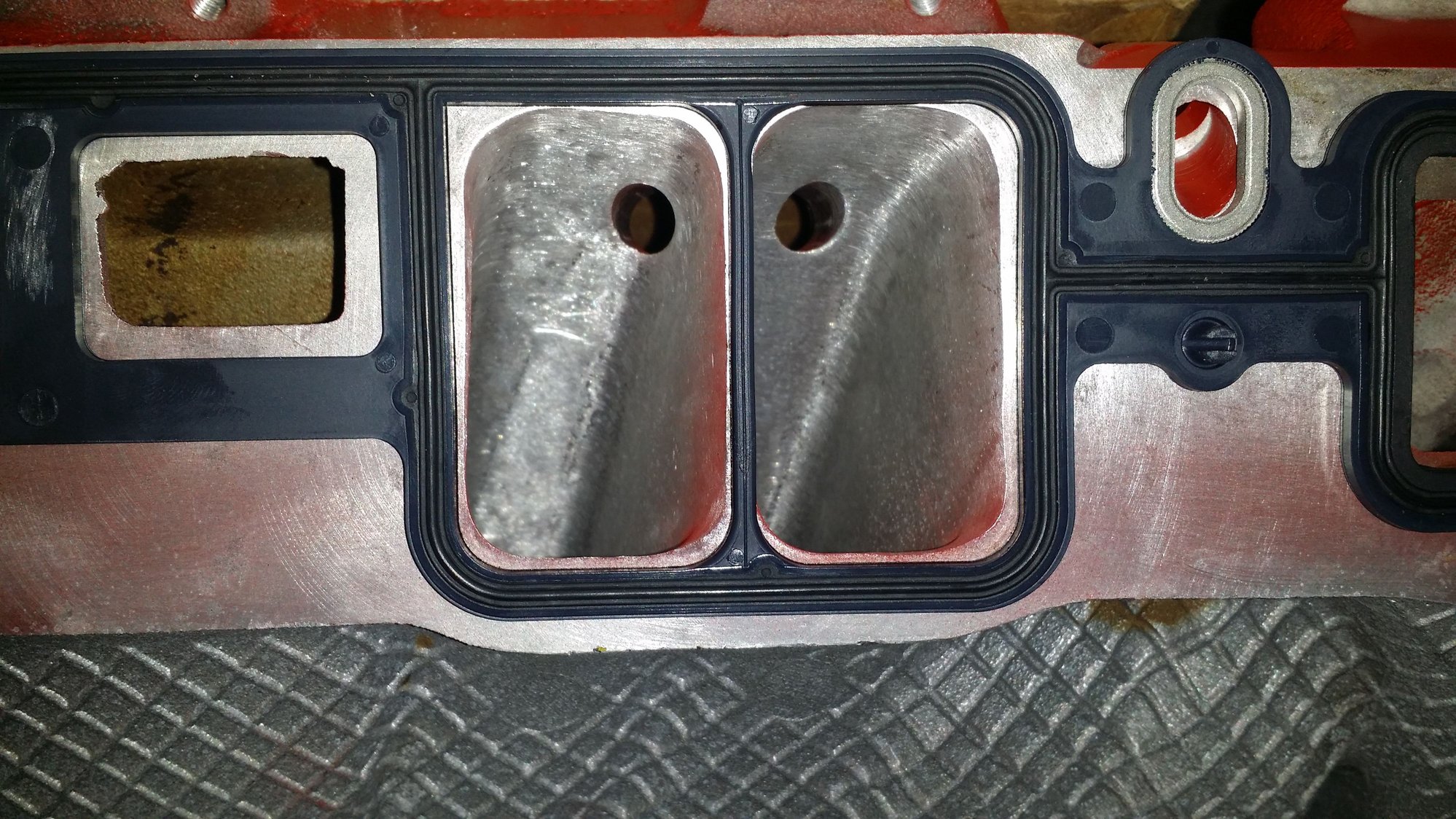

Rhoads V-Max lifters make a little more noise but make a massive difference in low-speed, off-idle torque as well as idle quality. 218/228 @ 0.050, 110 lsa cam, 106 ICL with 0.578 lift from 1.7 rockers in my 11:1 383​​​​​​. Idles at 750 rpm with 4* of timing advance with 16 in/hg. 4* initial timing, 26* total at 3,000. Ran on the stand with a carb. Have not even touched the idle mixture or speed on the Edelbrock 1406 600cfm carb that has been sitting on the shelf 3 years since it came off a 5.3. Would have idled better dialing in the carb and running a vacuum advance but the carb is about to come off and EFI about to take its place. Only ran it to check for leaks and to hot lash the valves before it gets dropped back into the tan Express van sitting in front of it.
Microphone on my phone is picking up the valvetrain about 2x as loud as it is and the exhaust about 1/2 as loud.

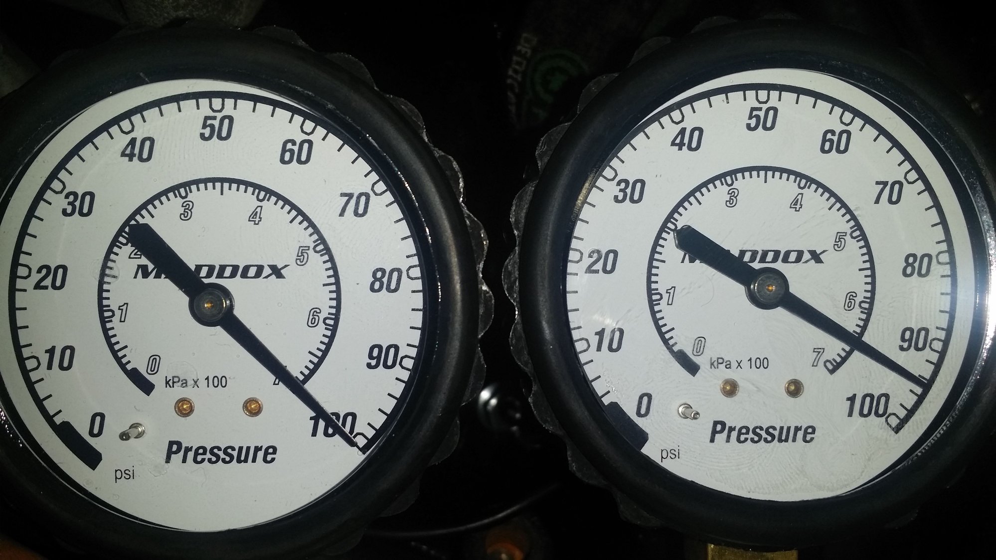

I played with the valves a little more (getting better in technique again like I once was) in the current 383 setup, hooked up a vacuum advance and got it some decent idle timing. It is idling at 24° timing advance now rather than 4°. I varied the idle timing from 20 to 30 and it seems to like 24-26. Now makes 210 psi cranking compression in every cylinder. Stock GM Vortec roller lifters with 1/4 turn lash gives 195 psi in the cylinder I checked. With the Rhoads lifters hot lashed to 0.020" it makes 19 in/hg vacuum at 700 rpm and 24 in/hg @ 2,500 rpm with no load. A throttle snap on the primaries to just before the secondaries open results in very quick throttle response and the vacuum holds at 10 in/hg. It is scary how fast it revs even with a carb. With a 600 cfm 1406 edelbrock it is super responsive. 40 psi oil pressure at hot idle with 5w30.
Out of emissions necessity for visual inspection, I am going back to the L31 truck manifold. Heavily ported with an E85 compatible 48 lb/hr fuel spider and having to re-enable the EGR atleast for inspection purposes. I am hoping it might be a little more fuel efficient as well with the spider spraying directly on the back of the intake valves rather than the intake port floor like it does on the marine intakes. If it gets better MPG with the EGR will probably leave it enabled as well and then use GM top-clean before every oil change to keep the oily, carbon out of the plenum. At 2,850 rpm @ 70 I am sure a little EGR could help cut the pumping losses and drop the cylinder temps in lean cruise without making a noticeable power loss.
Leak down test, short block has about 15K on it so far. Every cylinder was practically identical. With the Marine dual plane MPI intake and a 232/244 @ 0.050 cam this engine has already pulled my travel trailer from Fort worth, Texas to Durango, Colorado and back without missing a beat. The smaller 218/228 cam has more grunt in my normal RPM range.

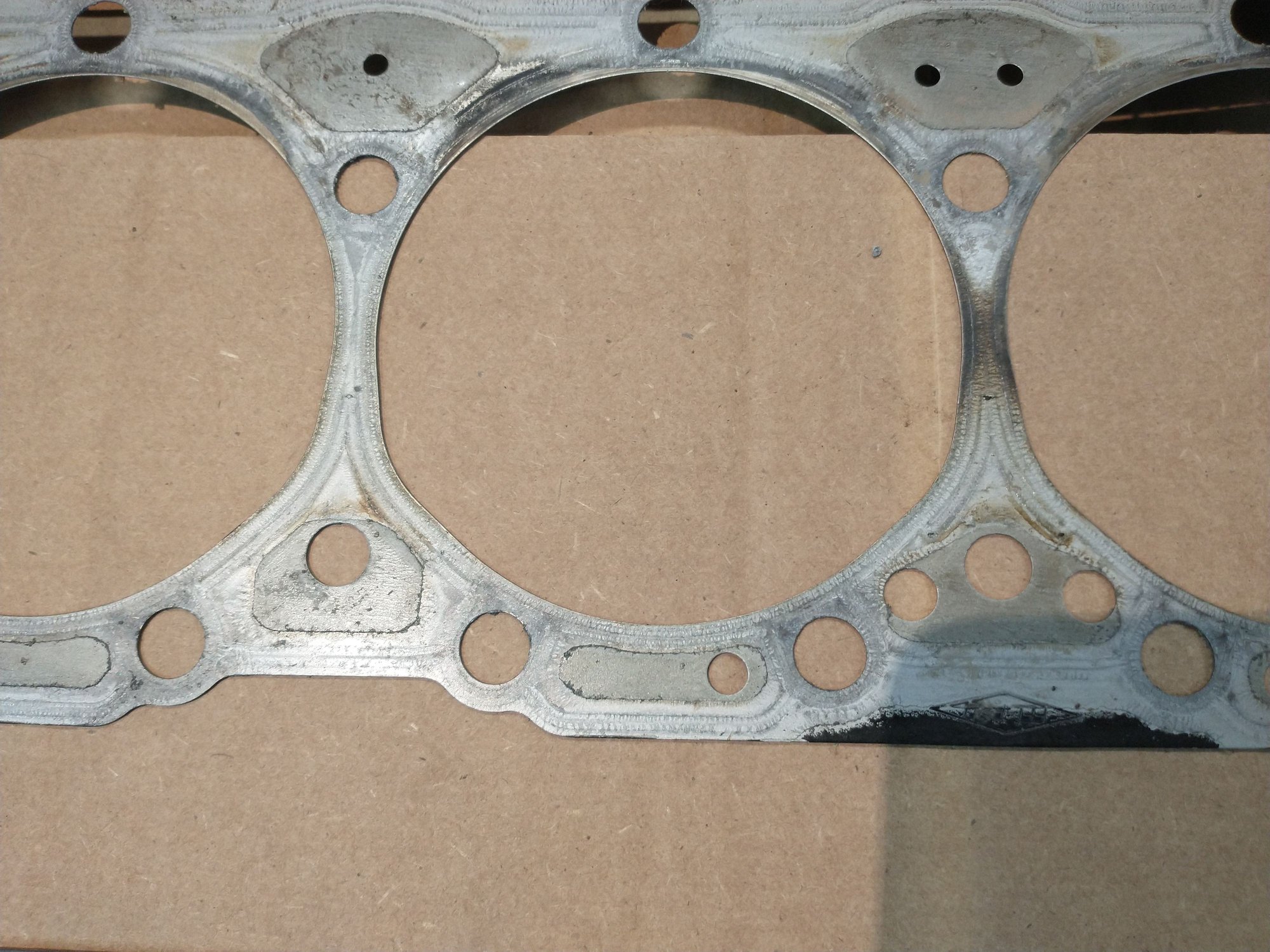

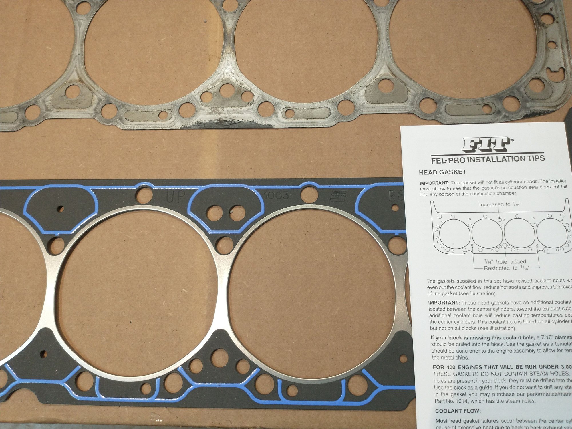

So I got the AFR heads and the gasket recommended by AFR for installation of said heads and I ran into an interesting bit of information with the included instructions on the new Fel-Pro gaskets.
They say in the instructions that came with the new Fel-Pro gaskets that there have been revisions to the gasket coolant port sizing due to the propensity for the gaskets to fail between the center two cylinders (exactly what I experienced) because of the center cylinders having the exhaust valves being adjacent to each other.
In conjunction with my ignition timing malfunction - which locked the timing to 10 degrees all the time, I think the lack of coolant flow between the center cylinders and the timing malfunction is likely responsible for the failure I experienced.

The timing issues exacerbated the head gasket flow problem it seems.
The Vortec heads appear to have survived.
However - I got it all back together with the AFR heads, etc and there was still an enormous amount of crankcase pressure. Tore it all back down and found 4 pistons with broken ring lands. The top rings lost their tension also. It did have correct ring gaps when assembled but likely the extreme combustion temps caused the end gaps to close up and broke 3 pistons on the driver's side, and 1 on the passenger side. Cylinder walls are fine as were the rod bearings, etc.
Forged pistons and scat rods are here and ready to go in today. I'll have it running again soon.
GD
Wow.
Good thing you were able to save what you did.
