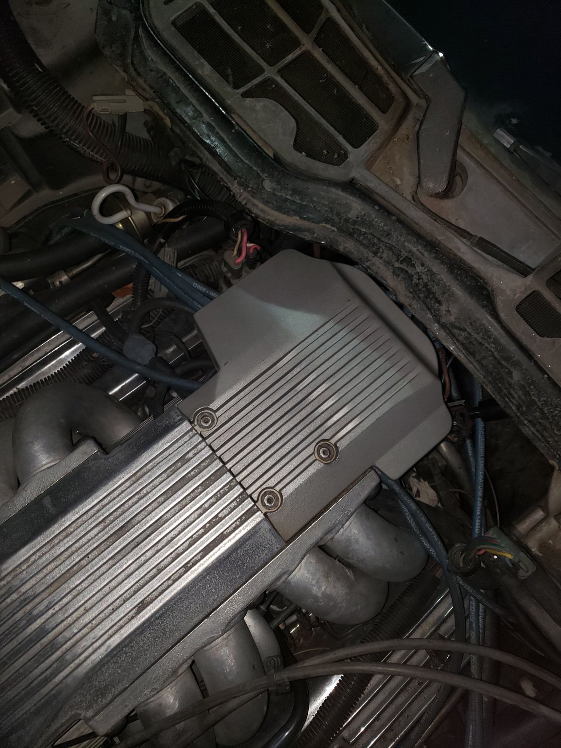

What size bolts are these?
PO removed when swapping the cap and wires but never installed cover back on because he lost the bolts. Anyone have any idea what size they are?

Probably metric. Probably dealer item.

Definitely metric. The whole plenum is metric. Guessing an M3. I can't currently double check for you.

Well it looks like it a special bolt and bolt supply places will not have it unless you want it to look different than the rest. It's either going to be a junkyard find or pay the price and buy them from the dealer. There's also ebay etc but it may be a while before someone even lists them.

It's just a beauty cover, wouldn't bother spending ridiculous money on GM bolts. Your local Ace hardware likely had a good enough bolt & washer selection to get the job done. Link below said M4-0.7 x 10mm. Start there and see what happens. Adjust as necessary.

If they are the same as the plate on the throttle body as mentioned in a link above they are M4, not sure on length, 10mm should do it.
