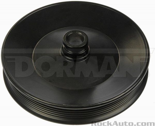

Also I will definitely need a pulley. Should I buy one of these?
ACDELCO 12605677
or standard replacement:
DORMAN 300200
No additional info on that Delco one. Anyone use either?
