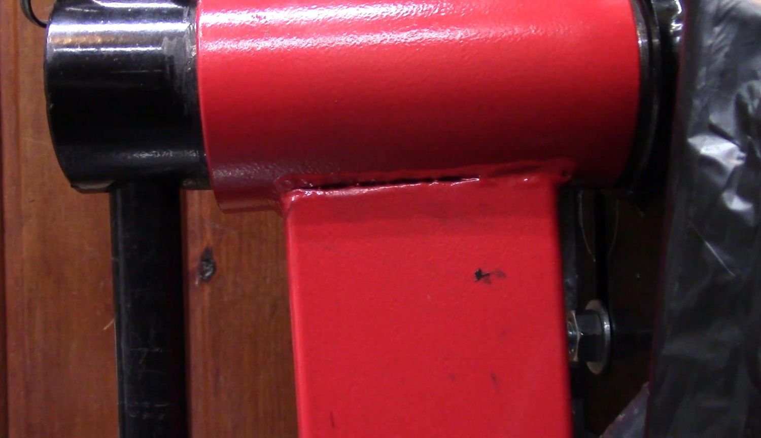

Think every 3 leg I've seen leans and why I've never owned one. First stand I bought was USA made found it at my local SAM's but they don't carry them anymore, wish I bought more. I got three HF four leg stands, they are ok but the last one I got wasn't made right and I had to weld it together, plus it came with a dinky handle. LOL almost forgot I made a video bout the handle extension. Also before I forget I found a big welding flaw(theirs not mine) on that same stand after I dropped something, so need to fix that when I get a chance. I'll attach a pic, can't rem if it's in the video, i just rem it was while working on a vid and I upload a short vid to FB
