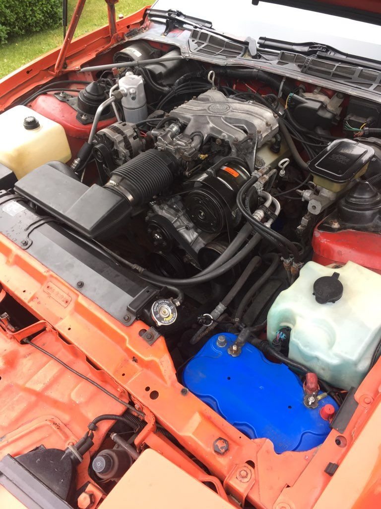

Aw , didn't mean to hurt your feelings , I was just havin fun with the whole mighty V6 thing .....
Us V6 guys gotta stick together , after all WE know the size of our weenies ain't tied to how many cylinders our cars have

I figure if we can't be fast , we can at least be clean
