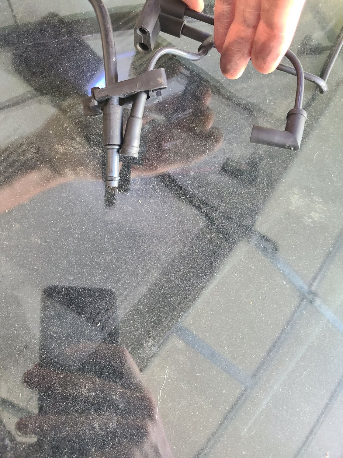

So I wanted to know if you can get replacement hoses I'm not talking about just a normal hose I need one like in the picture it connects to the vacuum harness and it's too dry rotted to find a number and I have no idea what's it's listed under

Just get hose rated for fuel use. Like most of the parts New old stock is not a option . Could get the p/n from the illustrated parts manual and search the Internet but why

So it doesn't need to be a special hose to connect to this?

Looks like barb vacuum fittings to adapt

Ok I thought it would be more complicated than that thank you
