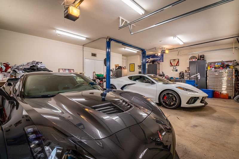

Oh come don't over generalize. I own almost all of those, plus a C8 and just sold my Tesla. I love my Thirdgens and have had 3 of them, a 4th Gen too. I talk to everybody about their cars and motorcycles not snobbish at all. Maybe you are thinking of Huracan and Porsche owners :-). I am working up a 383 for my Thirdgen next, need to get the Stealth Ram Ported as I don't think they will match up well with AFR 195 heads.Originally Posted by sofakingdom
