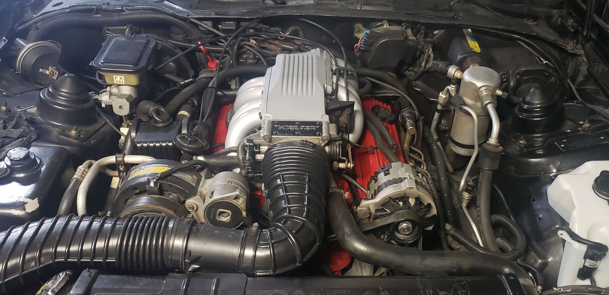

So after work today I manged to get stuck into this.
I removed the accelerator pedal, pulled back the carpet and cut out all the thick disgusting old underlay, seriously this stuff was rank, replaced that with two thinner layers of dyna mat like stuff, and was able to bend the pedal rod in small increments, (was actually quite easy to bend by hand, I put it in the handle of my 3ton floor jack then stood on the jack and pulled on the rod) then fully reassemble and test a few times until I got it where I think it is right. With all the carpet back in place it can now achieve wot. The throttle can still open just the absolute tiniest bit more but I kind of figured that won't make a hell of a lot of difference anyway and in my head kind of acts as a stopper so if I decide to mash the pedal to the floor from a standstill I'm not going to snap the cable. Thoughts on that, is that how it works lol ?
Unfortunately I can't road test it till next week cause I'm stuck in the garage while the driveway is relaid so until then I'm calling this one done!
