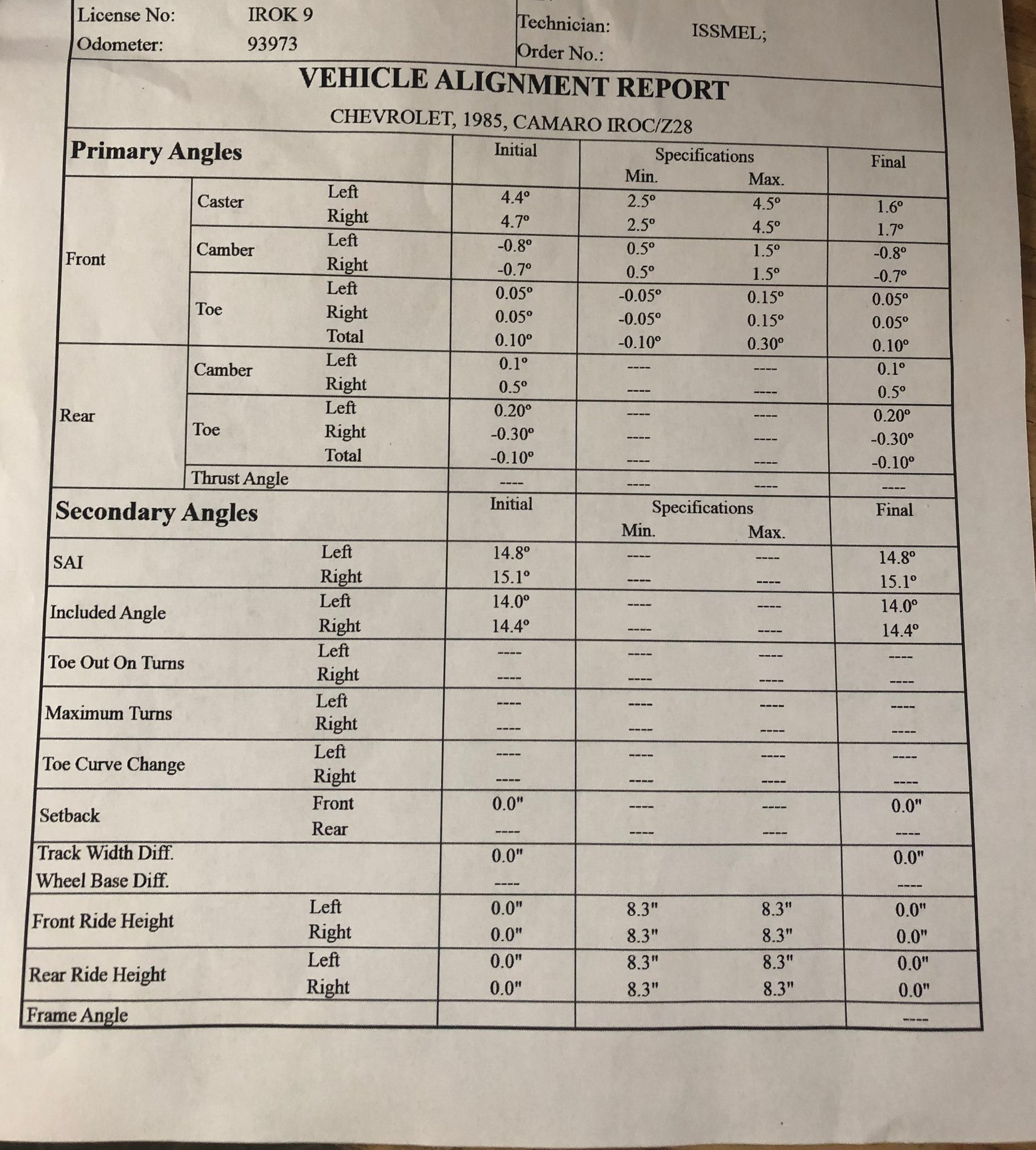

Today’s project was getting an alignment and swapping out a rear wheel. I had bought one off eBay but it was off on color and restored with some heavy clear coat plastic or powder coat?
I found a couple of wheels in original condition so swapped that out and had the shop balance both rears too. That’s the first step in chasing down very slight vibration in the rear/drivetrain. Taking it for a freeway run later, however already huge improvement in steering and centered feel.
They didn’t touch camber, is that fixed?

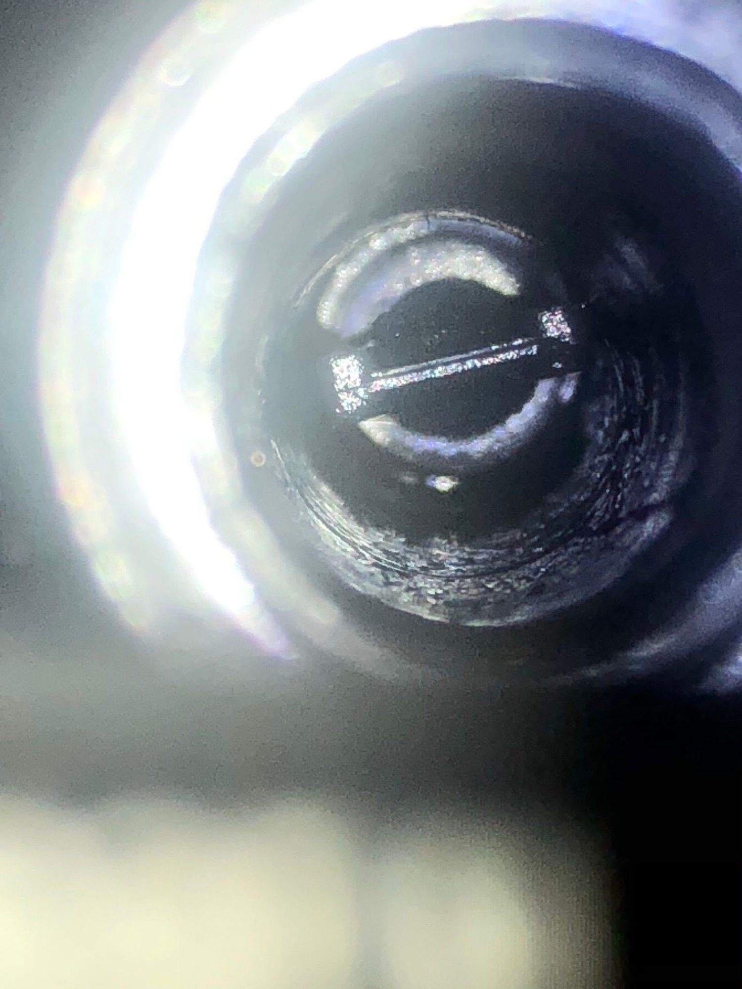

Took the California IROC up the winding Pacific Coast Highway US1 all the way to Paradise Cove which is where they filmed the Rockford Files. It does nice but the vibration is prevalent from about 65-75 mph and then around 80-85 mph it smoothes out and feels more like a harmonic.
There is a slow clunk that feels like a slide forward and backward at low speeds. My suspicion is the torque arm bushing is probably tired and I'm probably seeking perfection too.

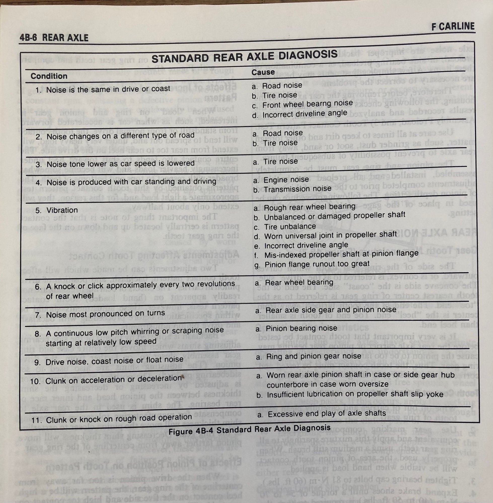

I ran across this in the shop manual which is also interesting -

In your videos the torque arm bushing looked good IMO, easy way to check is safely jack the car up, have someone else hop in, start the car and change the gears with foot on the brake while you are underneath looking at the torque arm bushing. If you see the torque arm moving around/jumping when gears are being changed you have your problem.
Klowny69 on YouTube has a good video on this, the car he was working on had almost nothing left of the torque arm bushing and it moved a lot when the gears were changed with the shifter.

Thanks yeah I'm with you on the torque arm bushing as it's a two-piece unit. I can see probably about an inch of the driveshaft (the end going into the tail shaft of transmission) and torque arm leaving a visible mark by shifting in and out, both of these are moving front to back or back to front.
The question I have is that okay and normal?
I also had the same thought about the axle bearings sitting around the 25 years, thinking that probably couldn't have been a good thing.

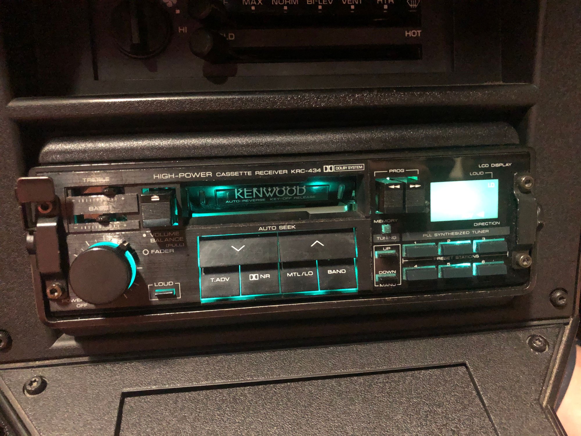

Hey man, chillin and been enjoying the summer and installed my vintage Kenwood cassette deck and speaks
whatcha been up to with yours?

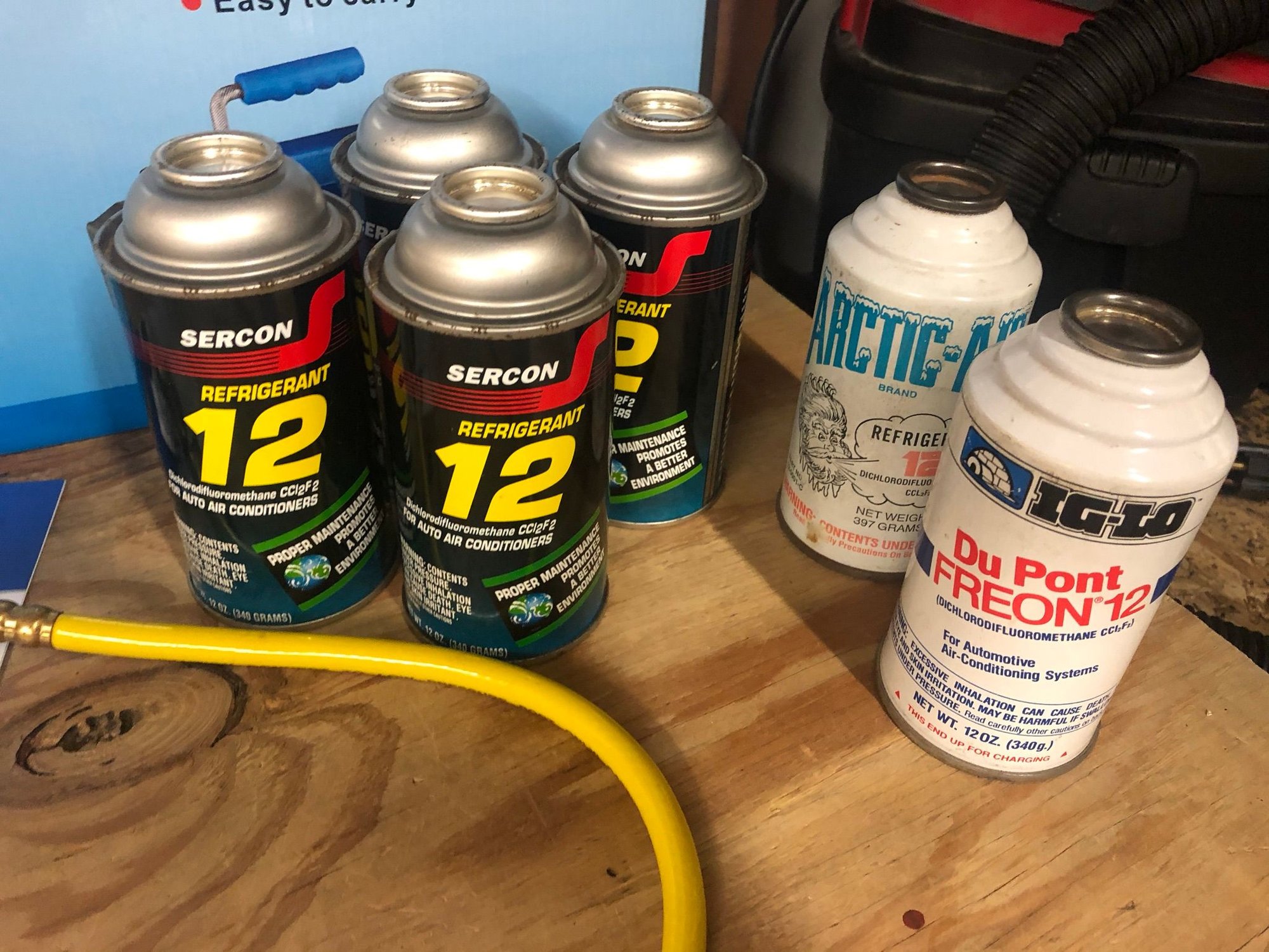

I also bought 3 cans of R12 plus a hose and was thinking of charging the system, I have no idea what I need to do for that?

does it have any charge in the system? My 87 had some R12 left after sitting for years...so if its holding a charge, i'd just shoot someR-12 into it. It looks like the compressor was already changed at some point.
If not and it leaked all out..., which I suspect.....you shoulllldd get a set of gauges, and rent a vacuum pump from autozone..the pump is free rental if you return it under the rental. and see if it wil lhold a vacuum before shooting R12 into it.
if it has leaks, then you'll just be wasting that spensiiivvvee R-12!

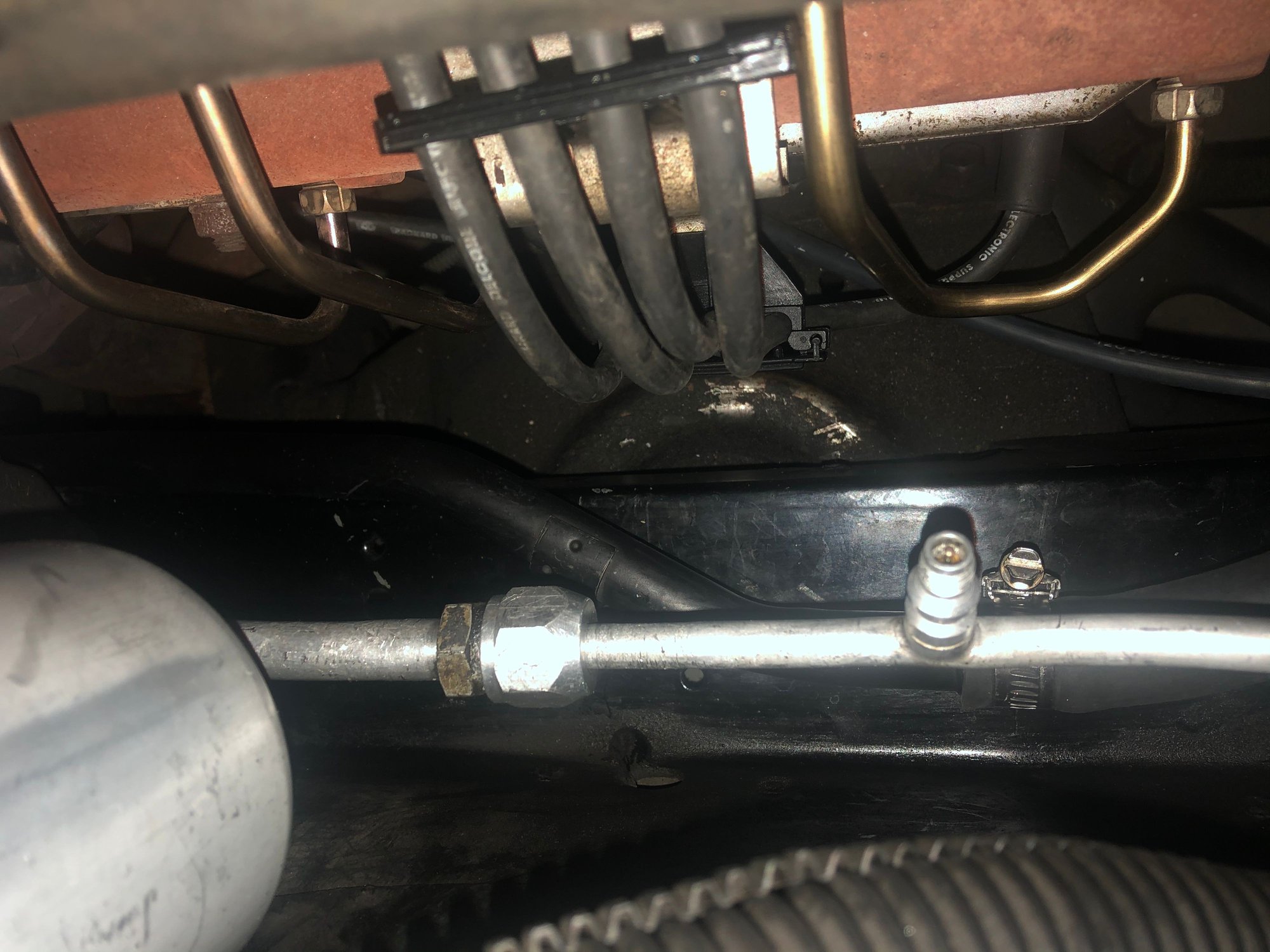

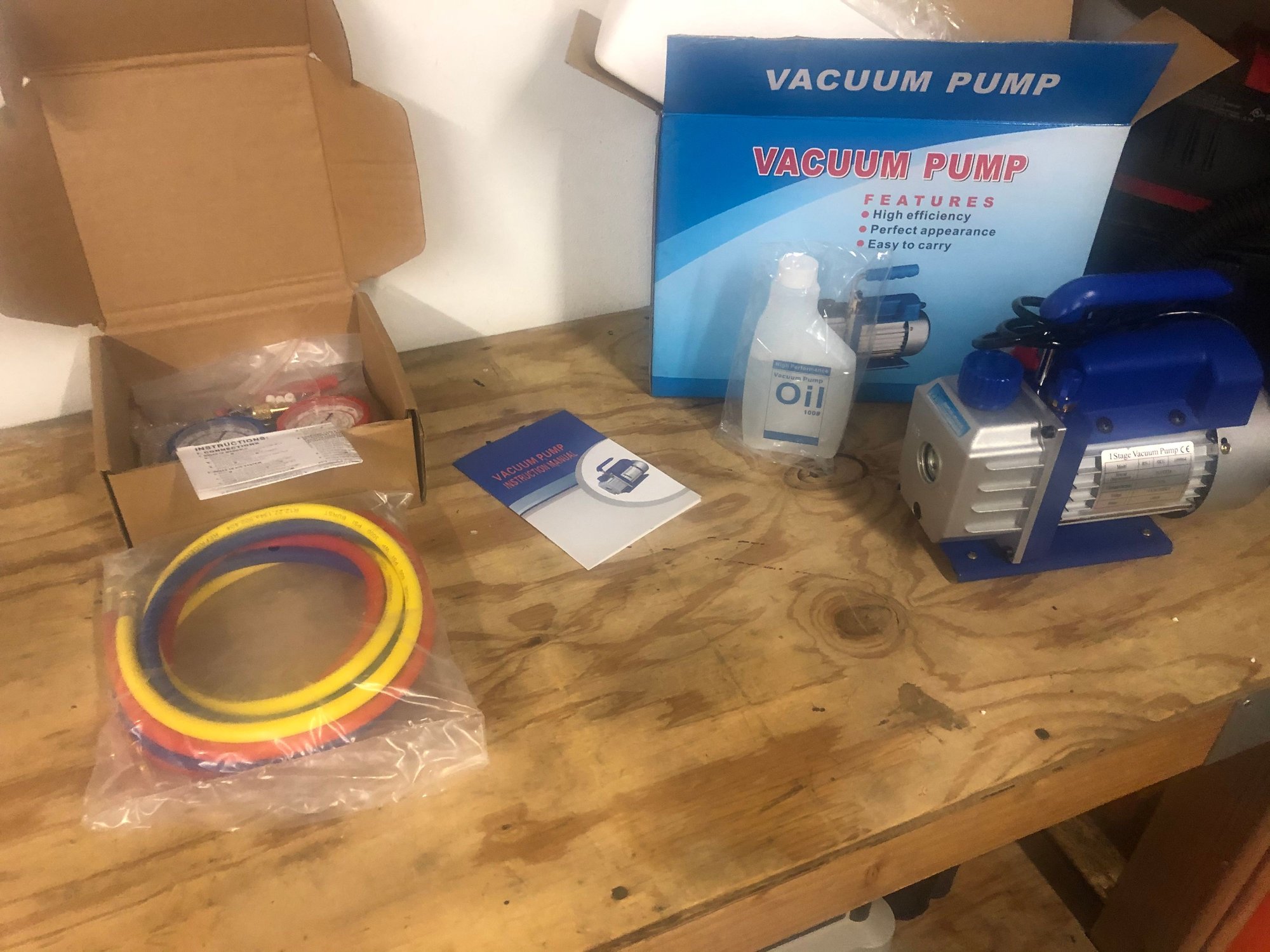

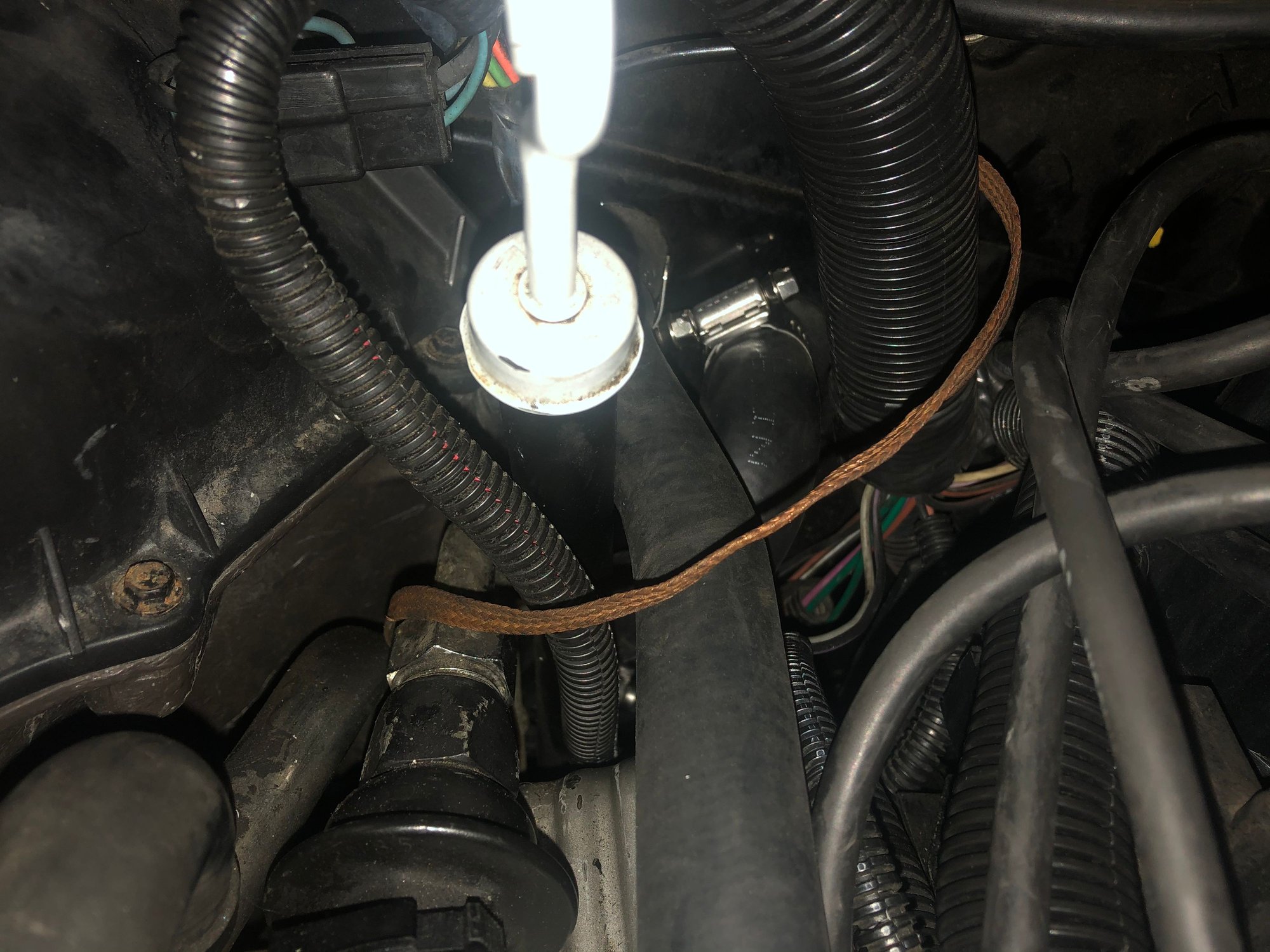

yeah it’s empty, yeah noticed the compressor and a interesting scrap of heater hose holding the line onto the radiator so someone serviced it at some point
i bought some tooling and a special adapter for the high side from the jungle website and golden R12 from fleabay. I’m going to draw it down and see if it holds a vacuum. My mind is debating if I should replace the hoses, o rings and receiver dryer?

When I resurrected my R 134 conversion we did new drier, O rings and orifice tube. If the hoses look good your probably OK. One thing to watch out for is junk in the condenser, I was warned about that by the HVAC guy seeing as how my compressor was totally shot and the reason mine wouldn’t work. Mine sounded like it imploded lol.
Also AC Delco compressors were surprisingly affordable for these cars and they were brand new non remans.

Yeah I did a draw down of vacuum on the system and it's held for a couple of days without leaking. I'm sure 25 years of sitting everything leaked out slowly...

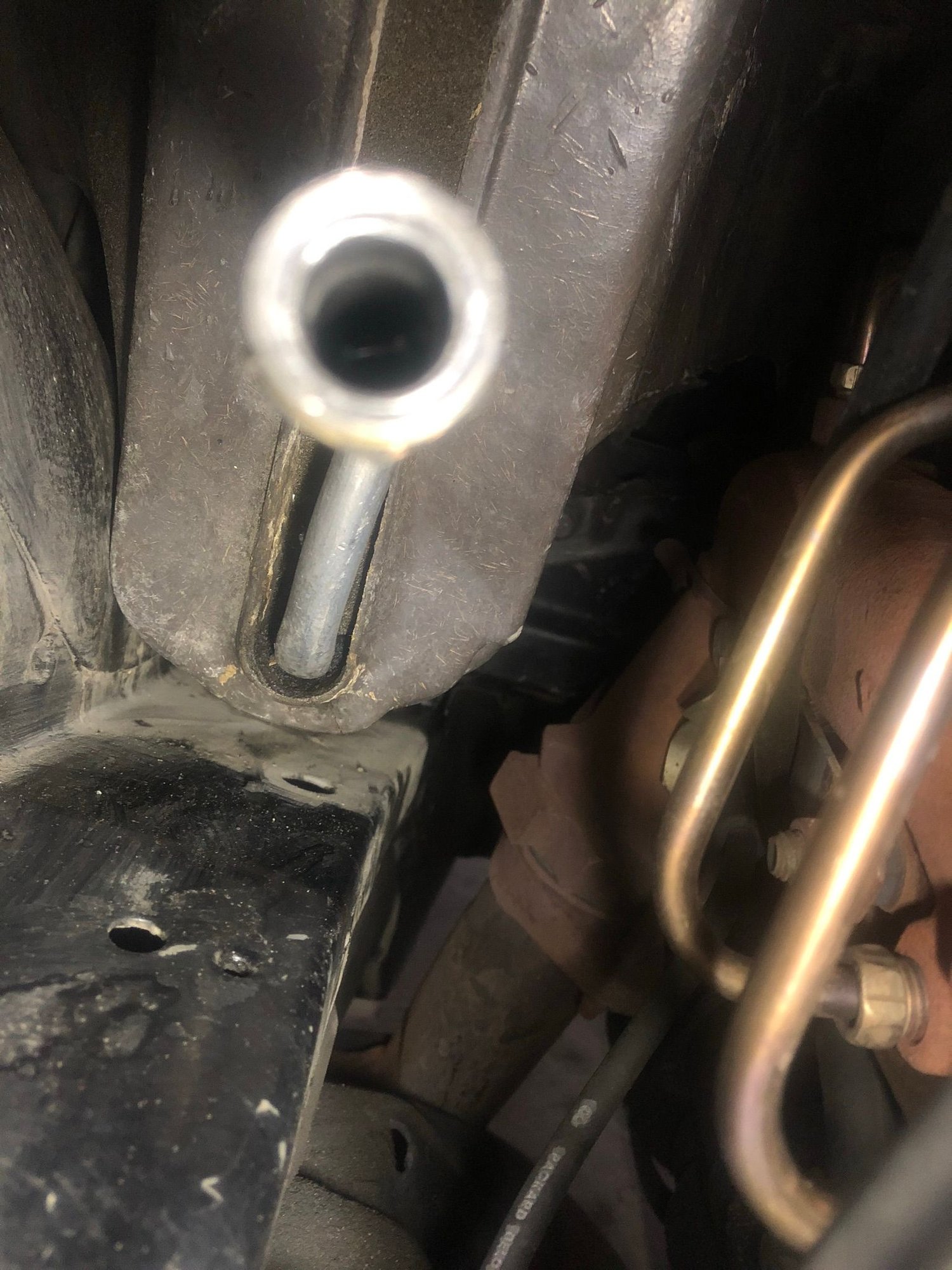

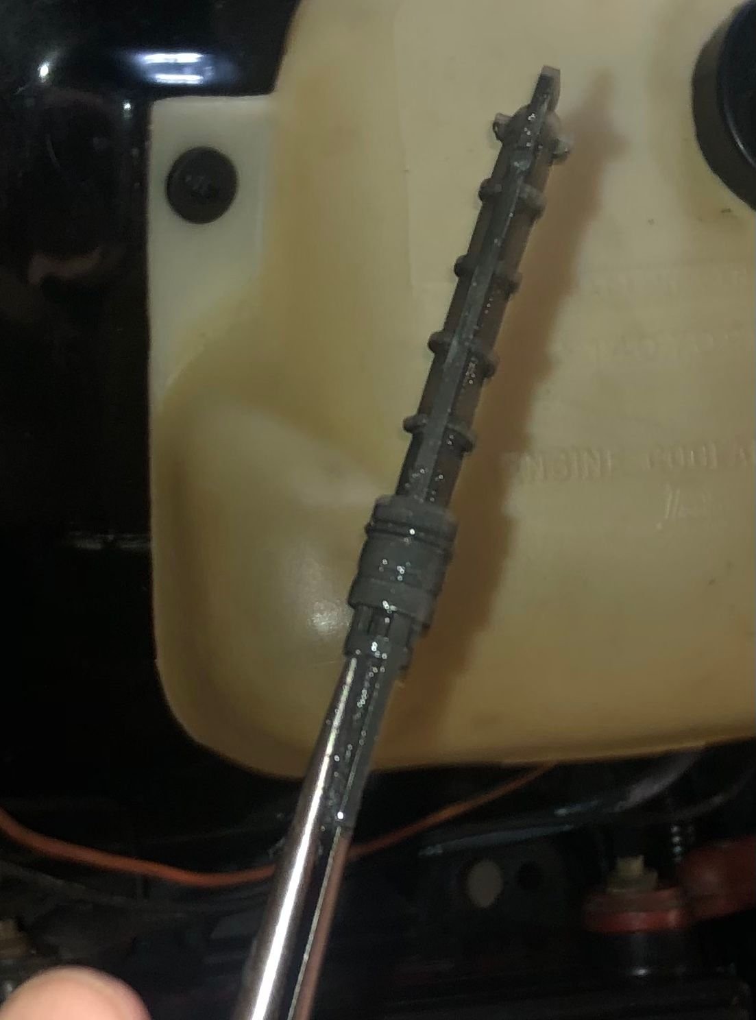

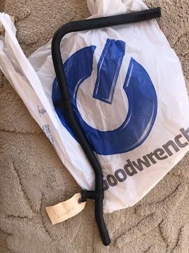

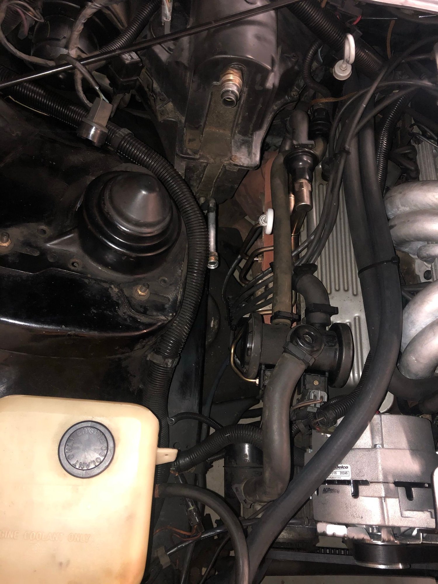

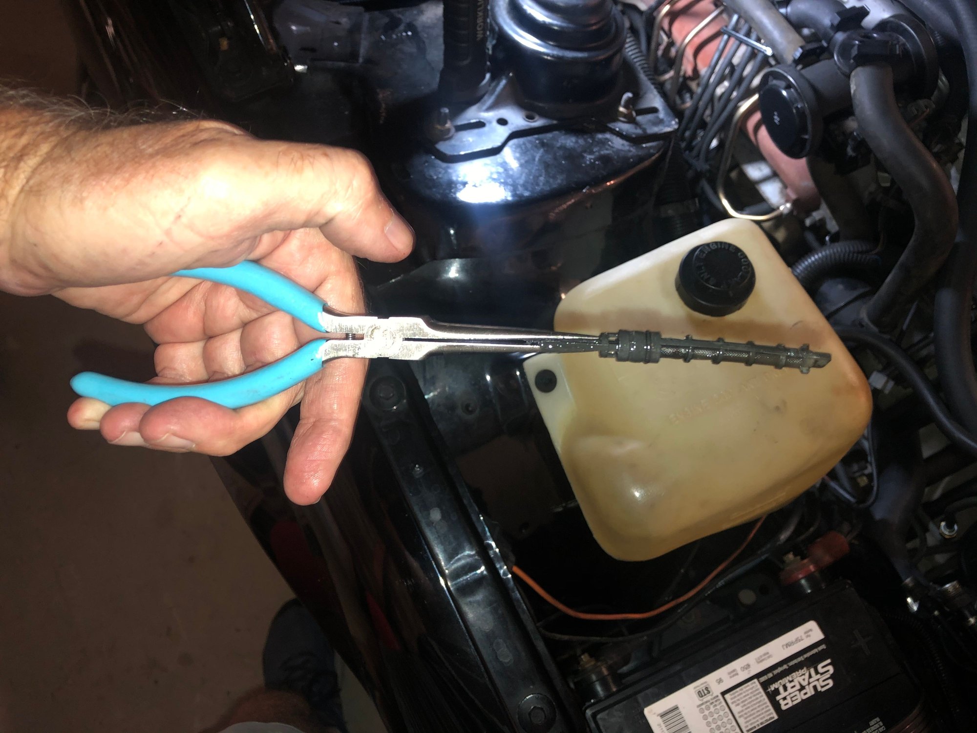

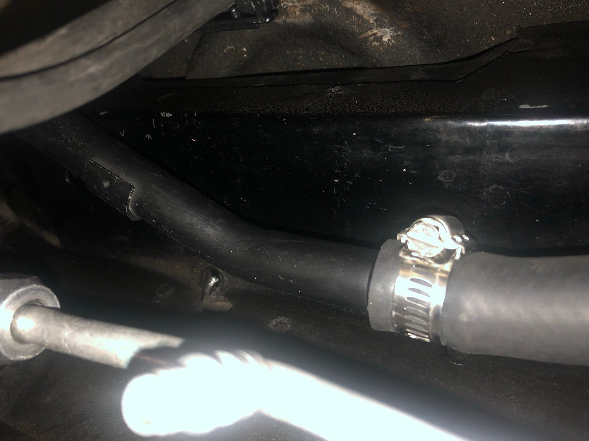

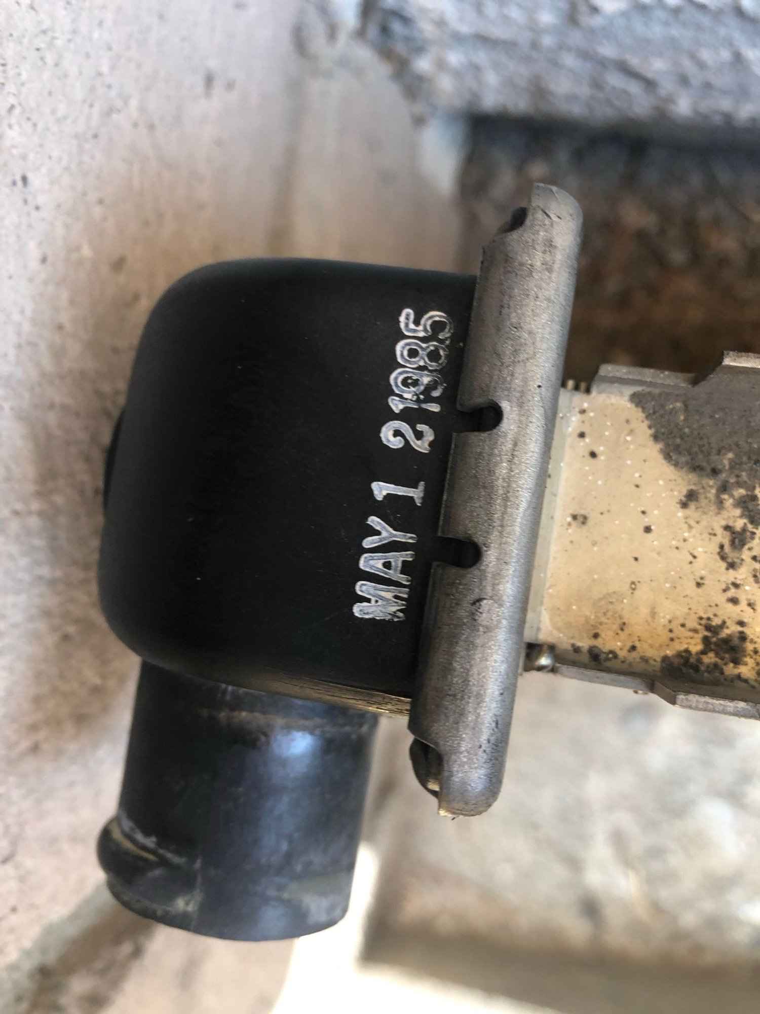

Took out the drier and it’s heavy, discovered that someone had installed the orifice tube in backwards, ugh so ordered a slim long needle nose to see if I can surgically remove it tomorrow.
I’m also missing the heater hose pipe and have searched around everywhere to find one as would be nice to restore it back. My assumption is someone got frustrated and took it out during work on the A/C back in the day as all the brackets on the line were unattached.

That metal heater hose pipe makes changing that hook shaped small heater hose a real nightmare as accessibility back there is very tough. But I see why you want to go back to stock with your very original car so I would start a thread in the parts wanted section here and you might get lucky.

Thanks and posted something, will start calling around some of the salvage yards tomorrow too. Was successful in getting out the backwards expansion valve. Also cleaned the line set, brackets and the manifold mating surface.

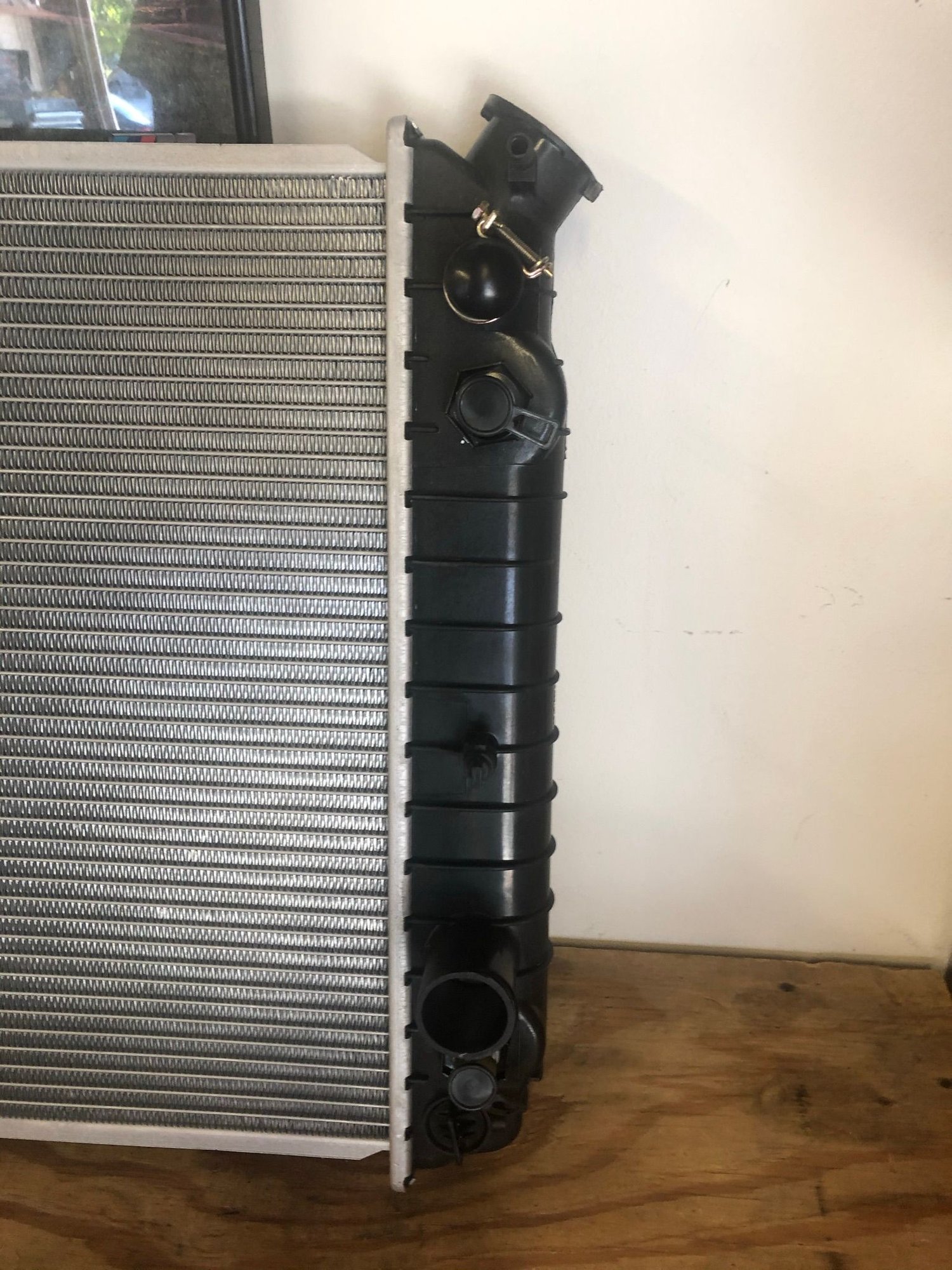

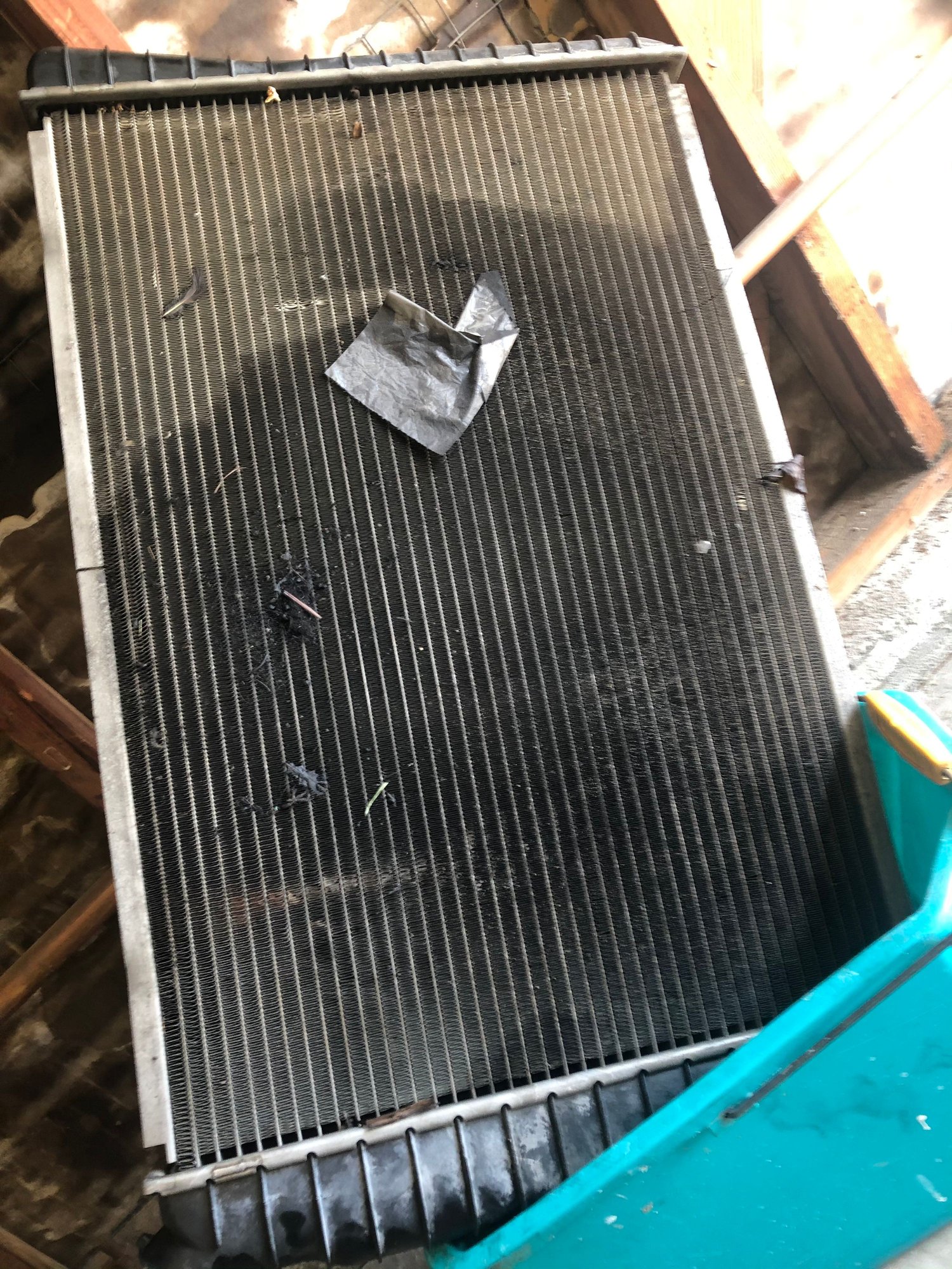

Old Sep 4, 2021 | 03:22 AM
  #130
calidude's Avatar
Joined: Mar 2015
Posts: 168
Likes: 27
From: Los Angeles
Car: 1985 Camaro IROC
Transmission: Auto O/D
Re: Restarting a garage find

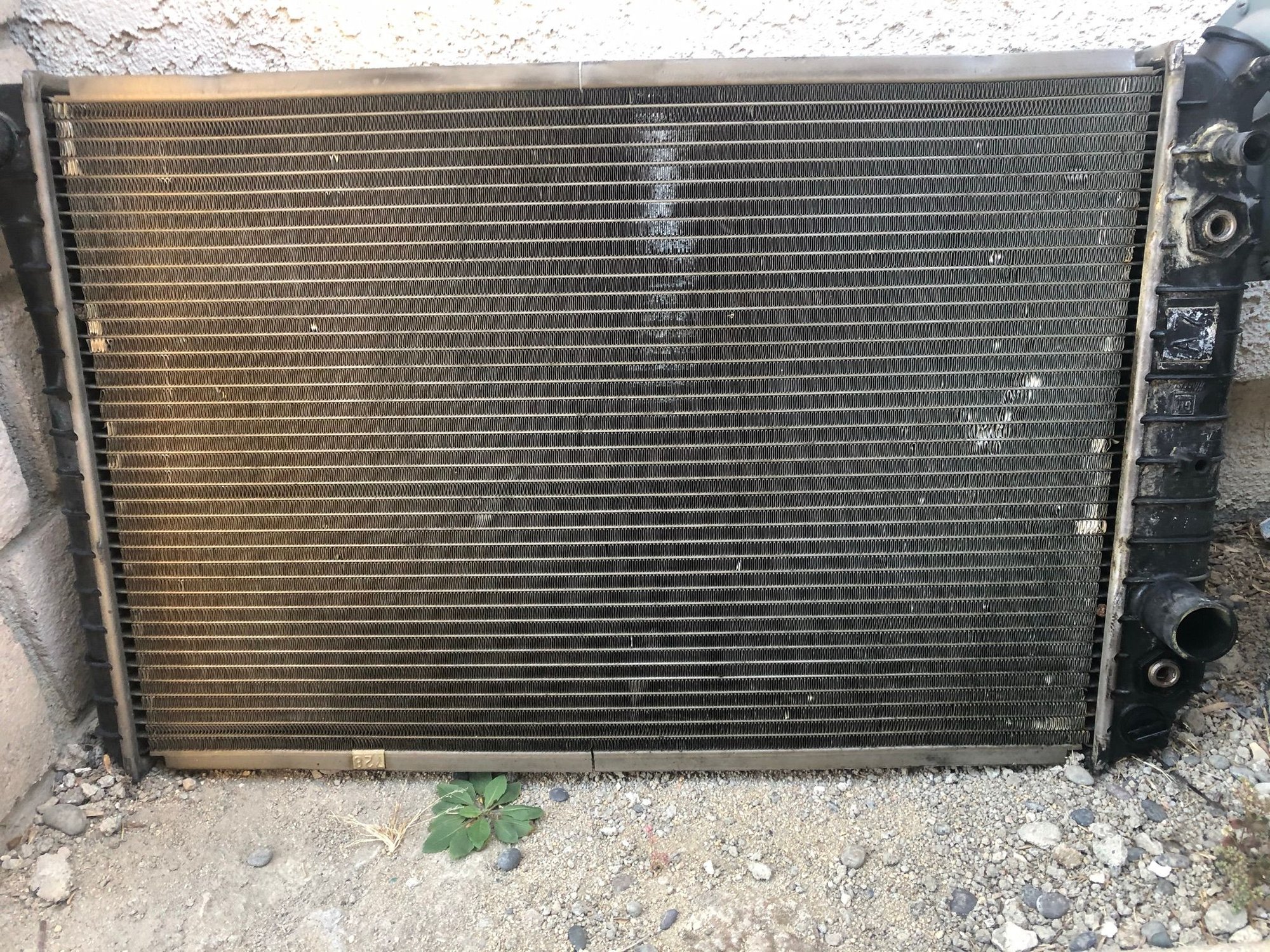

Well the radiator is done as the plastic tank is peeing coolant between the front passenger side mid point where it joins with the core aluminum. So time for this -
Seems to be well built, open to hear if anyone has had issues with them? It’s got a checkered flag so it must add more horsepower lol 😂
I’m waiting for the coolant pipe and hose to do the restore too.

When I damaged my original this past spring I lucked out and got one of the last brand new GM radiators that my dealer found and had sent to them. I went that route after hearing a lot of the direct fit replacements out there do not fit well or require modification as well as short supply. This looks like an actual direct fit that looks the part and would drop in without mods. Keep us posted on the fit, the reviews seem outstanding and the price seems great. I see they also make a heater core for our cars as well but not a lot of info out there on those.

Originally Posted by Reddragon88gta
When I damaged my original this past spring I lucked out and found one of the last brand new GM radiators that my dealer found and had sent to them. I went that route after hearing a lot of the direct fit replacements out there do not fit well or require modification as well as short supply. This looks like an actual direct fit that looks the part and would drop in without mods. Keep us posted on the fit, the reviews seem outstanding and the price seems great. I see they also make a heater core for our cars as well but not a lot of info out there on those.

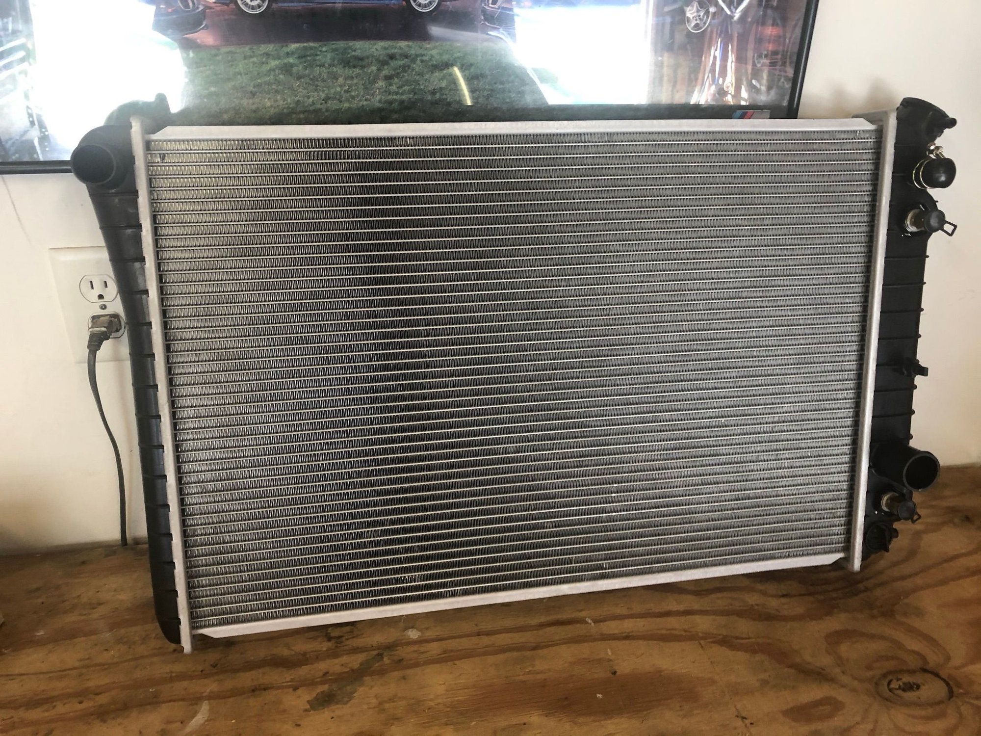

Thanks and will do as the design of this looks identical and is 2 core thickness.
The OE GM part of 52497687 now shows some other design without a curved filler neck and fittings fit the transmission cooler or the left so decided not to try.
Here is the coolant pipe I’m installing too

Radiator is out, found some history as looks like Hostess Cup Cakes were 80 cents back in the day also a piece of plastic and remnants of the trans fluid leak. The tank also shows wear it has been leaking.
That new radiator is good fit and identical to original.
Installed the heater pipe and took a lot of patience a trip to Home Depot for sheet metal screws in hex head. The difficulty was tightening the clamps and used a ratchet 8mm wrench. Looks much better without the hose across the manifold.

Success and complete with the cooling system update -
