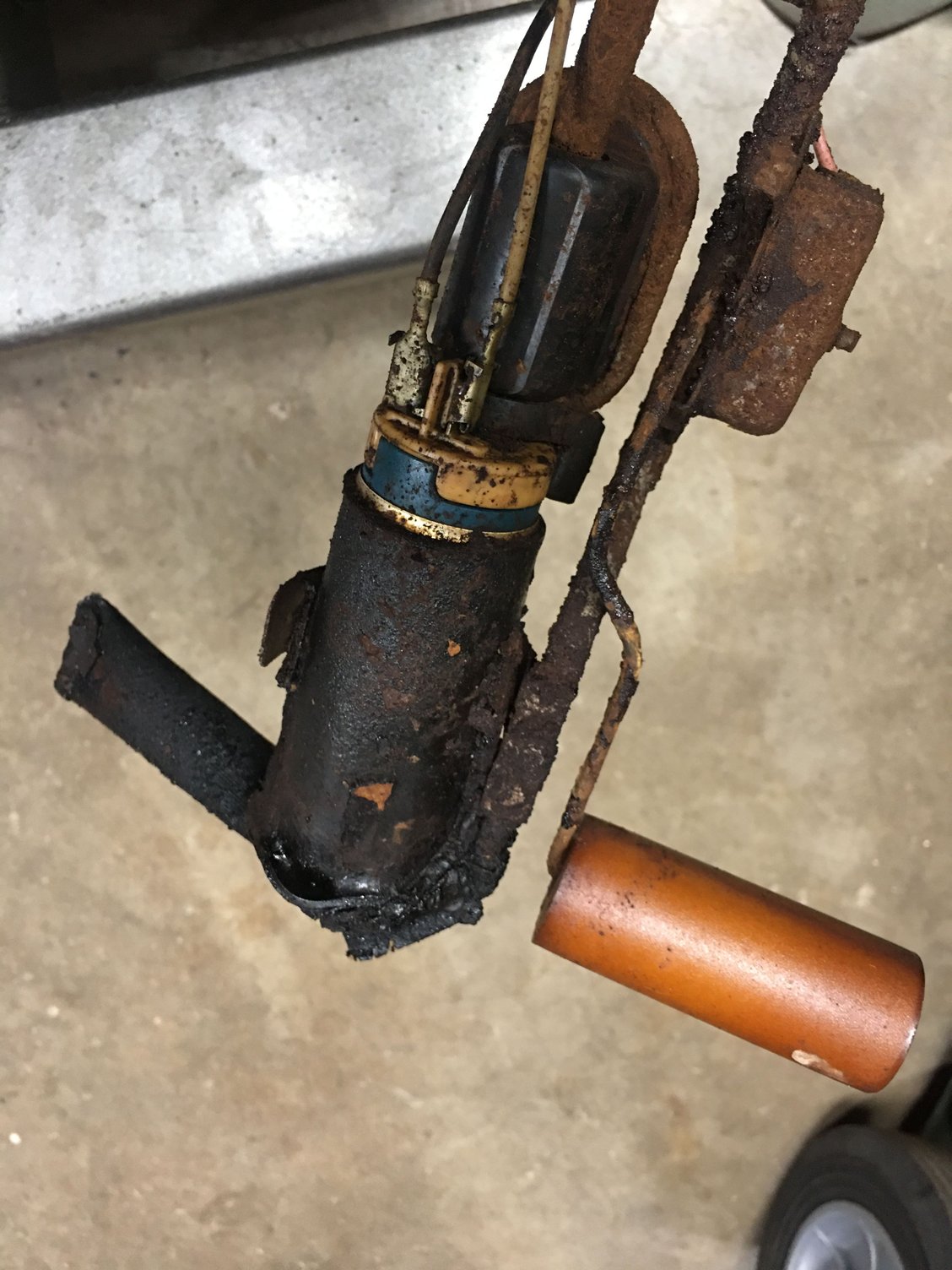

25 years..... you should just figure on replacing the fuel tank, pickup, and pump. They will be garbage. Both of mine sat for over 10 years and the fuel tanks were a total loss.

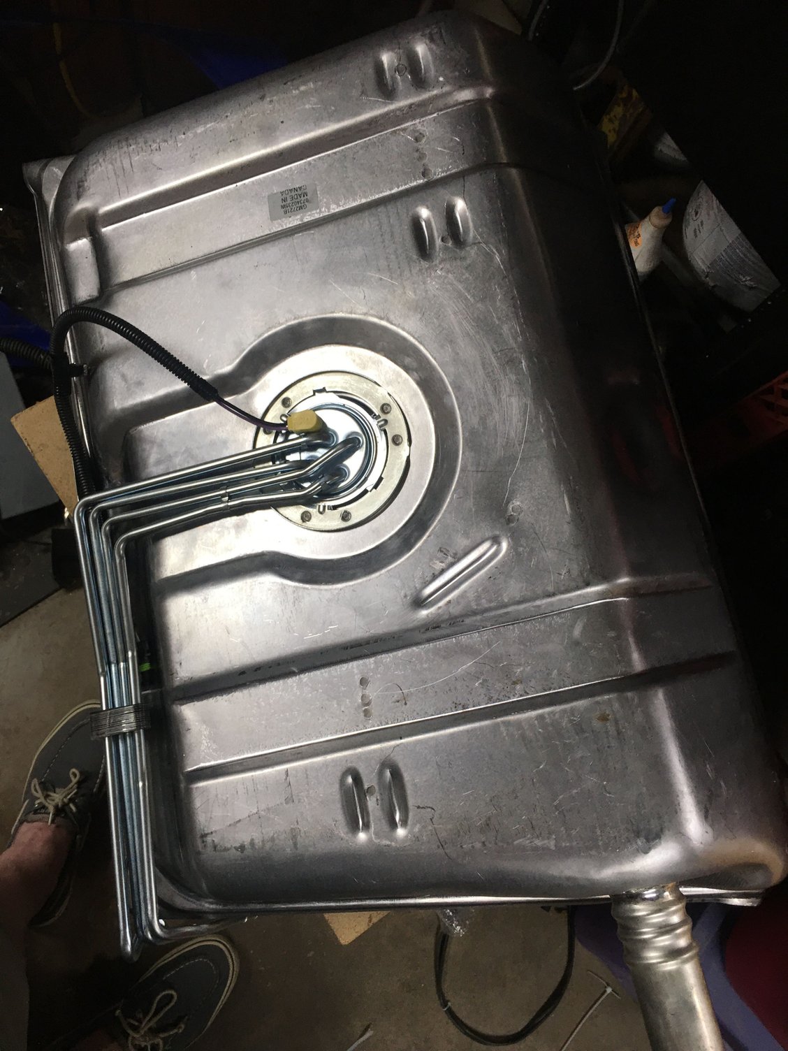

I am nearly finished resurrecting a one owned garage keep 85 that was parked in 93! New baffled Spectra tank and Areomotive E85 Fuel Pump 11542 and a Spectr Sending unit.
No saving this 85 IROC FP after 27 years
Spectra baffled tank requires you to rotate the sending unit fuel pump mount 90° so the filter runs left and right not front to back! Easy to do with patience and Dremel!

Waste of time. Just pull the tank. It will be garbage along with the pump and sending unit.

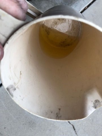

Pulled 7 gallons out of the tank, it looks like ale. I threw on a new fuel filter which seemed to help remove more bad fuel from the lines. Changed the oil too as both gas and oil smelled just funky. Both the oil and fuel filter was the old emblem AC with the round red dot. I had to stab the oil filter with a screwdriver to start it off.
Car was missing the alternator so also rigging that up as hunted all over town for a bolt spacer. I finally ended up ordering something from Amazon that should be here soon. There were 2 K&N air filters installed and swapped those out too.
I'm going to finish that up along with change plugs, cap, and rotor next.
Thinking I don't have much to lose by at least throwing in a few gallons of gas and give it a turn to see if she'll run.

If your going to try to start with the varnished injectors and old pump. You might melt the relay connectors.
not sure it will even pop with old injectors maybe with starting fluid.

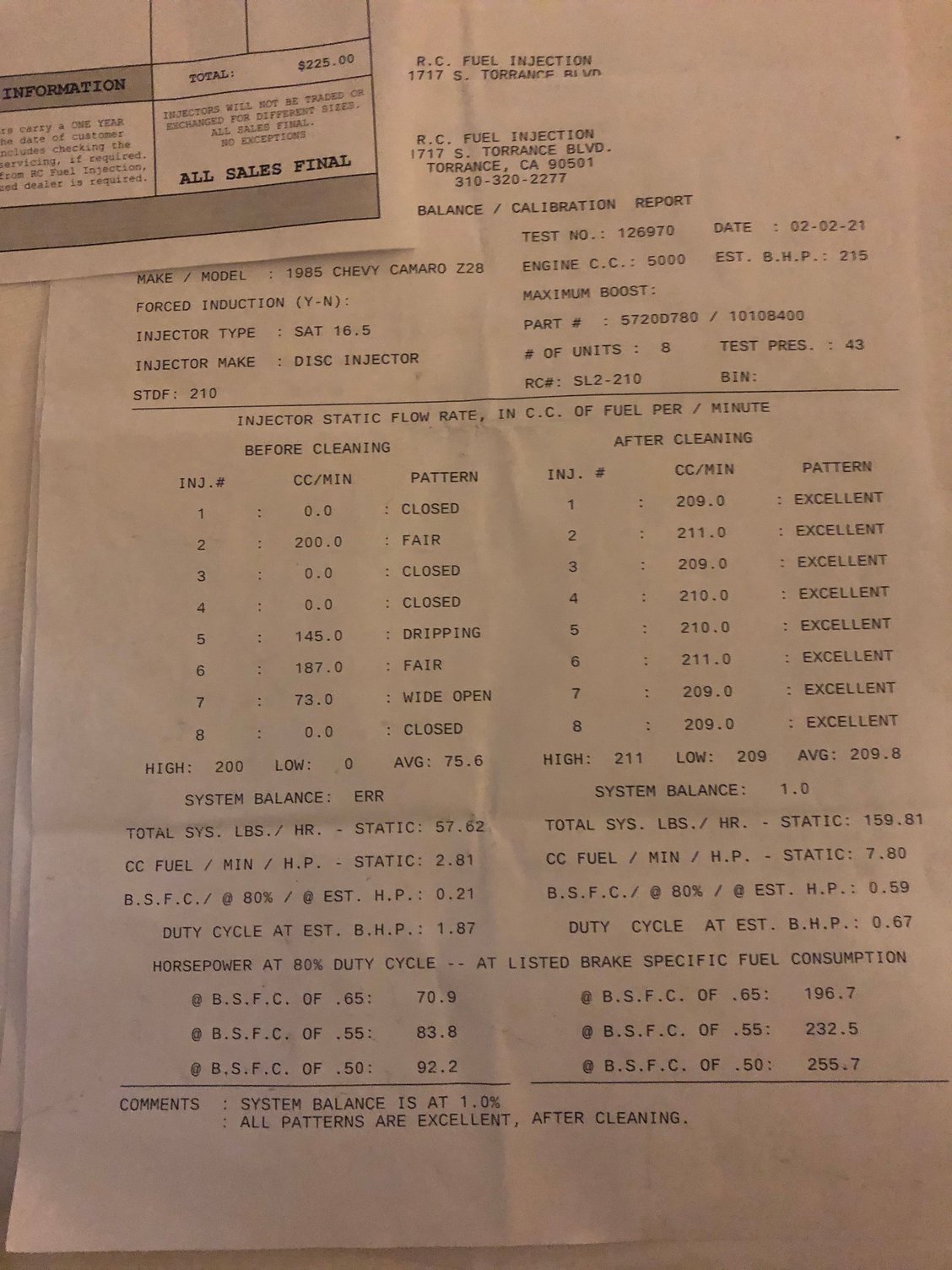

I live by this place in Torrance and in regards to the fuel injectors they do rebuilding and are pretty well known. They will clean and test for $25 a piece * 8 = $200
https://www.rcfuelinjection.com/Stor...ector-cleaning

Yeah these are rebuilt Bosch units from that South Bay place, the Bosch III's seem to be using some kind of adapter too...

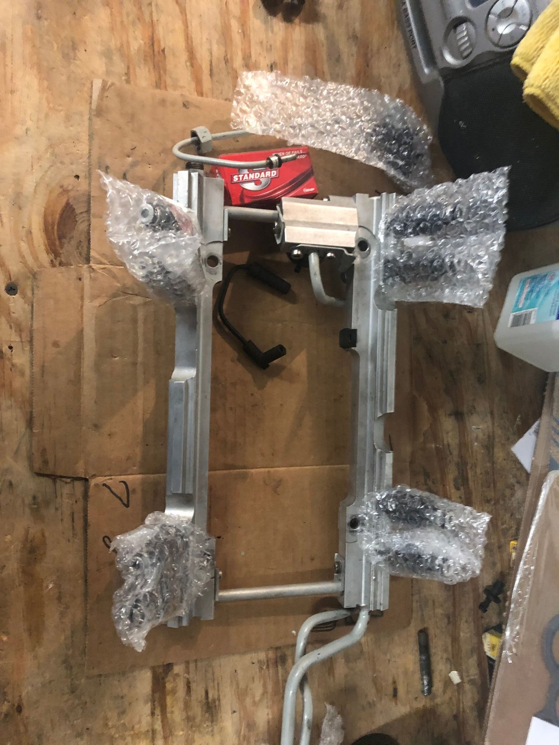

the D3 do have a press on adapter to make them longer to fit in tpi. Fuel injection connection sells the same injectors but double o-ring to seal them on the intake side. But like stated all over the board need tuning.

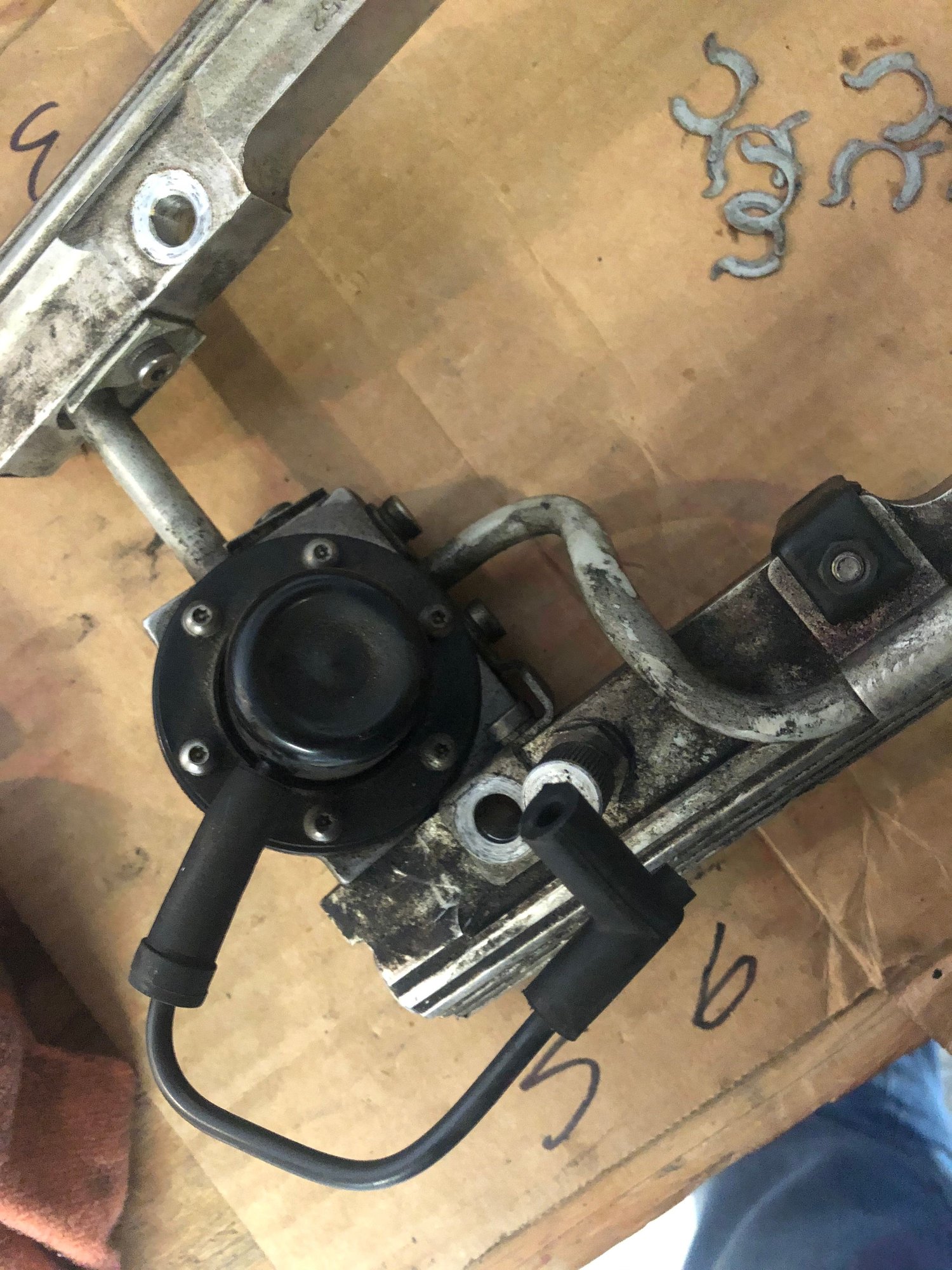

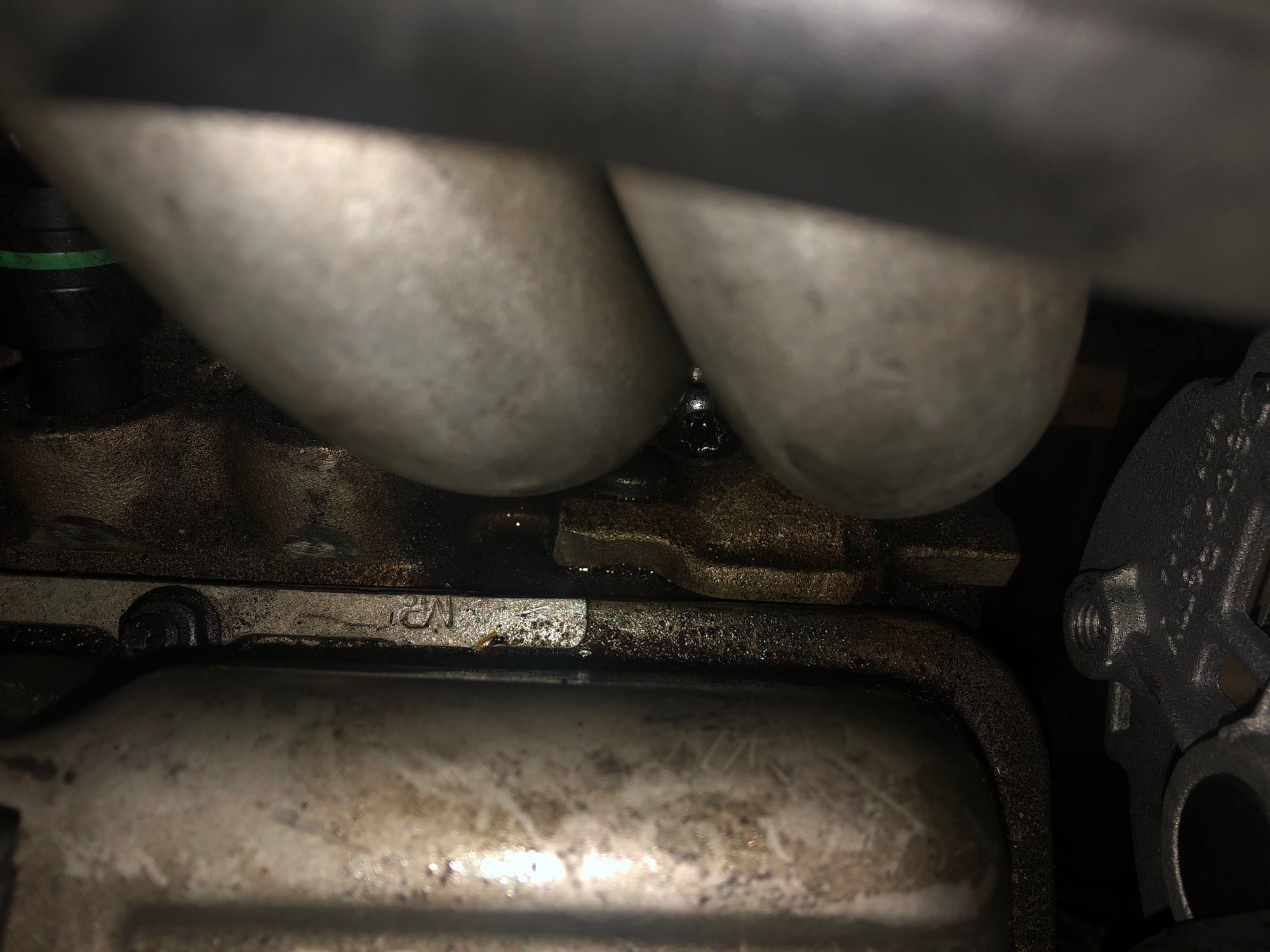

Looks like a bit of a project taking off the plenum and getting these out.
Photo of what's in there from the replacement in 1991, are these any good? as noticed they have a green band...

Replacing the injectors is a easy job. Just watch the length of the bolts and use a good quality t40 .
those look like Lucas injectors would probably have a D then a number to identify them on the top body.

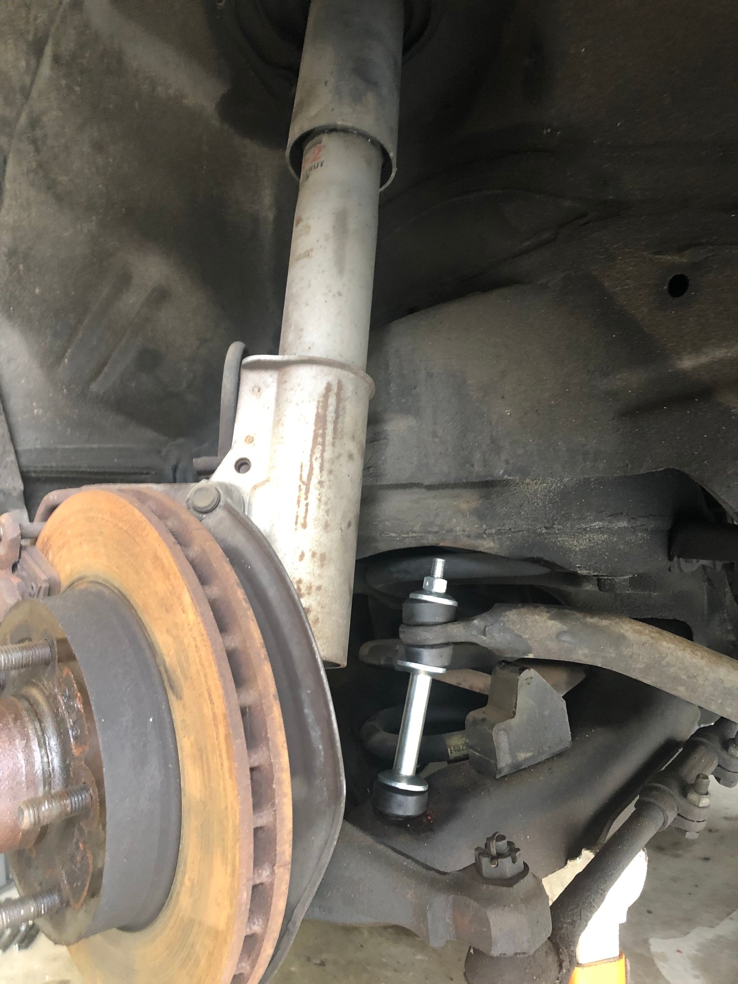

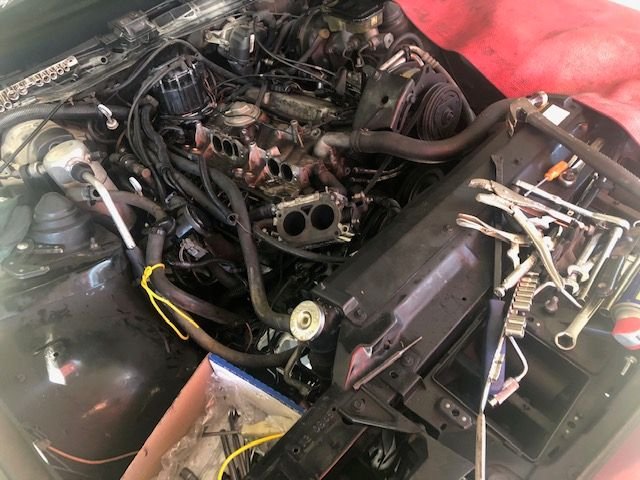

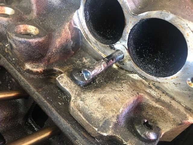

Making progress although I'm stuck trying to get this Torx bolt off the passenger front lower. The others came off easy in fact a couple of them were loose.
It won't budge and I put a lot of force on and don't want to snap it. I annihilated it with PB Blaster but doubt it's going to reach the threads with that large head. There are all kinds of smog stuff and the coolant line to/from the throttle body that also make it a challenge getting a long extension straight on it.
I'm using these T40 sockets with a 3/8 rachet, the one on the left is a Great Neck and the one on the right is a Lisle... Does that Great Neck to me looks torqued or bent???
Appreciate any advice guys

The one torx looks twisted. You might look on eBay for a snap on torx. Quality really matters especially if it’s stuck. a wobble extension works well instead of the u joint socket. I doubt the bolt is rusted but over tightened .

Yeah quality sockets matter here - Snap-On would be preferable. Also take a punch and give the bolt a few good whacks straight down it's axis. Can really help break the thread tension.
Pull the valve cover to get a better shot at it also. It's not worth the effort to fight around it.

Cornwell and max are other good choices for a t40.
going back together 8mm stainless Allen heads are cheap and a long ball head socket works great for install. A dab of antiseeze on the threads doesn’t hurt too.

Thanks guys, yeah all good advice and much appreciate. I'll give it some good jarring whacks with a punch and also get a decent T40 socket as had to step away from it or something was sure to go wrong last night
I was looking around for a decent Torx set and also to buy some wobble extensions as don't have them. I have some Snap On screwdrivers, SK wrenches and a 3/8 socket set but mostly Craftsman that are getting tired. I found a SK Torx set that looks reasonable and hear they are near good of quality as Snap On and a little cheaper. I'll look at those other suggestions too.

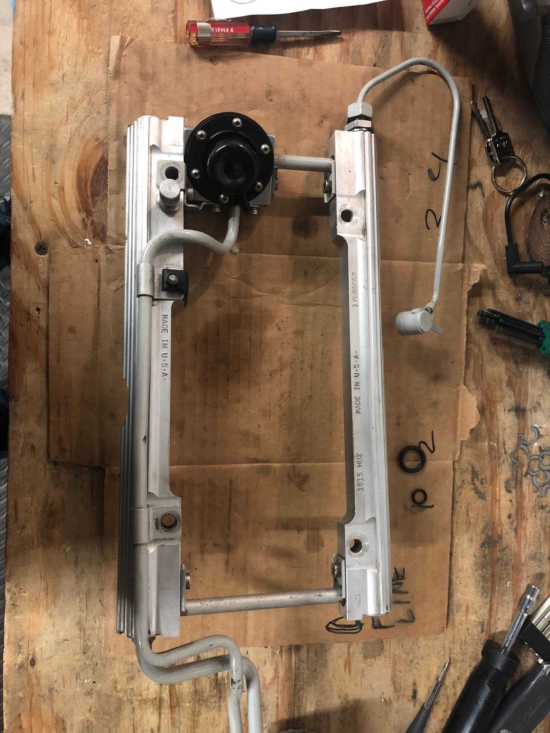

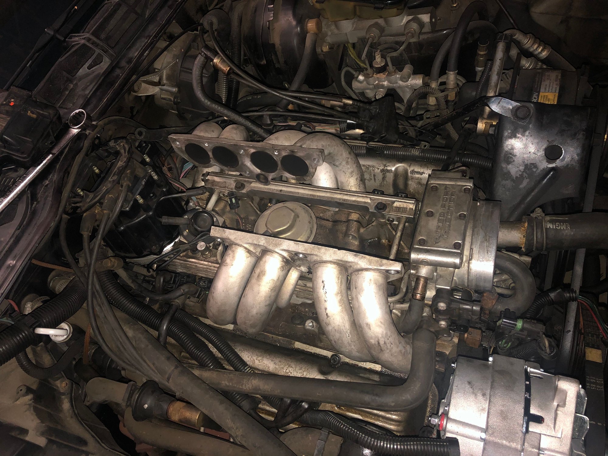

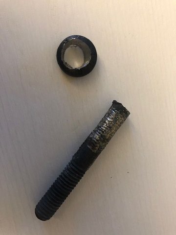

Okay finally some progress and had to perform surgery to get the SOB out!
Couldn't get the right angle on the bolt, wobble was close and it broke loose but I ground the head off. Then had to take off the valve cover to drill it out and lots of propane heat to get it to loosen with a vice grip. I may frame it, lol...
Now the fuel rail is off and can now rebuild as ordered gaskets, o-rings a fuel pressure regulator and will need to put on injectors. Add a set of valve cover gaskets and need to find a new bolt.
I'm also trying not to look at these original coolant hoses and belts. Suppose a guy should clean up the runners, plenum, and throttle body as lots of black crap inside them???
Have a new cap and rotor, plugs have to reorder as 45TS were in there, and ordered 44TS which is for a carb 305 I guess

Wow great work on getting that bolt out ! You got the bolt, and didn't ruin anything else in the process, good job
Now, just a friendly suggestion, if the silver looking specks I see in this pic is metal dust from drilling the bolt you'd best get it cleaned out of there before you put it back together. Oh, and, as to the hoses/belts, just as well to do em now that your into it, VS having them fail when your out driving someplace

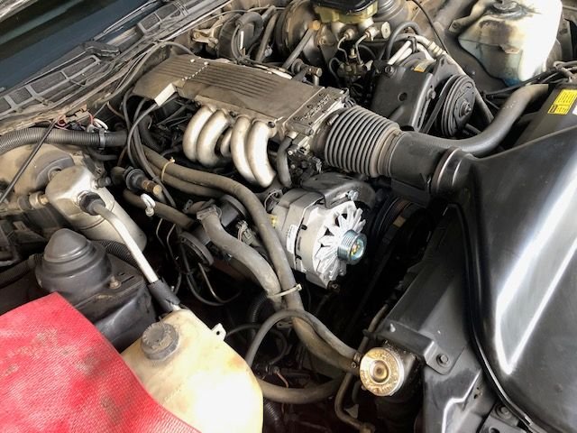

Yep, sucked all those up with the shop vac. Found a replacement NOS long Torx bolt on eBay. Also ordered up 4 belts along with a set of valve cover gaskets...
The hoses seem to be a bit of a mystery locating for the to throttle body/water pump as that's the one that seems to be seeping along with the upper and lower hoses. Could be the cheap OEM wire and tower clamps though too? The heater hoses are the other two for a total of 5 to replace. The coolant looks good in the radiator and nice and green.

Nice work so far, now would be a good time to do the TB coolant hose bypass especially if that hose is leaking. Cleans up that area and makes TB removal easier

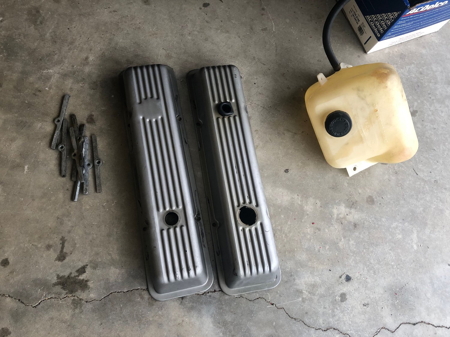

Made a bit more progress on a couple more things and replaced cap and rotor. Cleaned up the valve covers, coolant and windshield jugs. The sway bar end links had literally crumbled into pieces. Disassembled the fuel injectors from the fuel rail and will start pulling it apart for new o-rings. There was a pretty cool 4 part YouTube video on this.
The previous owner had put on KYB GR-2 gas struts probably as an upgrade over stock, looks like the rear Bilsteins are in as see the yellow, will have to pull the rear wheels next. Threw some juice on the bleeder screws and looking at the front rotors they are either going to need to be sanded, turned, or replaced with the rust on them?

The rust will wear off the rotors in a few miles. If the calipers bleed and work just run it. A few stops and that will be gone in a hurry.

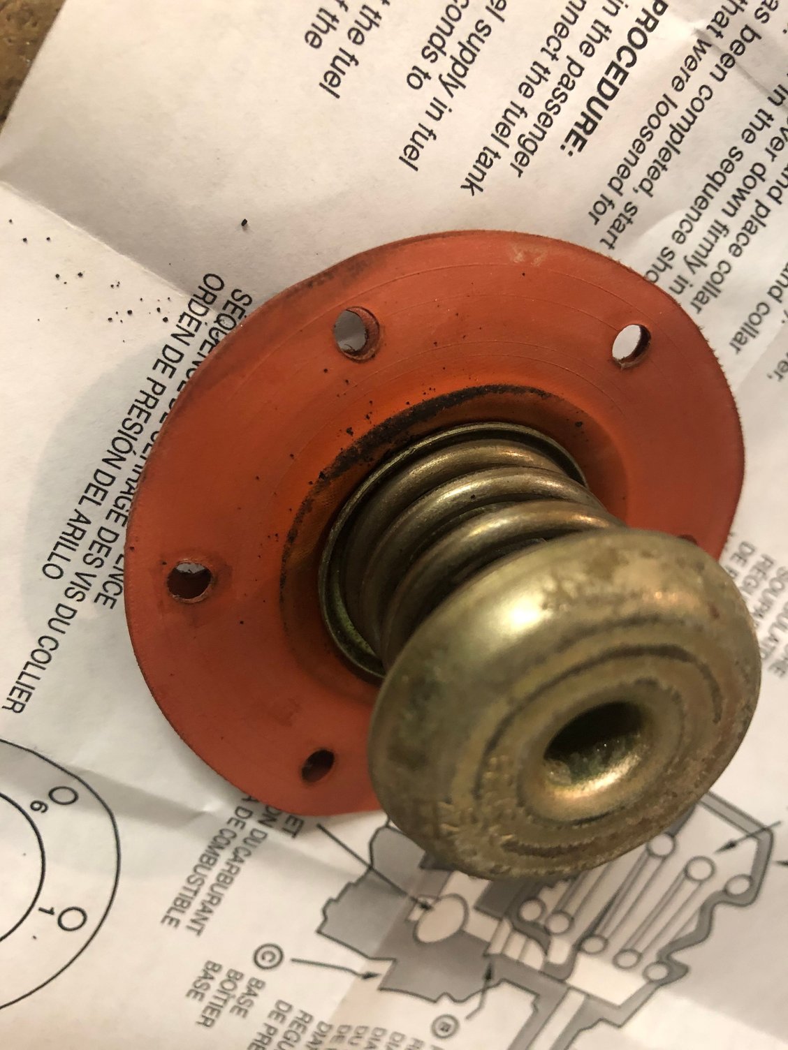

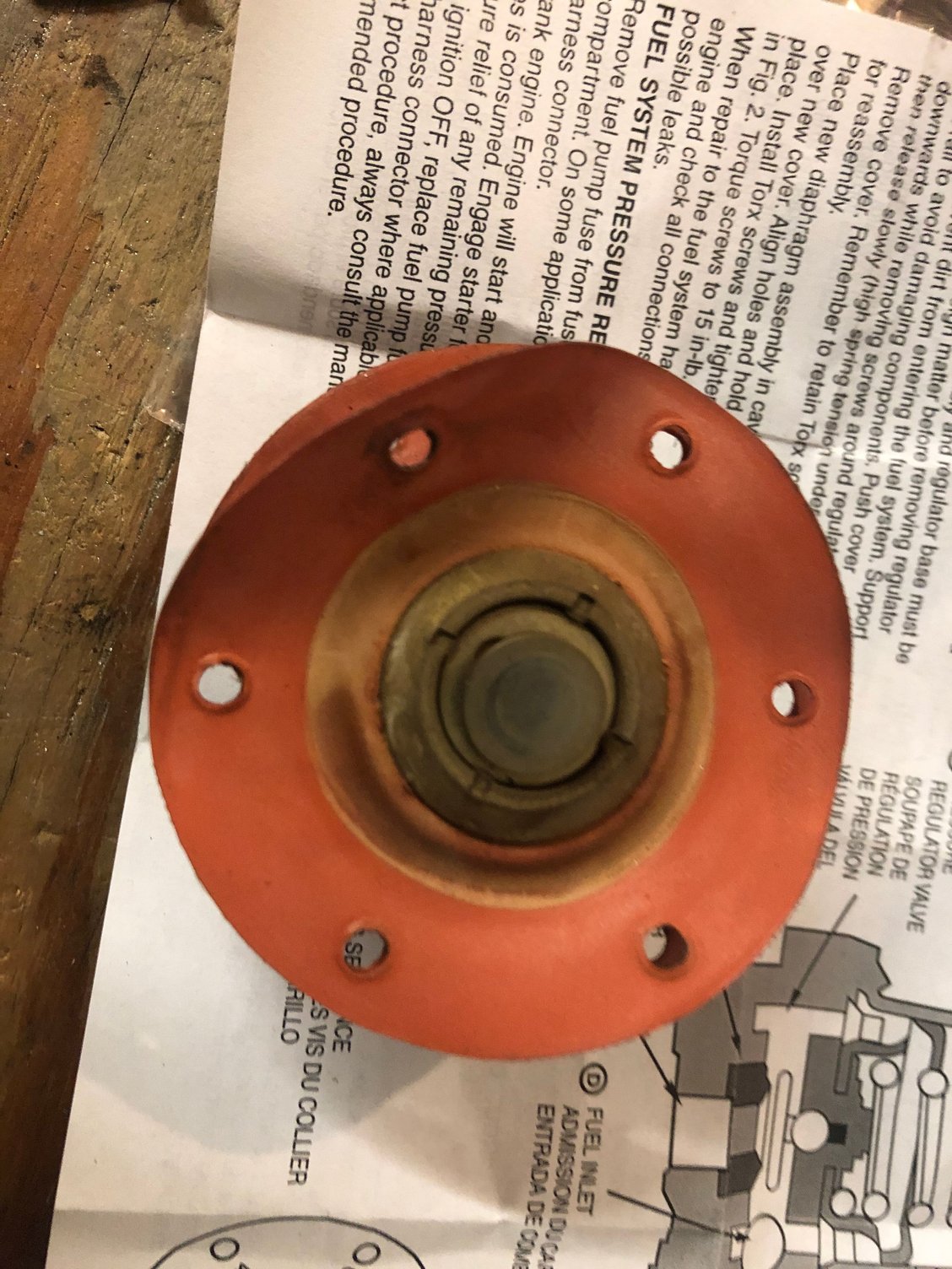

I might have missed if you mentioned it in the thread already, but they sell an O-ring kit for the fuel rail and I highly recommend changing them out while you have the rail off.
My current '87 project IROC was also stored for a considerable amount of time and even though it sucked, I dropped the tank to make 100% sure it was good and that I installed a new fuel pump.

Thanks guys, yeah that tank looks fun as been watching a few videos and everyone has been really helpful on this forum. Doesn't look tough but just time-consuming. I bought some Standard Motor Products o-rings for the rail and lines to it from the part numbers in this video series -
Picked up a nice big can of Gumout to clean the rail up and will start disassembly. Gaskets, Torx bolt, and belts come this week along with injectors so will be able to start reassembly too...

Cool that you went through near same revival as this varnish fuel is something. Cleaned the rails and glad I got Gumout as it chewed the varnish up.

We have injectors!
closing in on reassembly and still need to clean the runners/plenum and throttle body
These are the rebuild findings as RC rebuilt them including the cold start
4 of them were closed shut

In other words, if it were mine I would try to run some clean, fresh, LOW octane (for several reasons) fuel through the tank and pump into a catch can. If you can get flow and it clears up, try to measure an amount over time to determine the free-flow pump rate. You can always drop the tank if necessary, but if the pump operates you can save a lot of labor and focus on other issues.

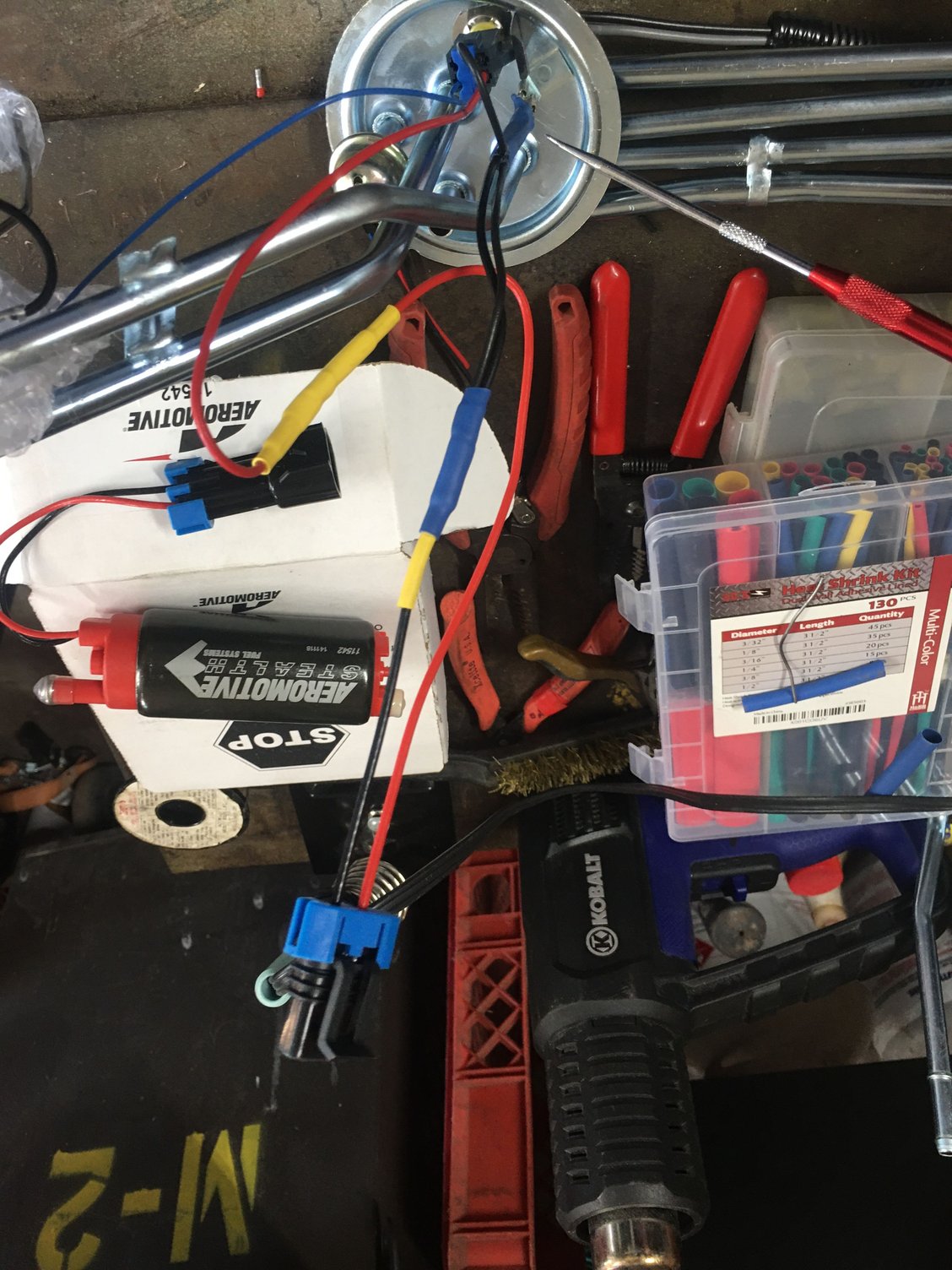

Okay so @Vader you got me intrigued again as have no desire to replace the fuel pump but kinda just think it's gonna be junk city. I need help on this then as yeah I'm hankering to get this motor started and was going to start reassembling the rest intake and injectors tomorrow but still working on de-carbonizing the plenum and runners then was planning to work on dropping the tank.
Just got back from O'Reilly with an arsenal of chemicals; Purple Power, Simple Green, CRC Parts Cleaner (spray can) and another jumbo Gumout can.
How would a guy run the pump independently then without using the ignition circuit? Connect the battery directly to the pump or relay connection and disconnect the line from the fuel filter and tap into that?
Appreciate a step by step for a guy as I'm willing to give it a go as I have two 5 gallon tanks that I still need to drop off the old fuel in them
