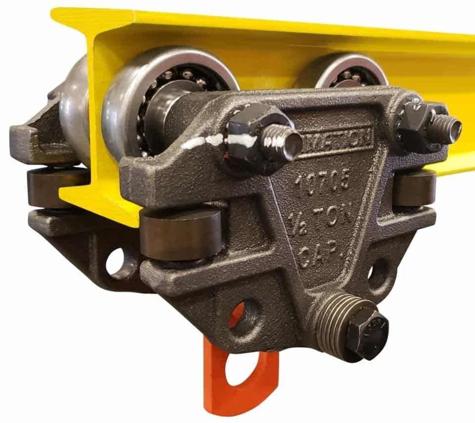

Any of you guys ever use something like this along with an electric hoist or some pulley system to make an engine puller? any words of wisdom to pass along?

I have always kinda wanted one of these in my shop but havent installed one because it needs to have some way to maneuver a bit to pull an engine. Every time I pull/install an engine I inevitably end up needing to reposition the hoist to get the right angle, fitting the engine to the right spot and mating to the transmission. These trolleys dont allow 360* maneuvering to do that so they would need some attachment to make that happen.

Do you need 360 degrees, or just a little twist here and there? I'm just not clear on what needs attached to it to create an engine hoist?

Had one of these in a welding shop. Was super useful. We mounted the I-beam on a huge hinge so we could pick stuff up, then swing it to other places.

We put together a frame and trolly for ours, so it would move forward/backward about 8 feet, and side to side about 2 feet. It was awesome for pulling engines, but, you HAD to remove the hood for access.

what was used as a pulley? I'm not sure how a pulley system works on these?

We had a chainfall. Not that exact unit, but, very similar.

Thanks for the link - so can one guy pull the weight of an engine with this by pulling on the chain?

Yes, the "control" chain works a series of gears/pullies to work the load side chain. If you look at that link it says there is a 53 lb pull to make it move with maximum weight on the load side. I think they have a worm and wheel so the load can never cause the control side chain to move

Thanks for the explanation, now all those specs gibberish make sense. pretty amazing a 53 lb pull can pull a ton. does the pull # get reduced for a lighter load?

Yes, you can spin that chain around pretty fast with no weight on the load side
