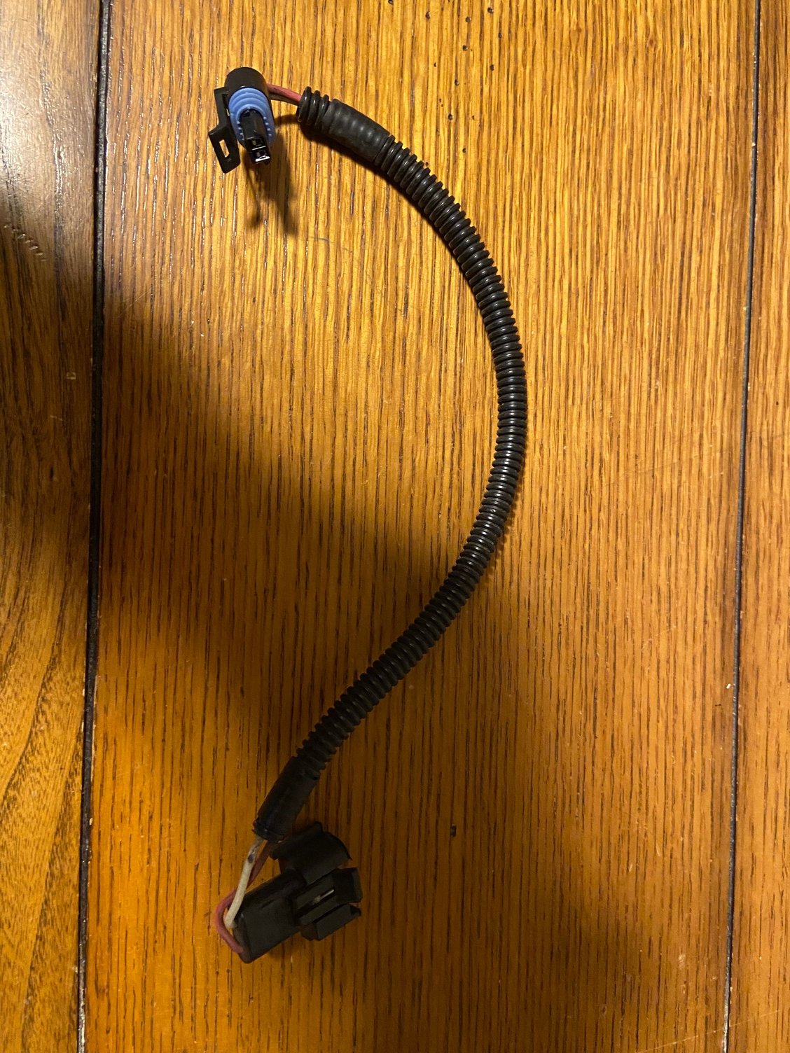

Anyone know where this plugs in?
I’ve been working on swapping out my intake since 6am and can’t for the life of me remember where the other end of the black connector for the coil plugs in...any description of where to find the connector would be greatly appreciated.
I am thinking it’s on the driver side but I can’t find it...

Re: Anyone know where this plugs in?
Icm to coil
Wow, time to stop for the day...in my haze I plugged the IAT plug in the icm, same plug style.
Thanks for saving me from wasting more time. I am taking a rest.
Exactly the same what happened to the mechanic of a good friend. The car sat about one year cause he couldn't find the issue why it didn't start after intake gasket replacement. It took me 5 minutes to find the issue. The coil cable was plugged to the IAT and the IAT was plugged into the ICM.
