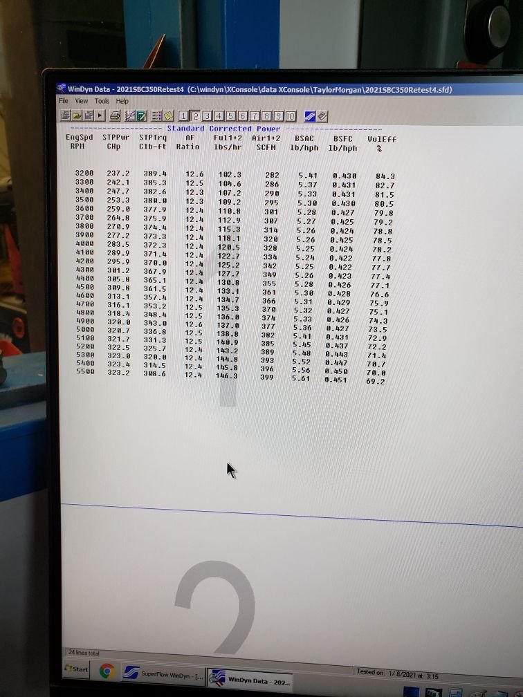

motor was broken in on the dyno. after much convincing the operator, he dialed it back 2* at a time from 32* and made the most power @ 26*. 191 heads pocket ported (no gasket matching, or port enlarging) small 214/217 @ 0.050" 112 LSA cam. quench is 0.034". 91 octane on the dyno. you should build the same engine on 8:1 and let me know how much of a turd it is, how much fuel it uses and how much it detonates.

My engine is a 350 (not a 355) and makes that much power at the tires at 8.5:1 with 34 degrees through a 700R. I drive it daily. My dyno graphs (from MY dyno at MY shop) are published on this forum. You are leaving a lot on the table with that high of compression and the mild cam.
Do you have the SCR and cranking compression for this engine?
Old Apr 5, 2021 | 11:10 AM
morgsie's Avatar
Joined: Feb 2008
Posts: 454
Re: 11:1 compression on 87 octane possible?
SCR is 10.3:1, haven't checked cranking pressure. motor was built for a truck, with towing in mind. i also need to keep it relatively stock appearing for insurance purposes (cheaper), so after market heads and induction are out. i used the "door stop" heads that everyone on the internet writes off as garbage. just to be different and prove that they're not total junk with a little work and the right application.it's not always about peak numbers.

325 at the crank on a 383 is not very spectacular. Any decent 383 build ought to be in the 400 HP neighborhood at the crankshaft. 350 at the tires is pretty much what we expect from a 383 with decent fuel and proper timing. I'm sure you are limited by heads and cam, but also - have you actually tried a slightly lower compression and more timing? It's excellent that you are happy with the engine but it's just a statistical sampling of one unit. I've had quite a few 350 and 383 engines on my dyno and 323 HP at the crankshaft would translate to about 260 at the tires with drivetrain losses. My 350 at 8.5:1 without the supercharger it was built for is running about 325 at the tires through an auto. That's about 390 at the crank with less displacement.
Again - static compression DOES NOT make power (in this range). Airflow makes power. I stand by the graph above and the dyno results I've experienced.
