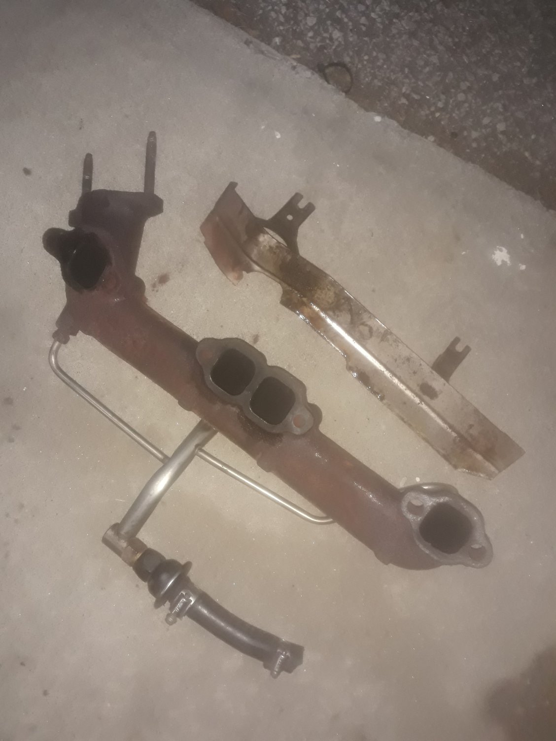

Those nuts really didn't want to come off, but I managed to remove not only the manifold but the head as well.
