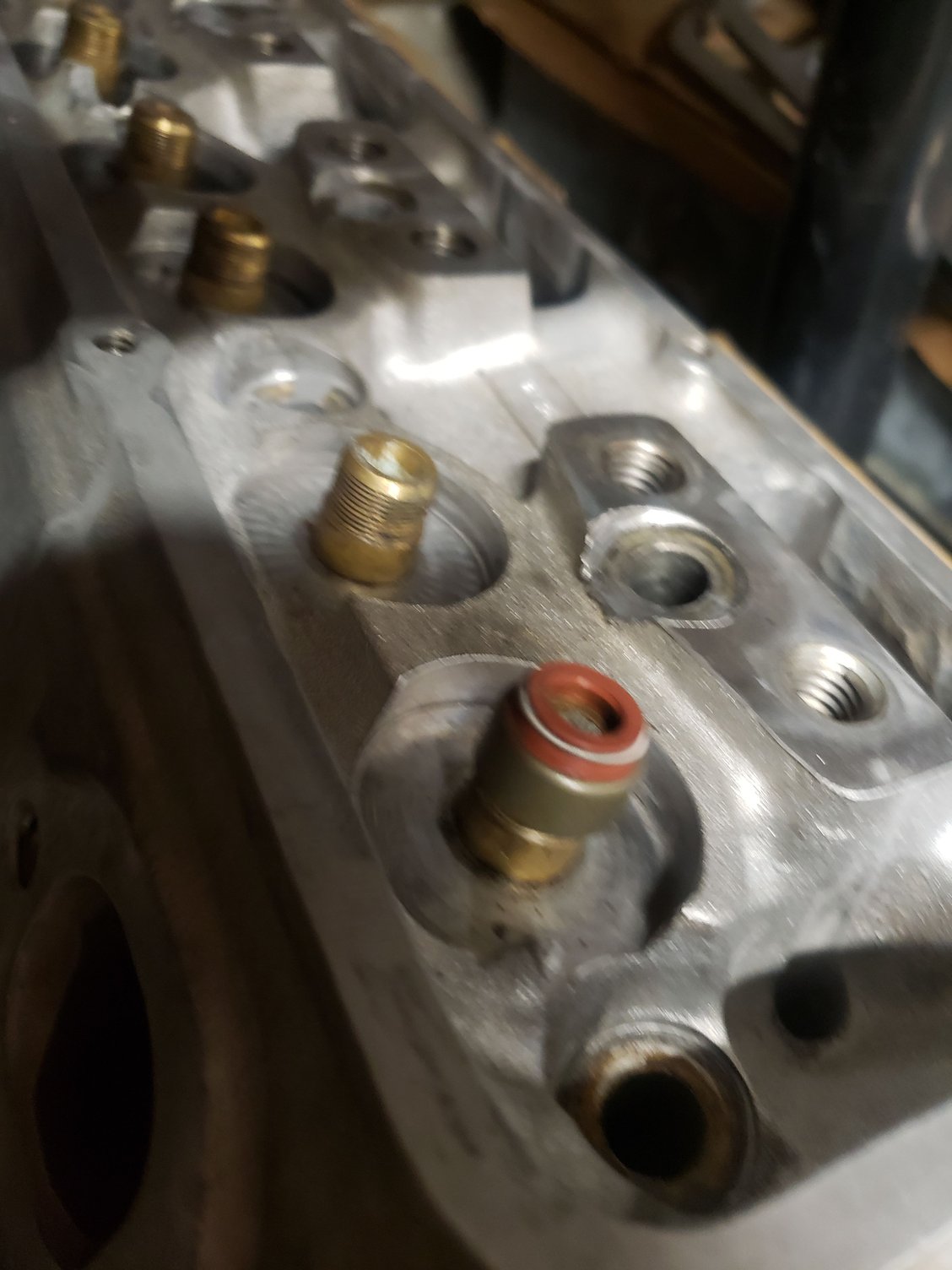

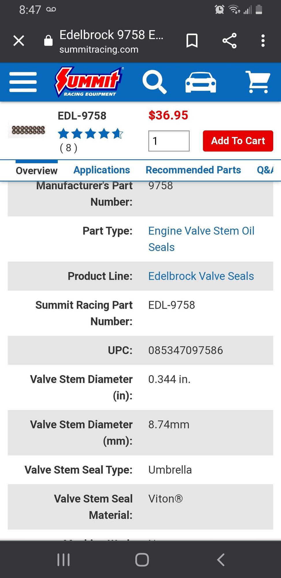

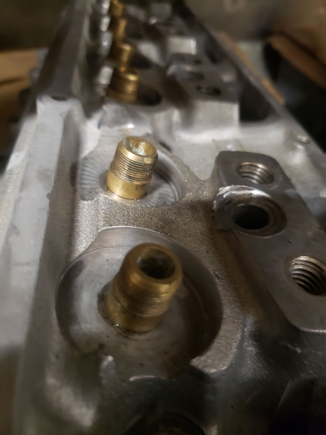

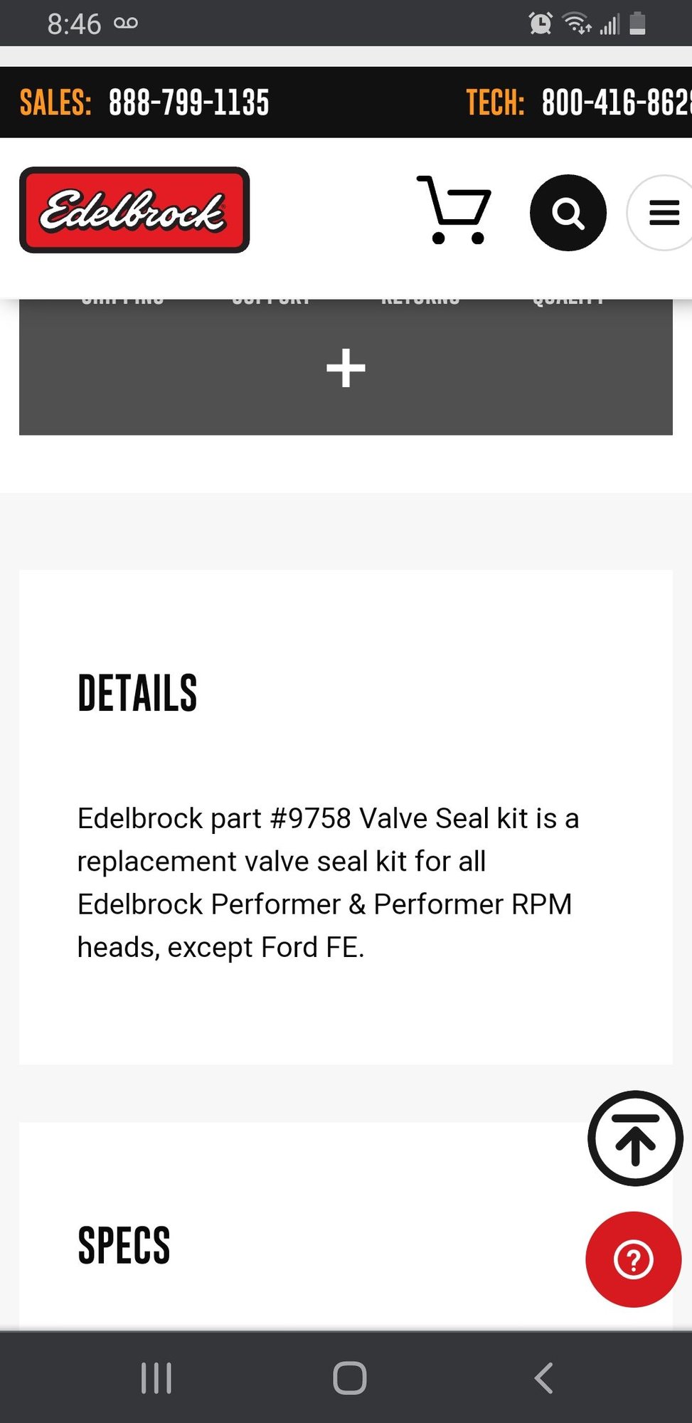

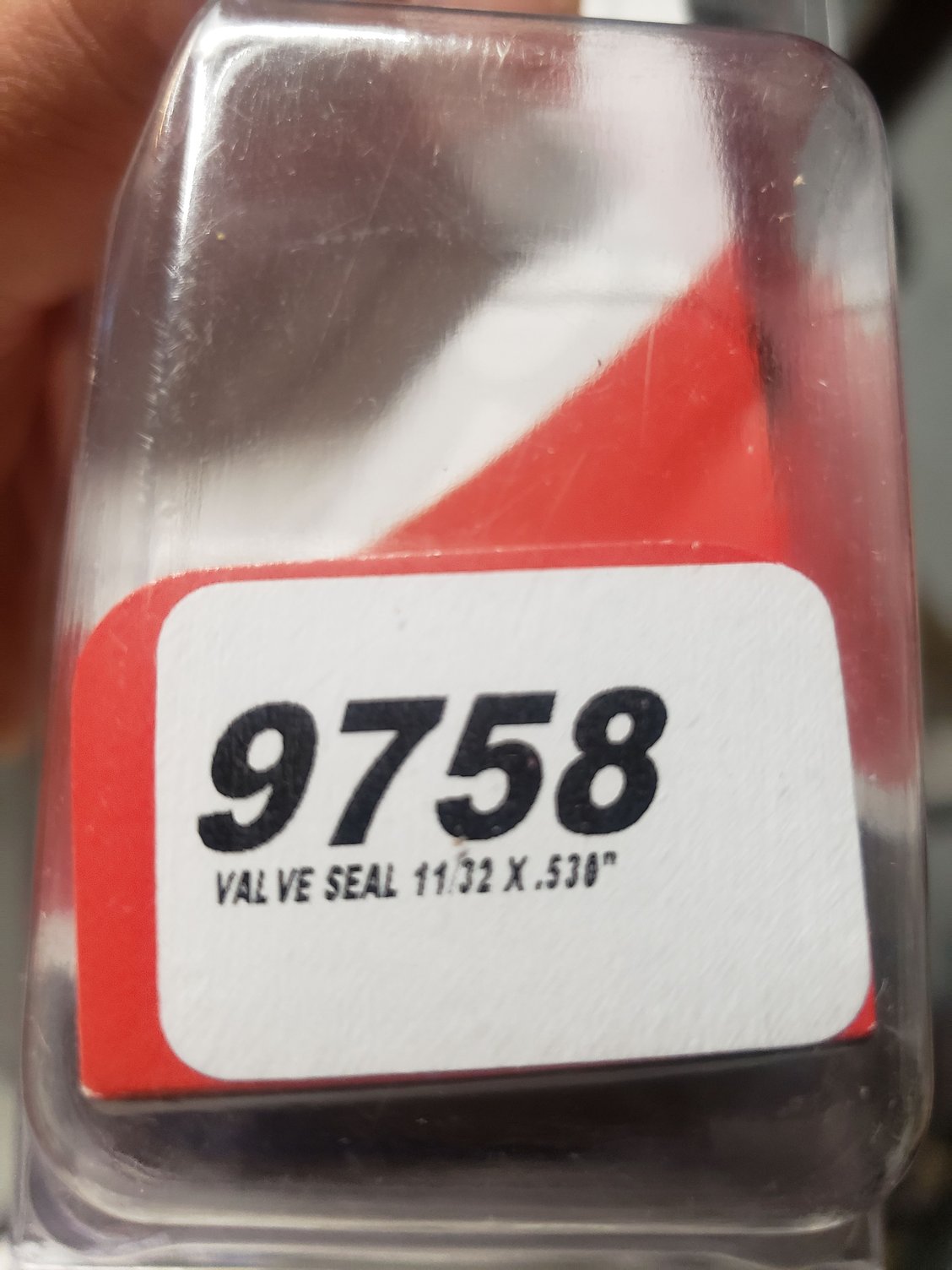

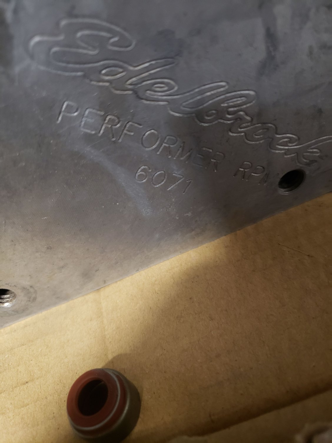

So after trying some different valve seals on a old set of edelbrock rpm 6071 heads I cannot find which valve seals to use. I am pretty sure it requires some kind of ribbon style valve seal and after doing some research found part number edl9758 as the number. So I ordered a set from summit as edelbrocks site said out of stock about a month later finally got them and they are just a regular set of umbrella style valve seals same as the felpro ones I tried before. Anyone know what would fit the valve guide outside diameter is .5290in inside diameter .3425 inch and valve stem is .3415

Wow can't believe my local auto parts store was able to get the last pack of those by end of the day. I had to wait 7 weeks for the wrong edelbrock part number ones from summit. I installed 1 of them lightly tapped it down with a socket they look like a good fit. Thanks alot
