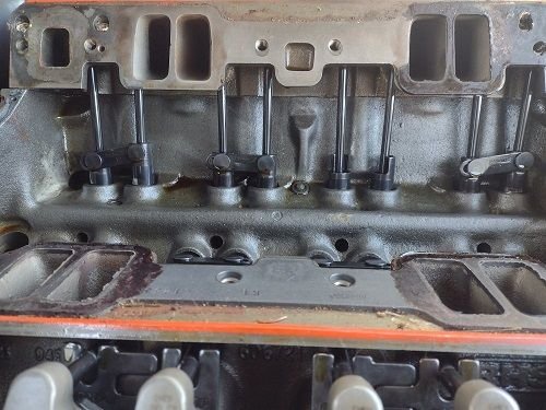

I'd say I'm in the replacement camp.
Sometimes there's very little evidence that something is going sideways.
Not the OEM variety but rather a very expensive set of COMPs short travel lifters.
Despite the destruction, the engine ran surprisingly well. I'd be truly choked if I re-installed these in a fresh short block only to fill it full of metal. The cam lobe is equally FUBARed.
EDIT: From a quality standpoint, these lifters are about 20 years old. At that time my understanding was that were entirely manufactured in the U.S. Now that COMP has been sold off, the operations have become "global". Now you don't what the hell you're getting.
I'll probably source my replacement parts from Jones Cams. Mike Jones says that they only sell American made parts. So I'm in.
