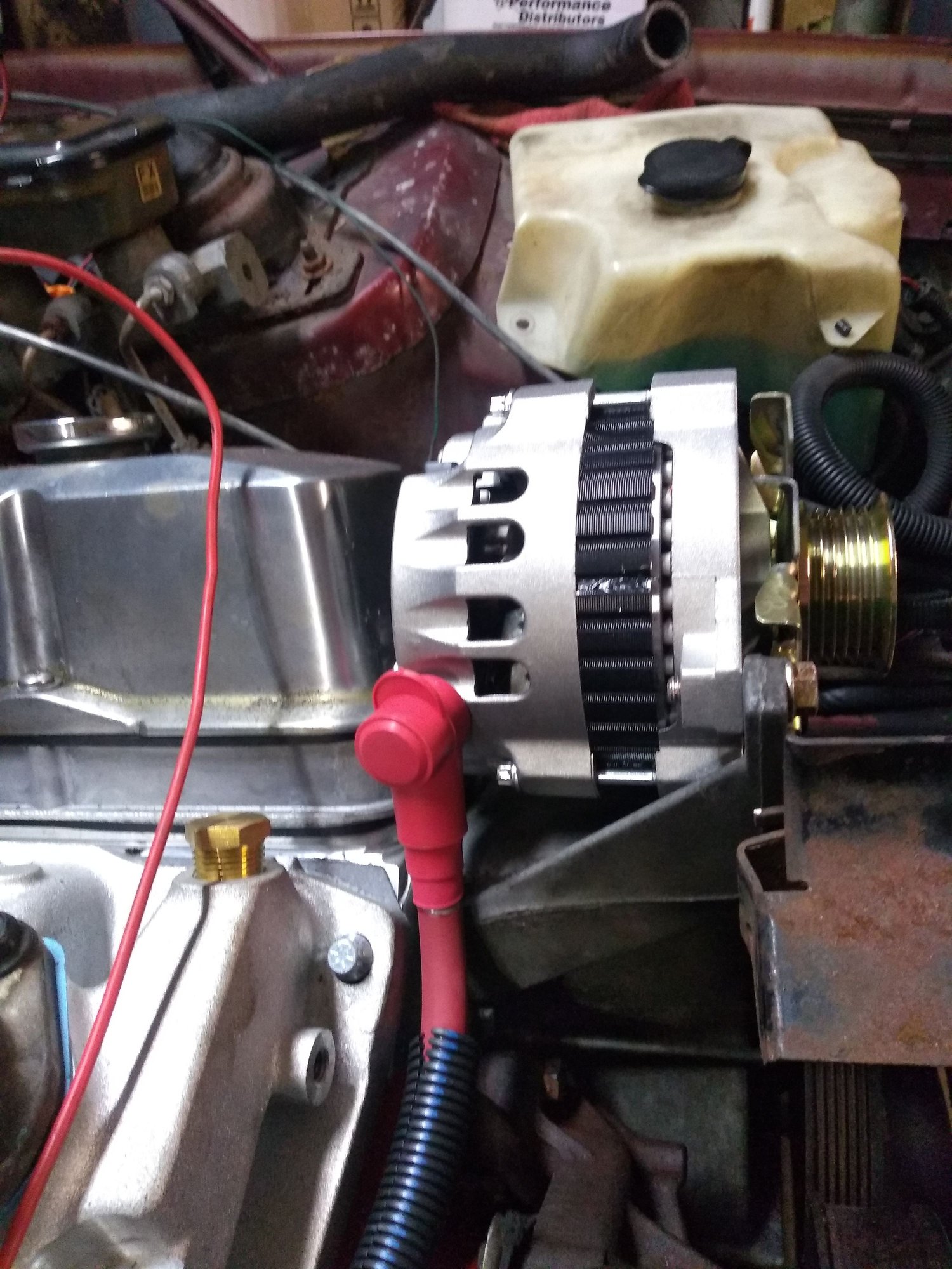

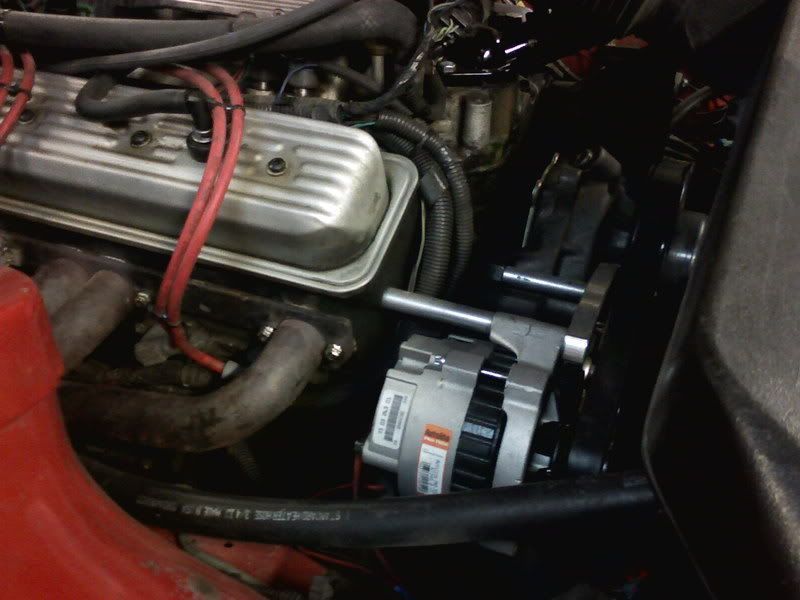

I finally got it figured out. I went with the power master 47461. It has the side mount. The alternator body still touches the valve cover, but just barely. The last 2 pics are the old alternator.
Just barely touching valve cover.
Side mount.
y. Thanks everyone for your suggestions.
