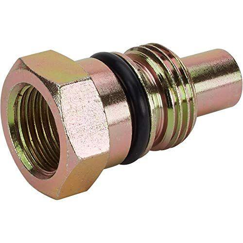

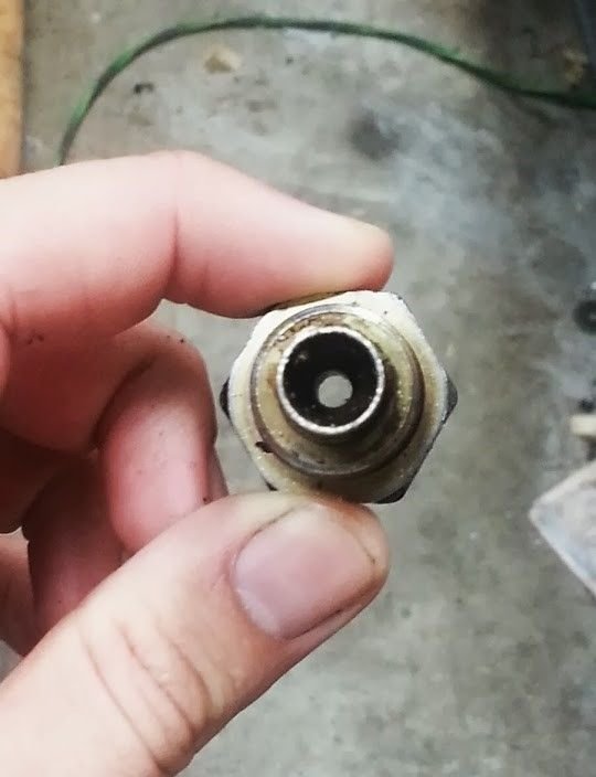

Generally this occurs after the Pump has worn enough that the Pressure produced is too low at Engine Idle.
However there are other possibilities...
Metal-Debris can create a restriction or clog.
If the Pump has just been installed, and has always performed this way...
The Flow Control Fitting may have an Orifice that is smaller than the previous Pump used.
The Image below shows the Flow Control Fitting:
The Image below is of the back of the Pump.
The Outside of the Flow Control Fitting is seen with the letter "A" marked next to it:
The next Image below shows the Orifice that is in the center of the Flow Control Fitting:
Warning, when removing the Flow Control Fitting, the Pressure Regulator Piston and Spring can fly out of the Bore.
Shown below:
The Hyper-Link below contains a basic Article that goes over this information...
If you would like to have a greater understanding of how things work, feel free to ask:
LINK
