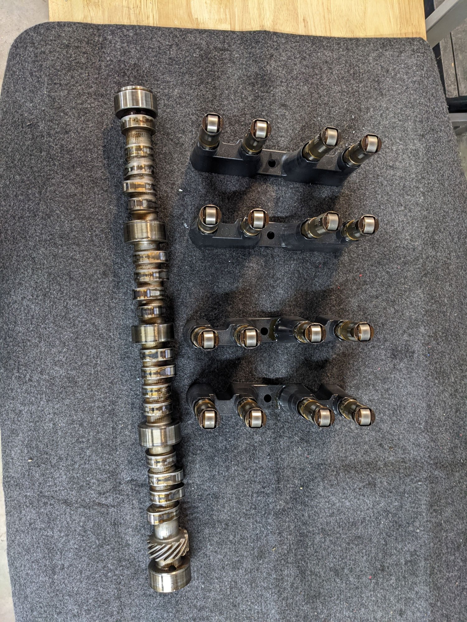

I've got an L98 Cam and lifters for sale for $75 if you're interested.
