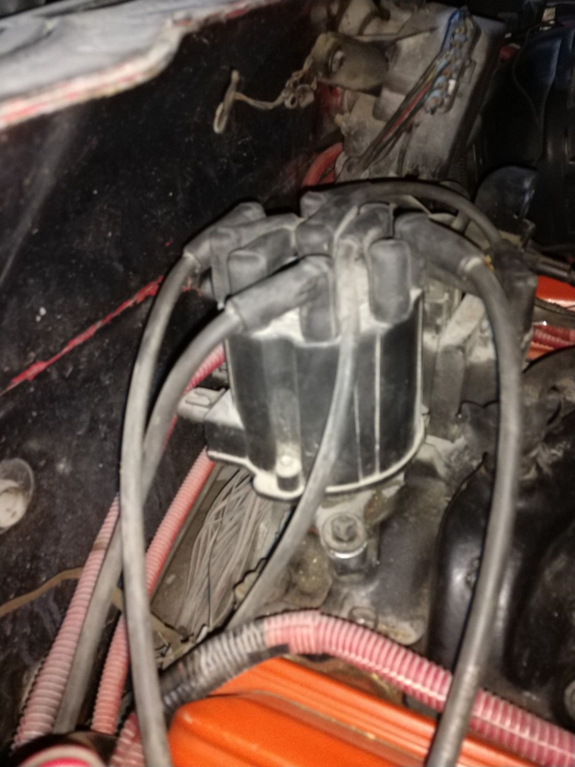

I just want to remove my tbi electronic distributor and install a HEI distributor, but I don't know how to wire it up

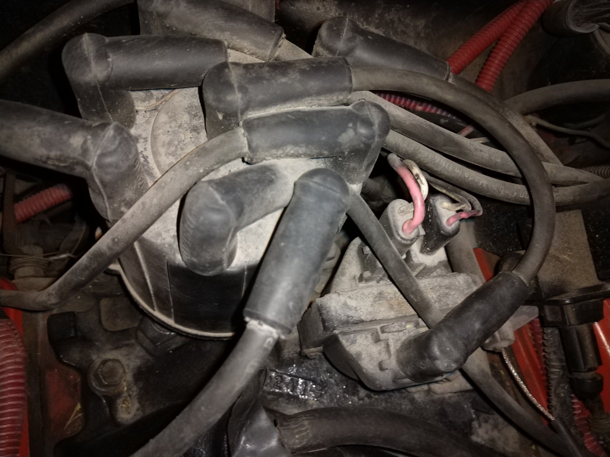

Just like replacing any other distributor, can google search. The wiring from body side pink and white wire get hooked up to the side of the new distributor. Pink b+ and white is tach.

Hello, I am new to the forum, I would like to know what the function of the TACH is in an HEI distributor, since I have been told that it is not required to connect it for it to work and I wanted to know if what they tell me is true

Tach is short for tachometer
