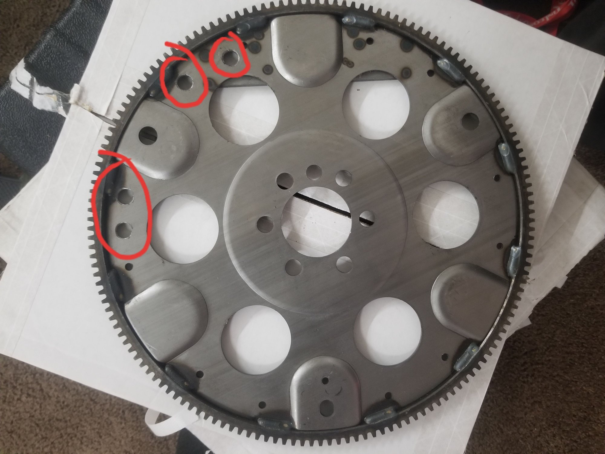

Ok, I need you guy's input/advice. I have a 92 z28 5.7 tpi. The pinion gear on the starter became loose and damage the original flexplate. I just received a new flexplate from hawksmotorsport, I already made plans to install it this weekend. But, as you can see in the pictures someone obviously drilled 4 holes and returned it. Is it save to use? Can I weld up the drilled holes and smooth up the weld surface? Thanks.

Those look like balancing holes to me. Years ago they would have been deburred but as with most aftermarket parts today quality control isn't what it used to be.

I wouldn't trust that. That flexplate needs to be balanced otherwise you'll get vibrations. And with how difficult it is to remove a transmission move a transmission I would just go and get a new one from GM.
The new ones from the factory come already balanced. There's no reason to be drilling extra holes in the flex plate.

I wouldn't use it. I'd return that and get a GM one.

I wouldn't risk it, go to your local parts store and pick up a flexplate. Pioneer FRA160 should be the part number, last time I check o'reilly's and autozone stocks them.

Thanks fellas, I'll return it and get a new one.

I bought the one you recommended, autozone had it the next morning. Installed it and it worked perfectly, I mean direct fit and no vibration or unusual noise.thanks for the help!
